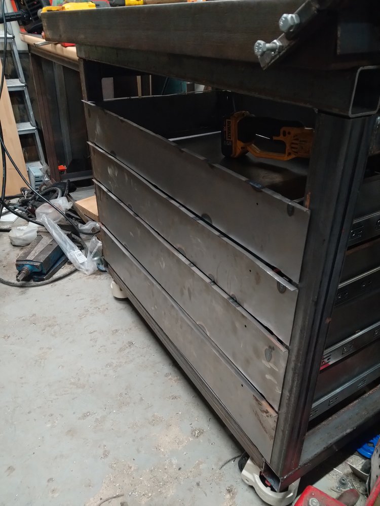

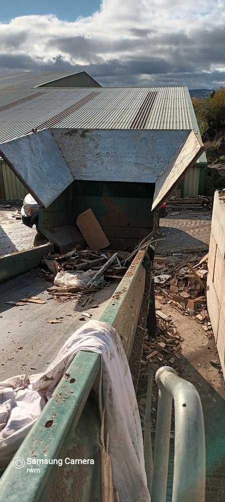

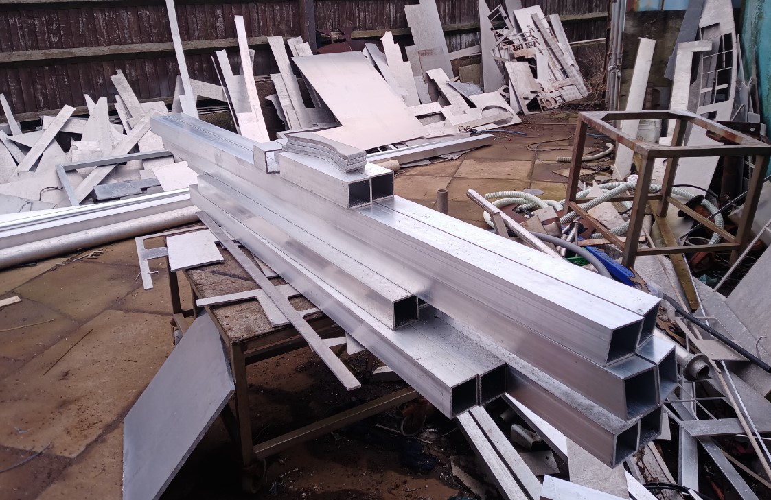

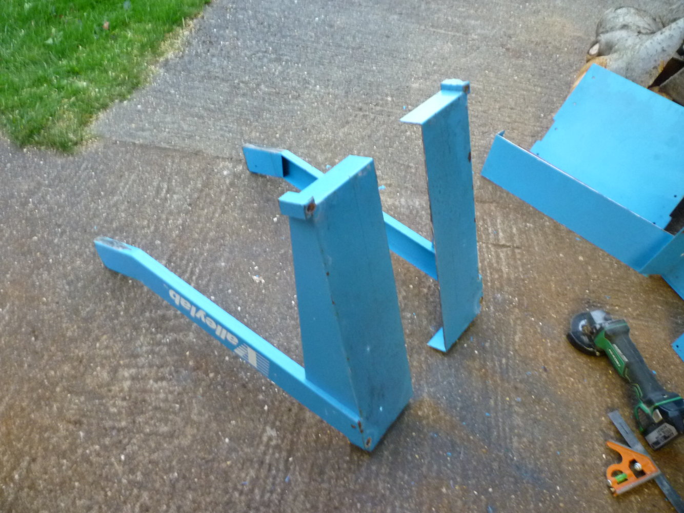

So you cut the double mitre in one go?Got the box section for the hopper chopped up, also the 12mm plate for the stiffeners at the top.
Most of the box is just straight cut at the ends but the 4 gantry ones have angles at either end and are diagonal, so basically 12 degrees at one end and 6 degrees at the other. Made up a simple jig (just a piece of 12mm cut at 45 degrees) so that I could position the box diagonally in the vice which made life easy.
Yes, I had designed it so the 4 legs were spaced the same distance apart so that meant the angle was 12 degrees back and also inwards which made cutting it possible in one hitSo you cut the double mitre in one go?

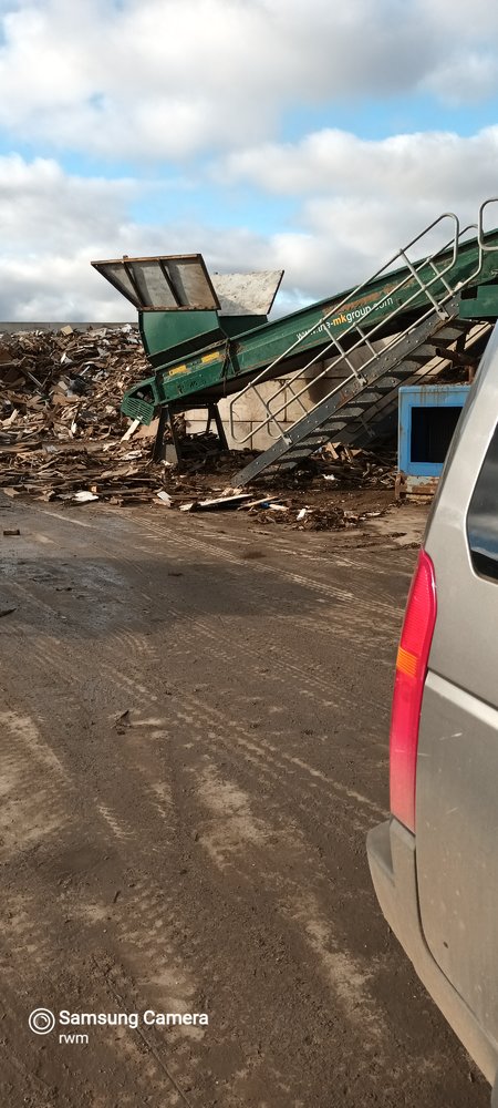

I'm not sure your yard is cluttered enough. I don't suppose any of it's stainless, and jiffy bag sized?Got the box section for the hopper chopped up, also the 12mm plate for the stiffeners at the top.

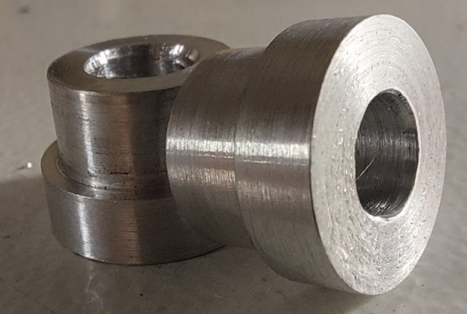

Definitely nothing like that I am afraid. Don't do much stainless stuff nowadays and what I do is usually 3mm or under.Ahh fair enough, 1.5mm won't do it, I need about 6mm or thicker to cut some 60mm ish rings out of.
