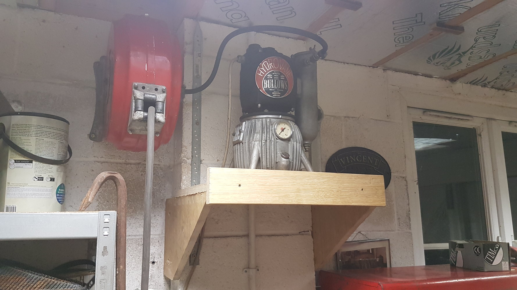

DON'T LEAVE THAT CROWBAR HANGING LIKE THAT !!!!!!! .
Ouch!famous last words , till it lands blade down on some ones toes. As happened to me many years ago when some one left a crowbar hanging on the header plate of some studwork !

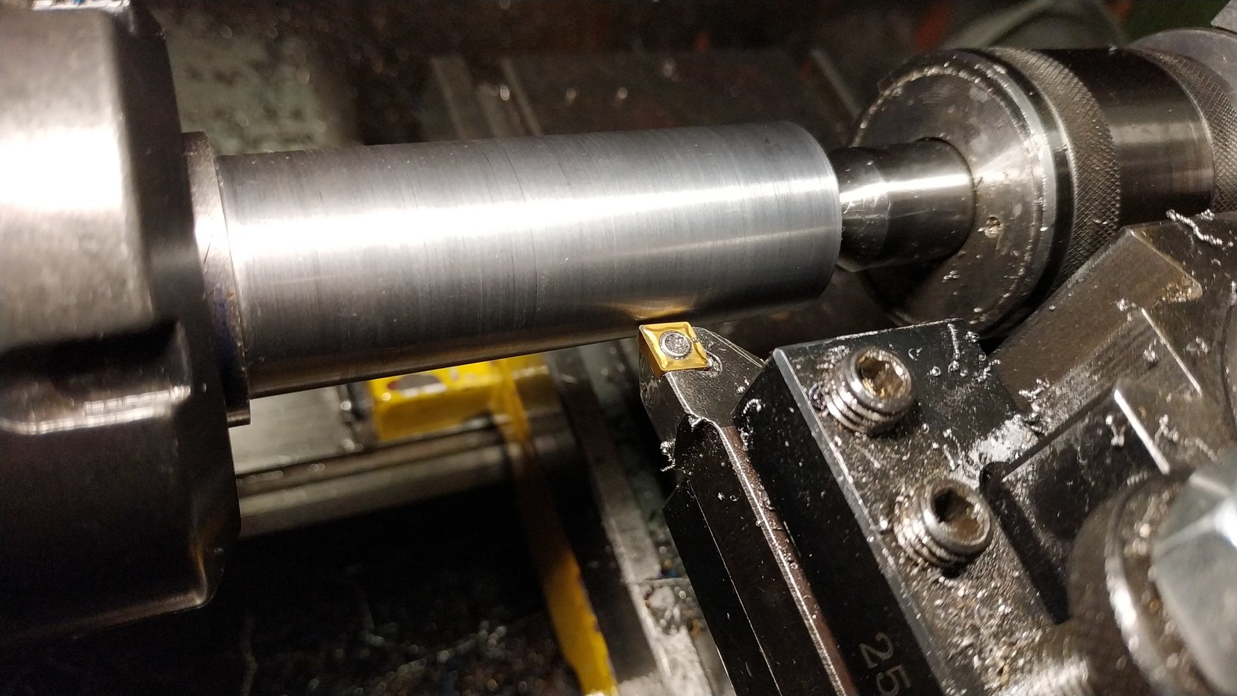

Thanks to @Lewis_RX8 and his lathe thread I have been converted to powerfeeding, only had my lathe 6 years! I set it at 0.092mm/R, the lowest my gears will go. It wasnt anywhere near a mirror finish but probably the smoothest and most consistent I have done on en3b mild. It looks rough but cant feel it.
1mm DoC and 700 rpm. Followed by a 0.05mm dia. pass to get on size. More testing needed..

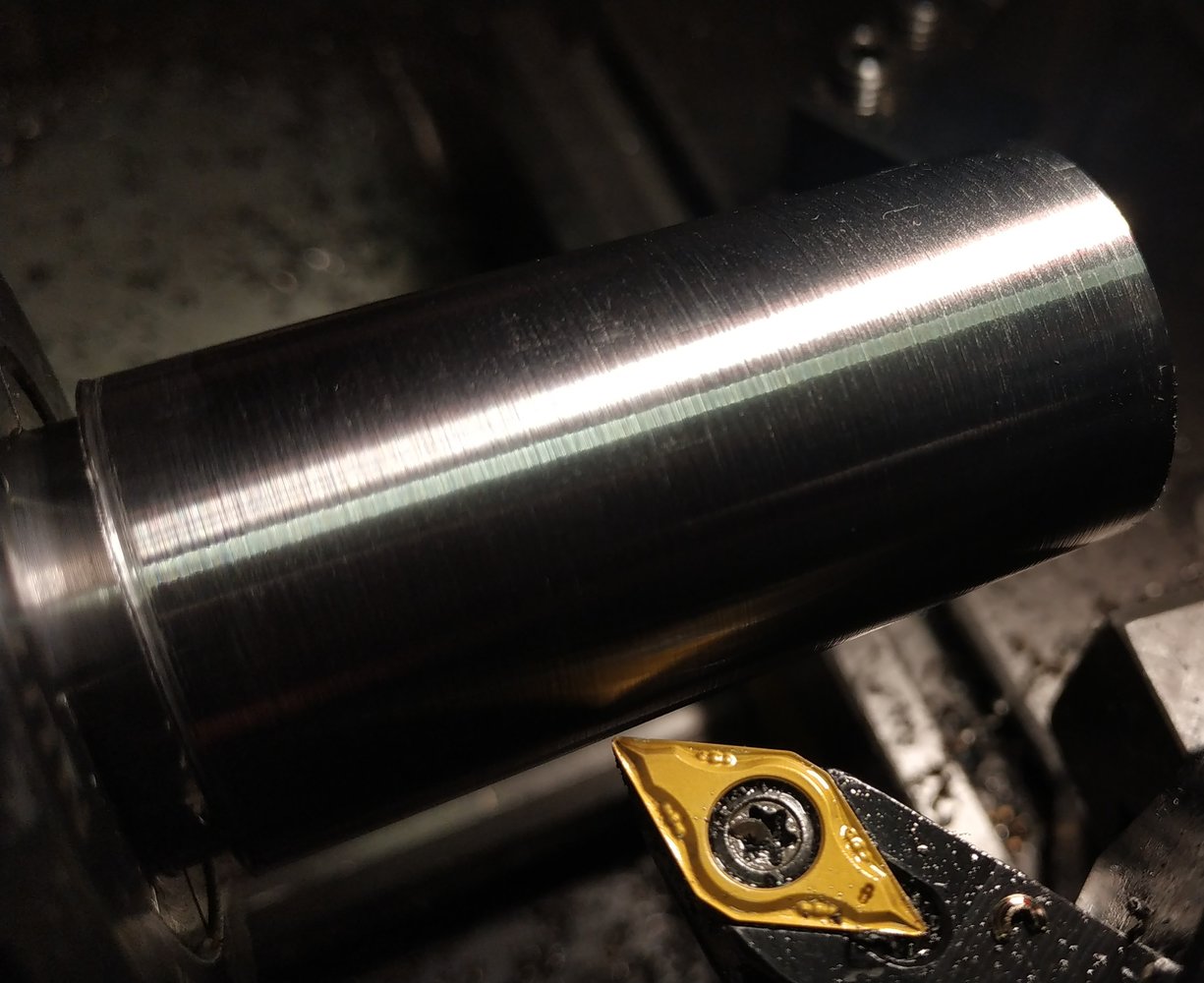

I know these inserts dont like bigger DoC so swapped a Pramet dcmt. All my packets show 0.1mm/r feed as the minimum so swapped the gears to that. This test was 0.8mm DoC/1.6 dia. Mirror but rougher than the moon. A few more passes and got the roughness down.
Some deflection without the center so needed another very light cut, this is the result before parting.

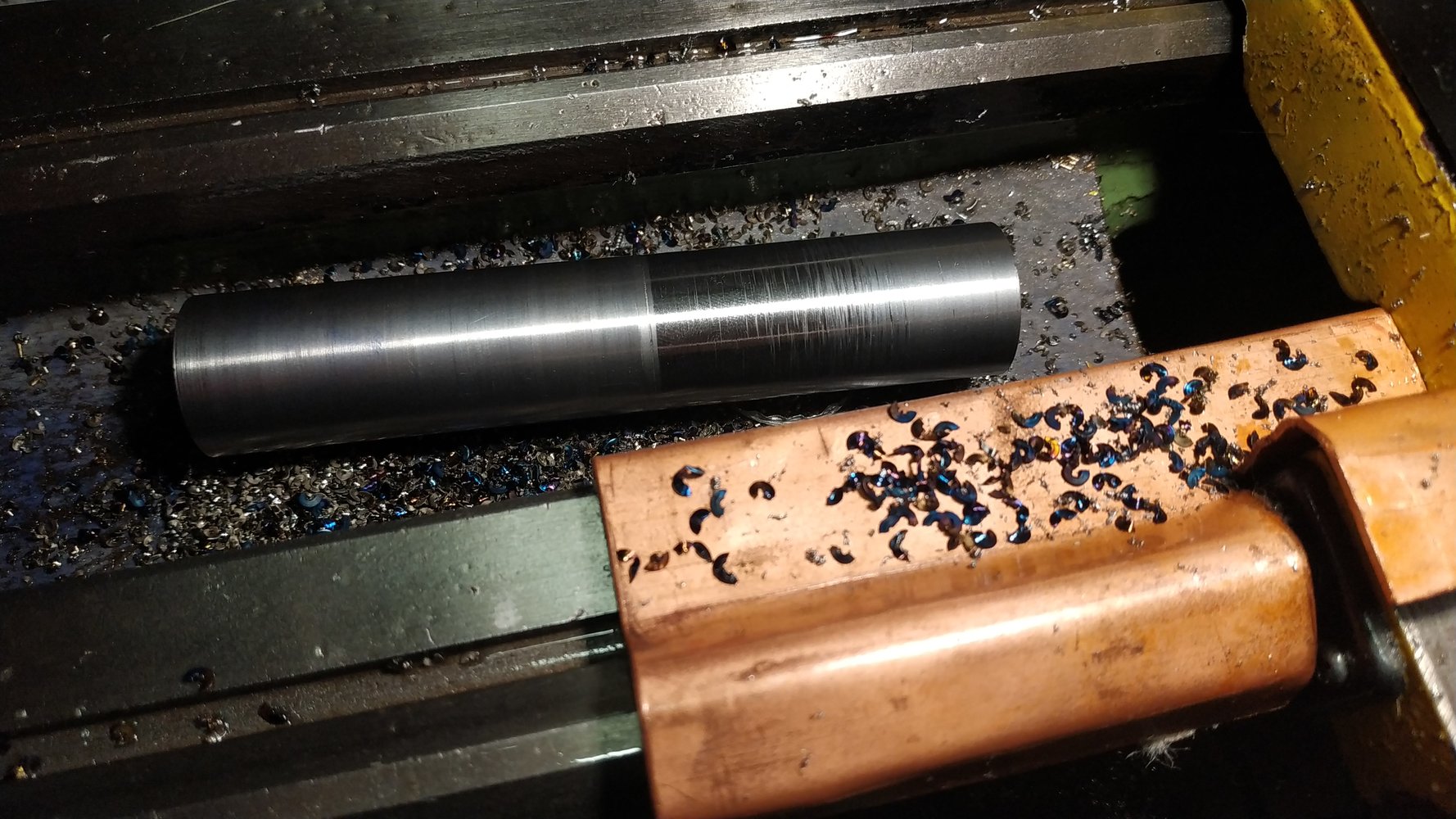

The problem with these deeper cuts is you hit your final size well before you finish testing!
Too lazy to swap belt for high speed but I think it will be much better at 2200 rpm, but thats still well below half the rated SFM for most inserts on 25mm bar
