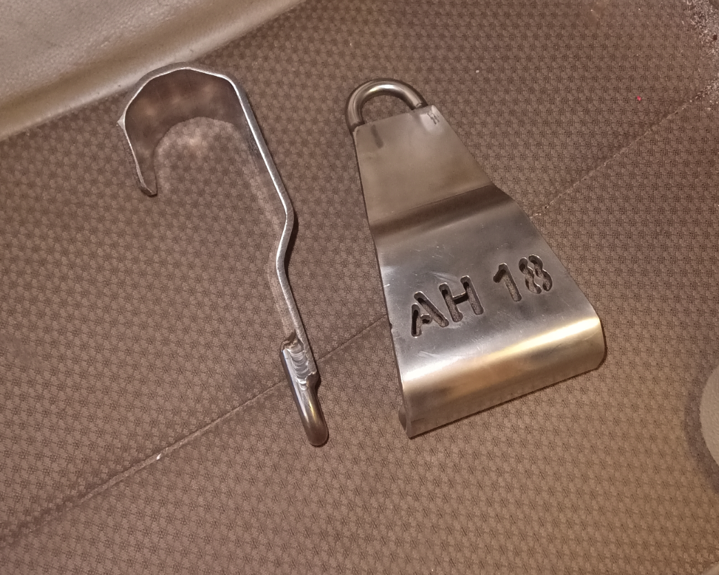

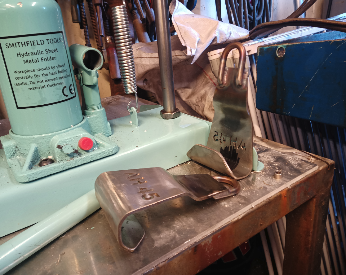

You got your money's worth out of that wire wheel!First I made a top from some 5mm aluminium and bolted it to the top of an old stainless frame I had so that I had a place for the, newly acquired, mini press brake.
I then adapted the quick and dirty rod bender I made years ago for a specific job so that I could make a U loop in some 8mm stainless. The adaption was to put a socket over the bolt so that I got the correct radius
Worked well, really should make up a better one some day.
I then bent some 60mm x 5mm 316 stainless in the new press and welded the loops to them.

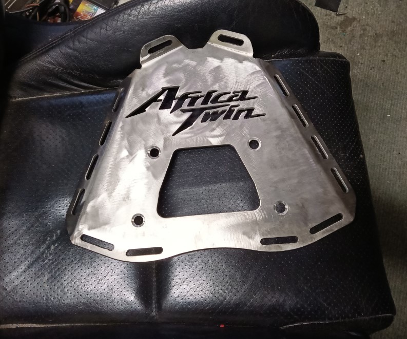

Next up I went to cut a rack on the plasma but the bleeding gaskets went in the compressor again so I had to make some more. Found some carboard and cut them out.

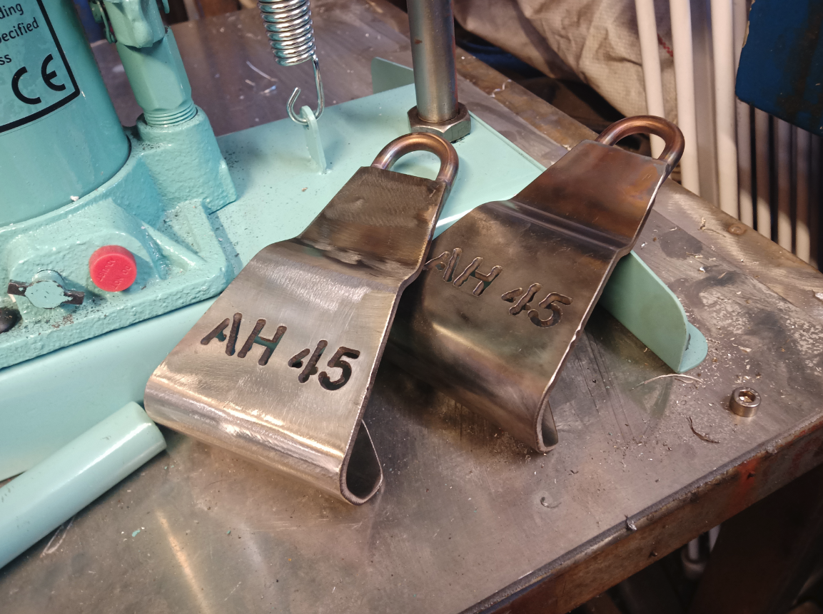

Compressor now running again so I was able to cut the rack, this time I cut with a higher current and it cut better, even leaving the centre of the small 'a' unlike previous attempts. I then tried to bend the tabs but that didn't go great, the bend happened at the slots rather than further in, I was kind of expecting it but....
Not sure how to overcome the problem, possibly having a backing bit of metal to support as the fold is done would be the way but I am not sure if the brake will be good enough as it is only supposed to do 4mm aluminium at that length, we will see.

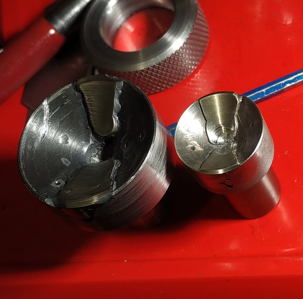

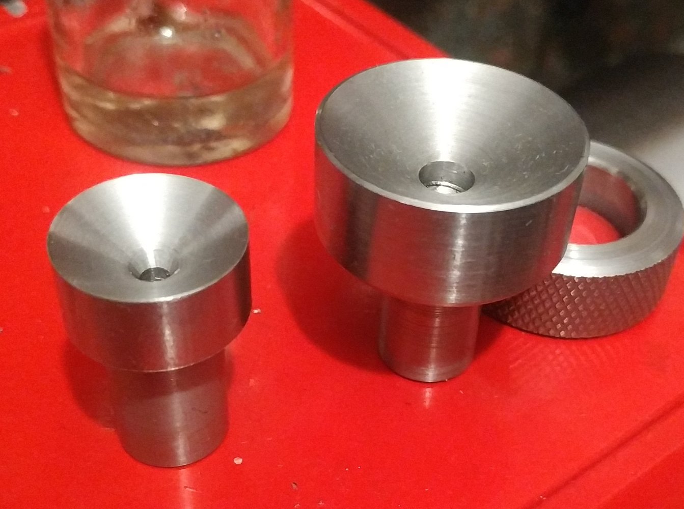

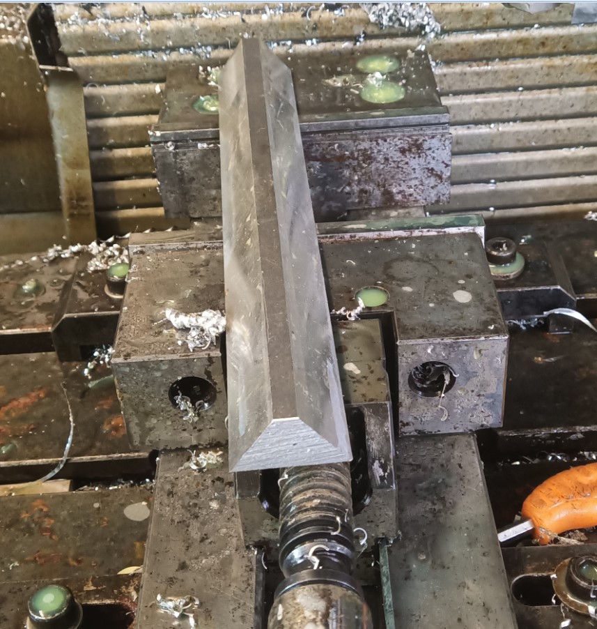

Yep that was my concern. Sorting a quick method of gripping the short lengths quickly and securely is my next task.A pair of external thread chamfer bits, @ukracer I wont have any use for the big one so its yours if you want it, when its finished, it should do 8-27mm.

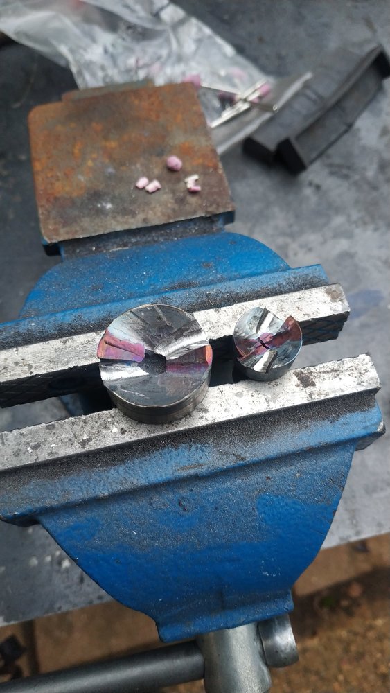

Cut a slot and used a few scrap drill bits, rough ground, then turned the HSS back almost to the surrounding taper. Lathe did not like the intermittent cut but carbide had no problem. I dont know how hard it compares with new HSS but files/centrepunch dont cut it,
The two anodised fillers had masking tape and it has survived without any UV fading that I can see, I ordered a bottle of indigo blue for the next alu bits.
Then some grinding, mostly with a 20mm diamond multitool wheel in die grinder with the er11 chuck.
I will turn a sleeve to shrink over the bits, for a bit of user protection. The cutting edge is far too sharp to leave exposed. You would not want to be hand holding short bolts anywhere near these as they are.

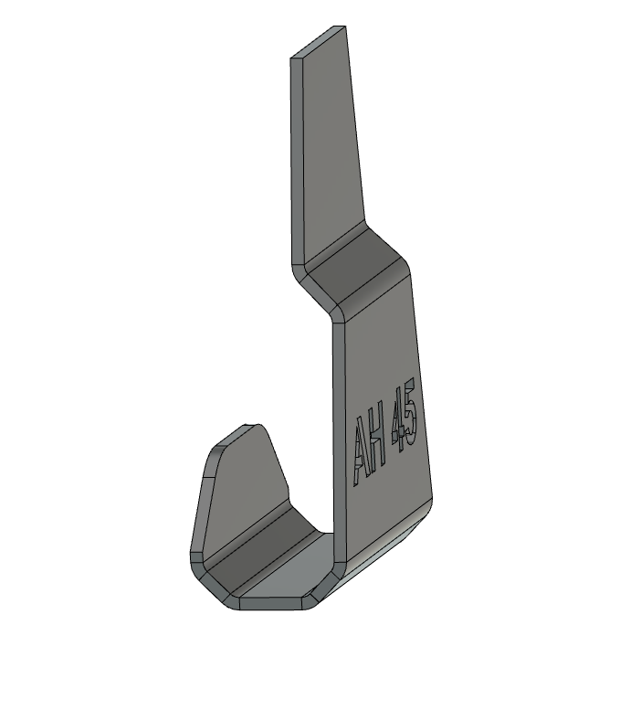

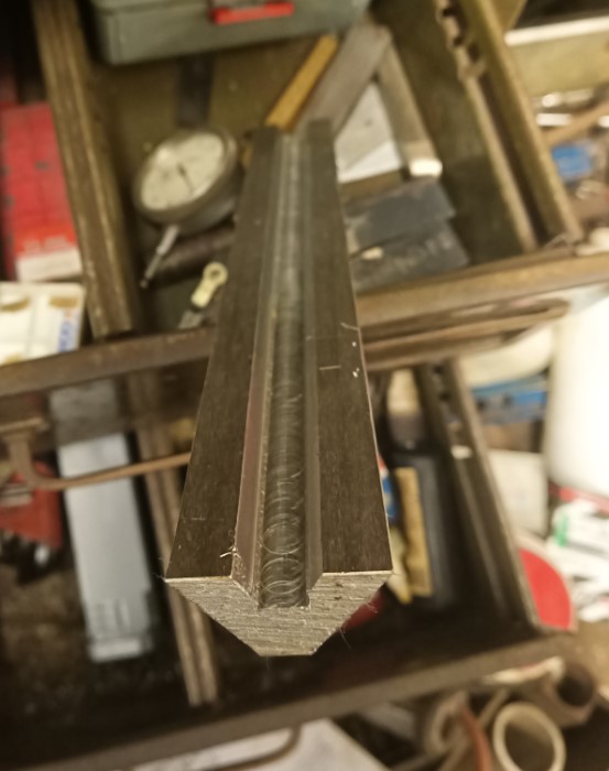

Another job done on it, need to get into the swing of measuring the bends but did not too bad for a first go of making this.What's it seem like, quality wise? Decent bit of kit?
Aye, had thought of that but I kind of wanted the angular look on these. Will likely make up a few formers for other stuff though.for radiused bends, you'd be quicker making up a new plate with a round bar welded on so basically a round end blade, then you could do it in more or less one hit.... might have to make a few to suit your required radius... I made one for a daft one off job for my home made one (photos on here somewhere), just welded it quick as mine is a fixed blade, did the job and ground it off when I was done. Yours looks better and more flexible, and I would like to take the time to make up multple blades like yours, probably will when I need it, but for now works ok,
Er32 or 40 is a good way for small bits. Doesnt need to be that secure, as the small clearance will prevent it taking a deep chip or grabbing, just needs to get the fingers out of the way.Yep that was my concern. Sorting a quick method of gripping the short lengths quickly and securely is my next task.
