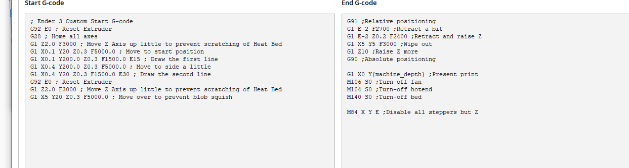

Loads of code cut out. But the start might show something to an expert with a trained eye.
Full Gcode available on request![smile :) :)](/forum/styles/smilies/smile.gif)
