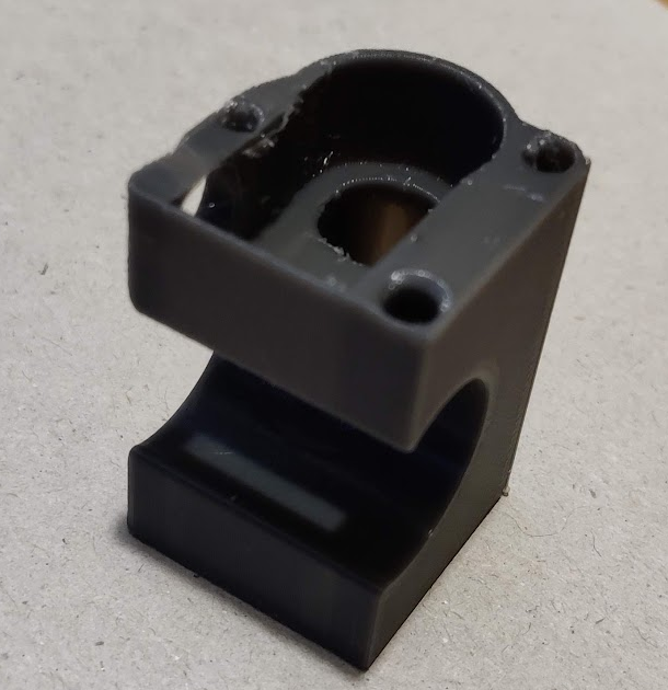

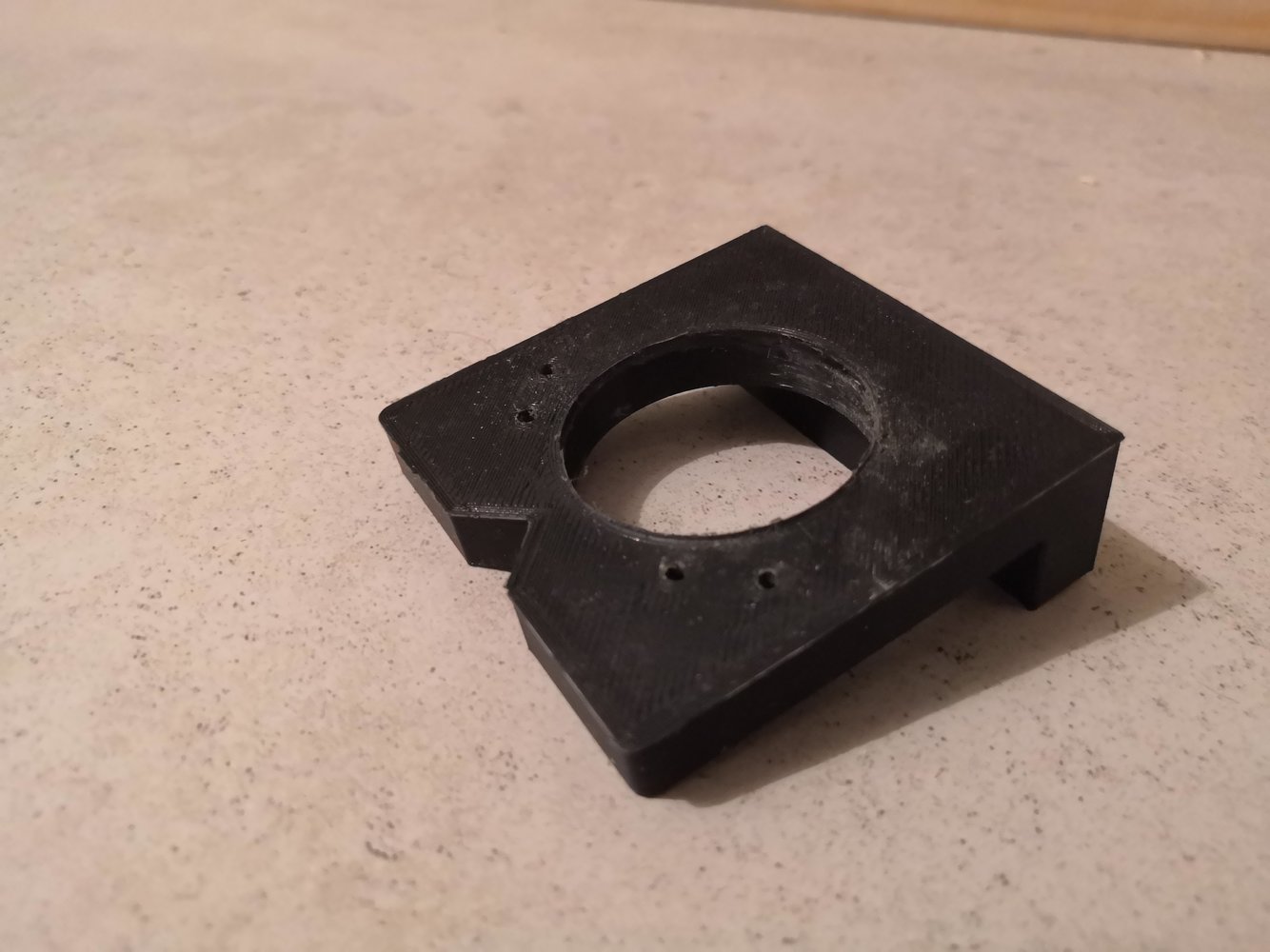

Very nice. I had been thinking a pcb smd resistor/trace network with a sprung button slider but thats as far as I got.These:

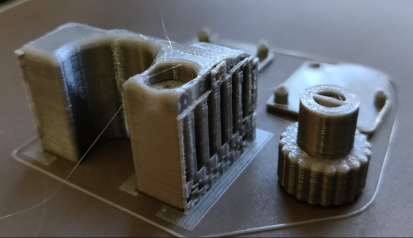

Took a fair bit of time to remove those supports but they all came off eventually:

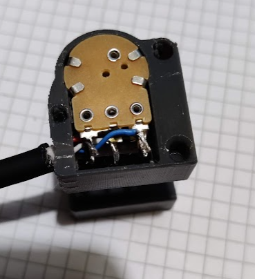

Getting this 5-pin switched potentiometer in and soldered to the wire was "fun":
I'll probably do a version 2 with better strain relief and the ability to drop the wire in straight, but it's good enough to test the principle.

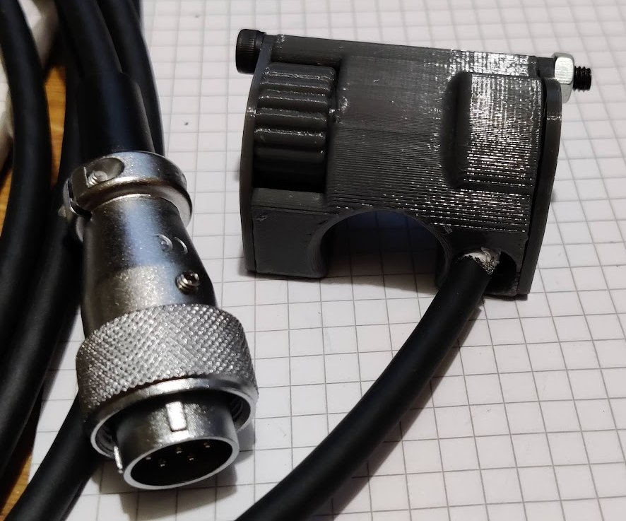

All assembled: I'm not sure the screw is necessary really as the end caps are friction fit, but I thought it couldn't hurt. I need to shorten the screw slightly when I can be bothered.
It's amazing how obvious the extrusion lines are in that photo - they're much less obvious in real life.

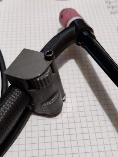

In case you haven't worked it out yet, it goes here...
... and should give finger-tip control of the welding current. The switched potentiometer will start the arc when you turn the wheely thing towards you, then the current should get higher and higher the further towards you it rolls.
I'll test it tomorrow or Saturday and if it works I'll probably print version 2 with a better way of retaining the cable.
