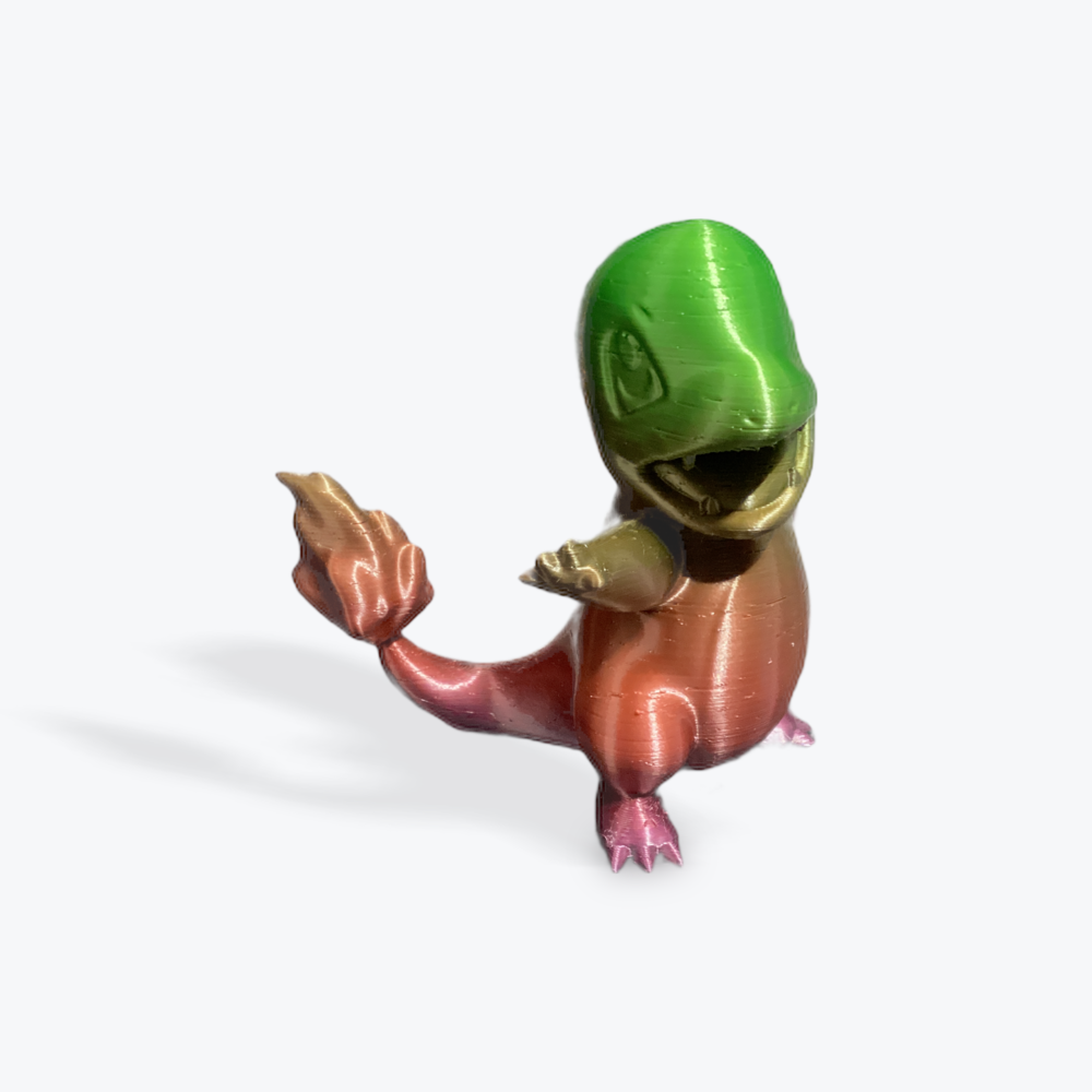

looks like one of the first 3 of these: https://www.printables.com/search/all?q=charmanderGot the link mate??

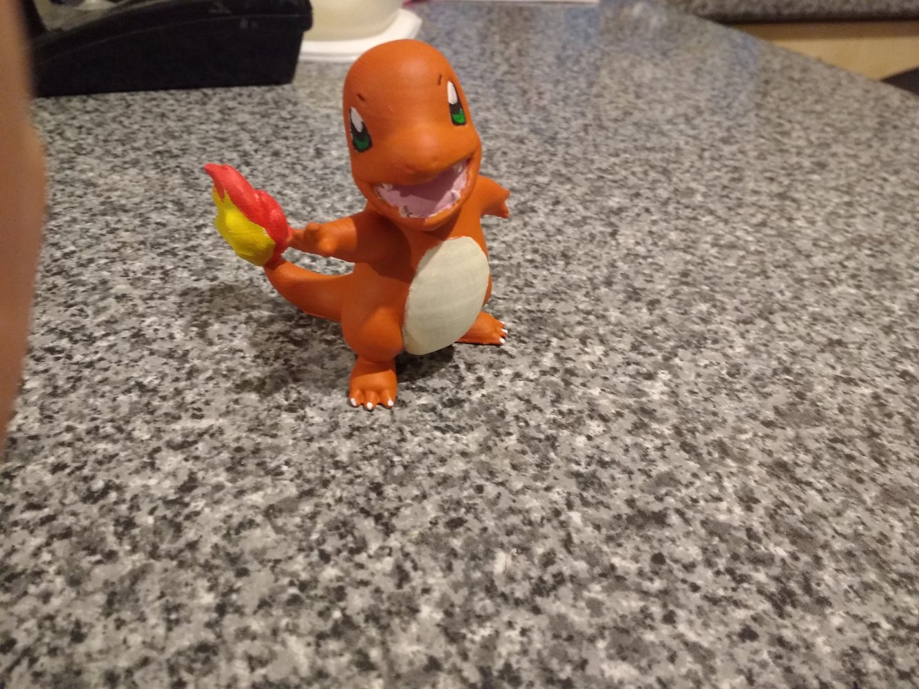

The flaming tip, on the end of the tail is very fragile and broke off. I had to repair with a bit of 1.6mm stainless wire I filed barbs into and heated up, then used as a pin. Heated it up and pushed in at the join.

Was that done with a few coloured reels of fibre silk type PLA, pausing & changing reels?
A few hairy bits close up I see, the one the lad did was really smooth but a bit messy where the supports were. I sprayed with plastic primer then primer filler before my daughter started on it with acrylic paints.

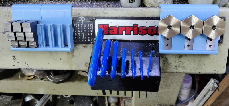

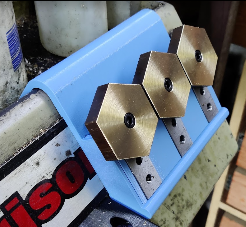

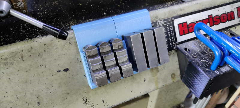

The former hangs on the front of my lathe and gives me somewhere to store the two sets of chuck jaws that aren't in the chuck at any point:

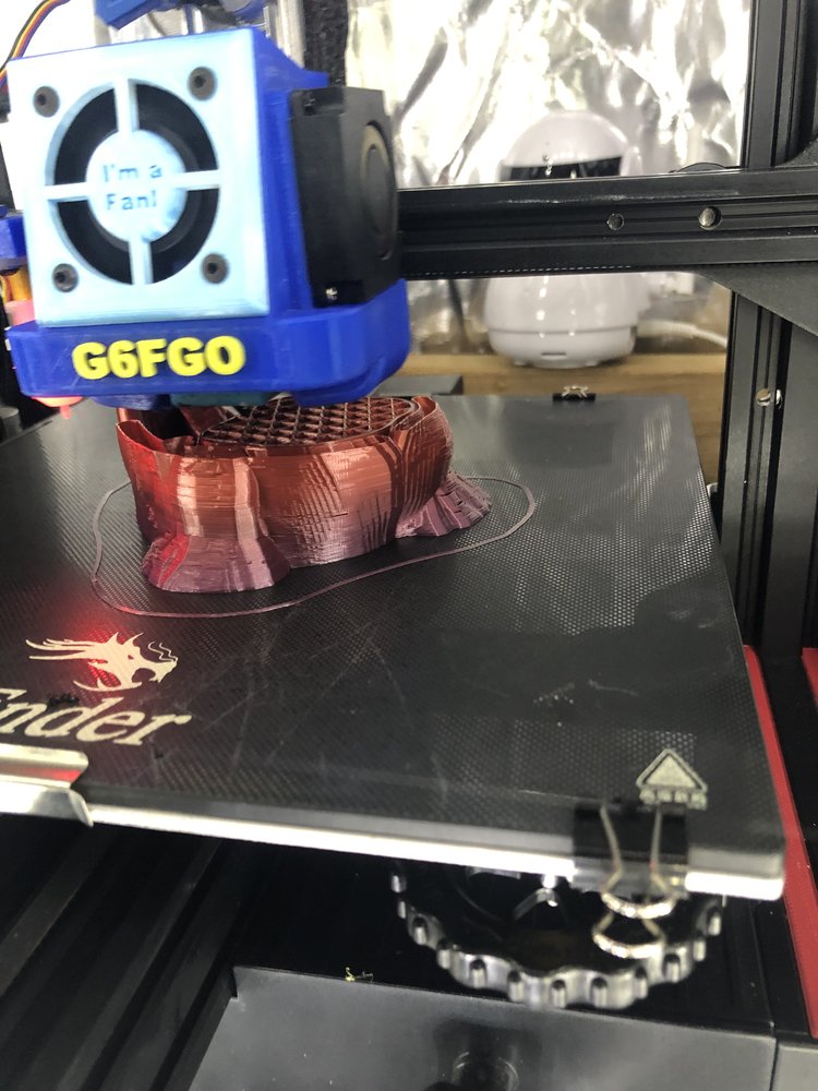

I was going to print a 205mm turntable, 2.8mm thick and with an inner flange to drop over a smaller turntable. I gave up the idea after being shown it would take over 11 hours to produce!
I'm thinking about the electricity meter ticking away!print time doesn't bother me, that's the thing I love about 3d printers, set it going then walk away and forget about it
used to regularly run prints that were over 24 hours - normally because I'm jamming as much on the bed as I can with each print :-)
I thought that my Ender 3 v 2 was rated at 400W. Is that an actual measurement from yours, or the rating plate?Quick check and the one I use is about 100w when it’s going.
