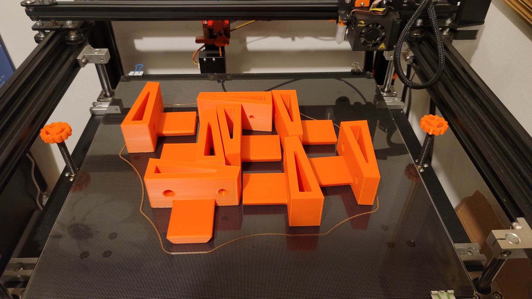

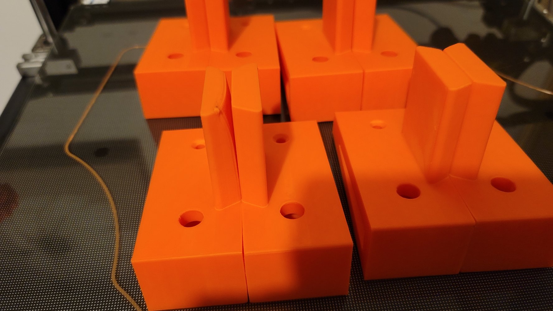

What material?A few BXA toolholder brackets
Did have a bit of warpage on 1 of them, total print time was 1 day, 2 hours
PLAWhat material?
Possibly, I did an auto arrange in Cura, didn't pay attention as to where it was on the bedMaybe it's not warpage but the orientation of the parts on the bed and one portion not adhering like the others did?? I think that as you appear to have achieved 7 out of 8 without the deformation this is quite likely.
Printer is in the corner of our spare room/home office, no draughts and door was closed to the room, as it was a 26hr print overnight the thermostat would have switched the central heating off about 2hrs after starting the print and came back on probably 10hrs into the printA cold draft can cause that.
I'm going to guess the warpage is on one of the parts where the tab is pointing outwards from the bed?
So far I've only experienced warpage. or prints splitting on ABS things that are almost solid and over 2.25 inches tall ,

The cracks appeared about an inch and a 1quarter above the adhesion layers.I still reckon it's a bed adhesion issue.
