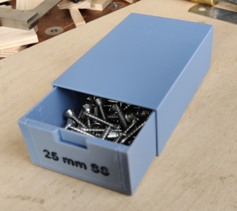

I bought 200 stainless steel wood screws and they came in a plastic bag rather than a box.
Quick fix:

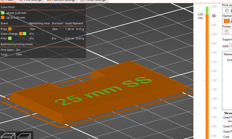

How did you do the black letters?

The black letters are on a layer of their own (the front label is an insert so that it can be printed on top rather than on a side face). PrusaSlicer has an option to insert a colour change instruction at a layer change, so it's very easy to print it. When it finishes the previous layer, it moves the extruder to the front right corner of the bed and lets you unload the filament and then load in some new filament.
As far as I'm aware, you can use PrusaSlicer with non-Prusa printers, but I've no idea whether the filament change instruction is supported by other printers.

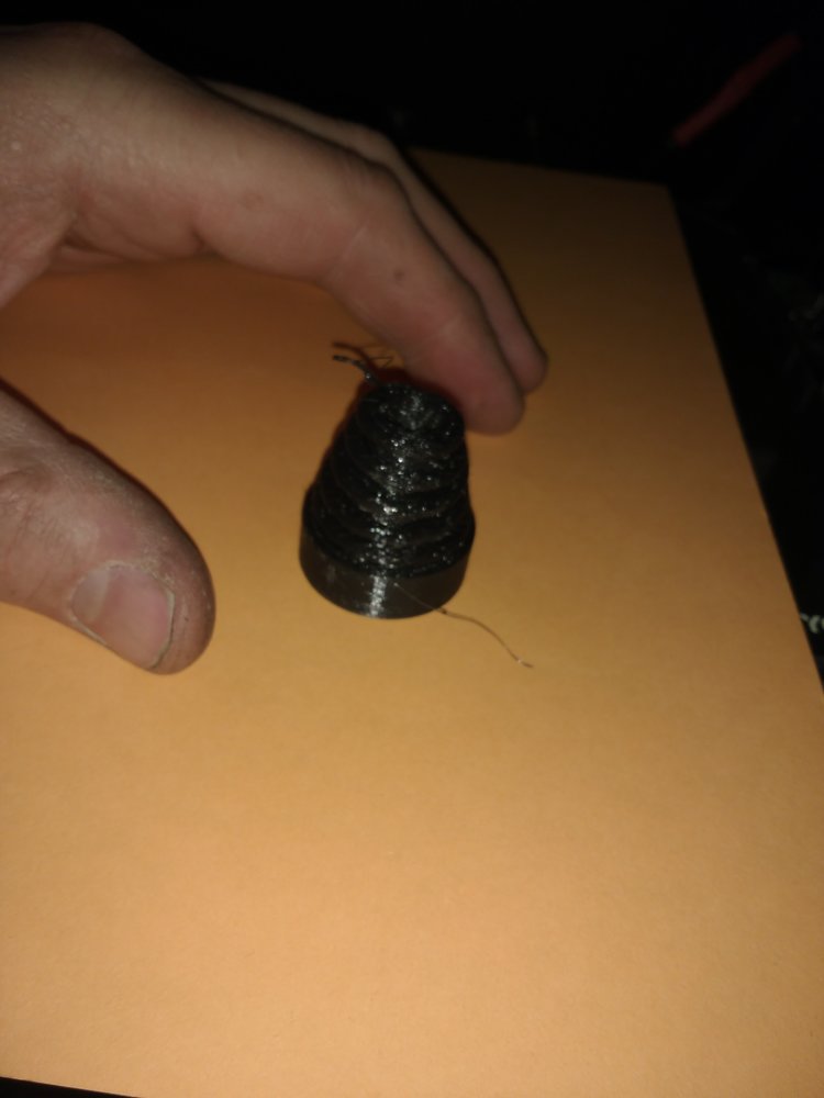

I can well imagine the next photo will be a large, black blob on the bed. Hopefully not, but expect the worst and everything that looks good is a bonus.
