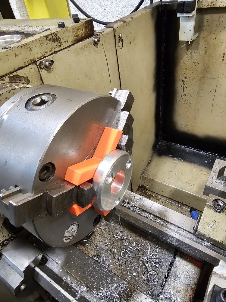

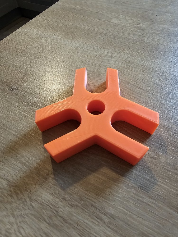

Spacer, to space thin items away from the chuck body so they can be machined
You might need to know the width of your jaws to ensure a decent fit.Neat job!Can I be cheeky and ask if you'd be prepared to print one off for me, I sometimes need to hold short work-pieces in the lathe [Myford ML7] and it's tricky getting them held in the right plane.
Happy to cover post and add beer tokens if so. I'd love a 3D printer but don't have the space [or the knowledge of designing for that matter] for one.
Thanks, I'll check next time I'm in the cave.
have you posted the file anywhere or did you get it of a site??Spacer, to space thin items away from the chuck body so they can be machined

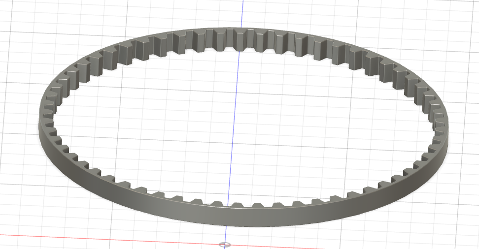

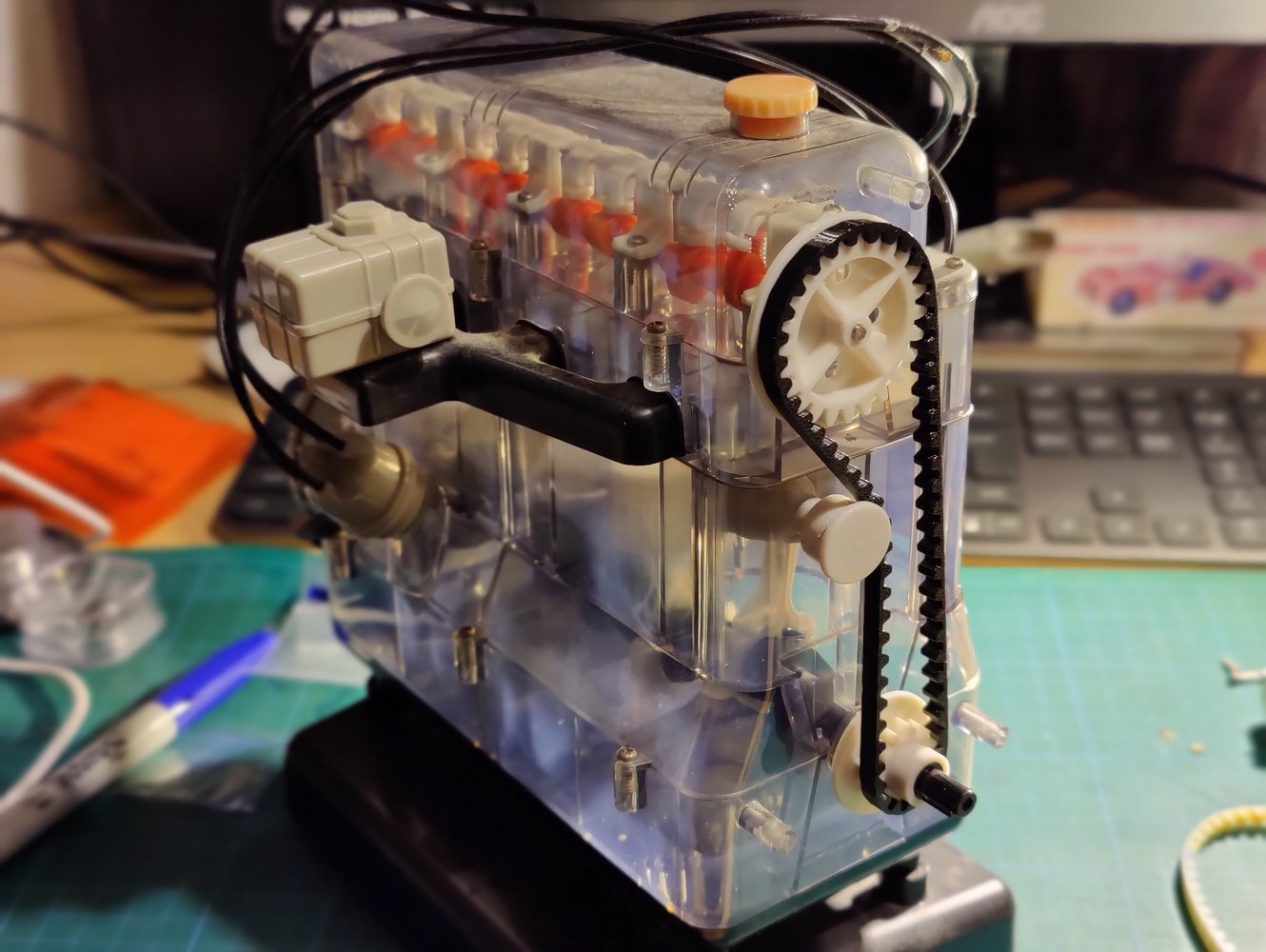

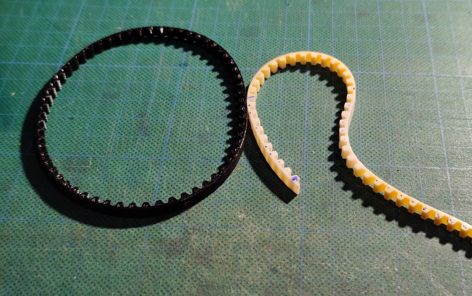

It's why I have a 3D printer, just in case.......Timing belt snapped on my engine so I designed another in F360 and 3D printed....
View attachment 444026 View attachment 444028
