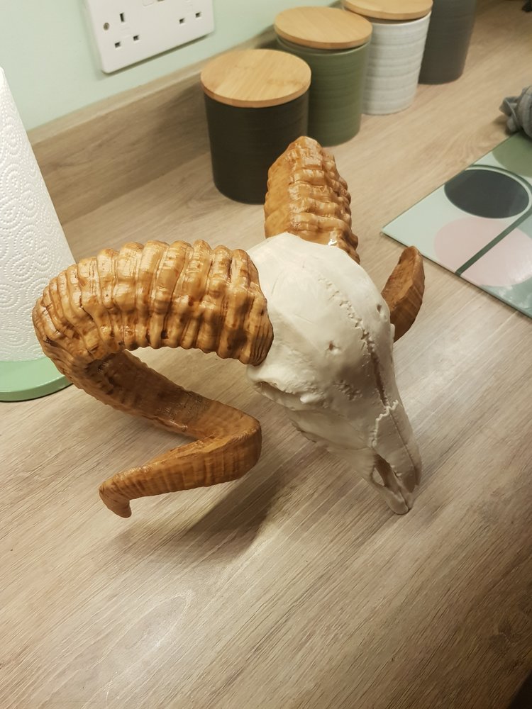

Make a great Shaman's stick headNo idea why son wanted a rams skull but it does look kinda cool , bone coloured PLA and creative use of wood stain
Yea on printables once I've tweaked the assembly required version a bitAre you sharing that anywhere?

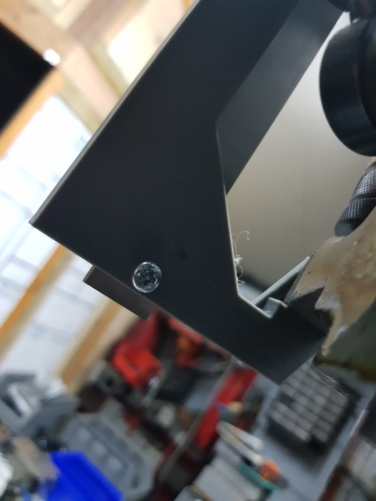

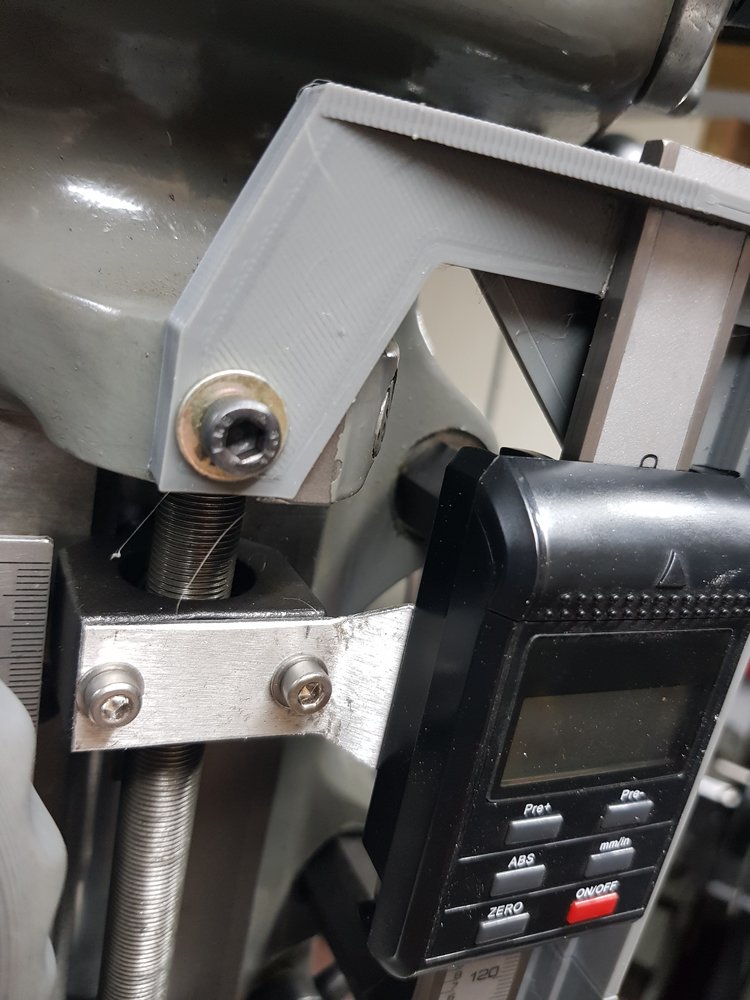

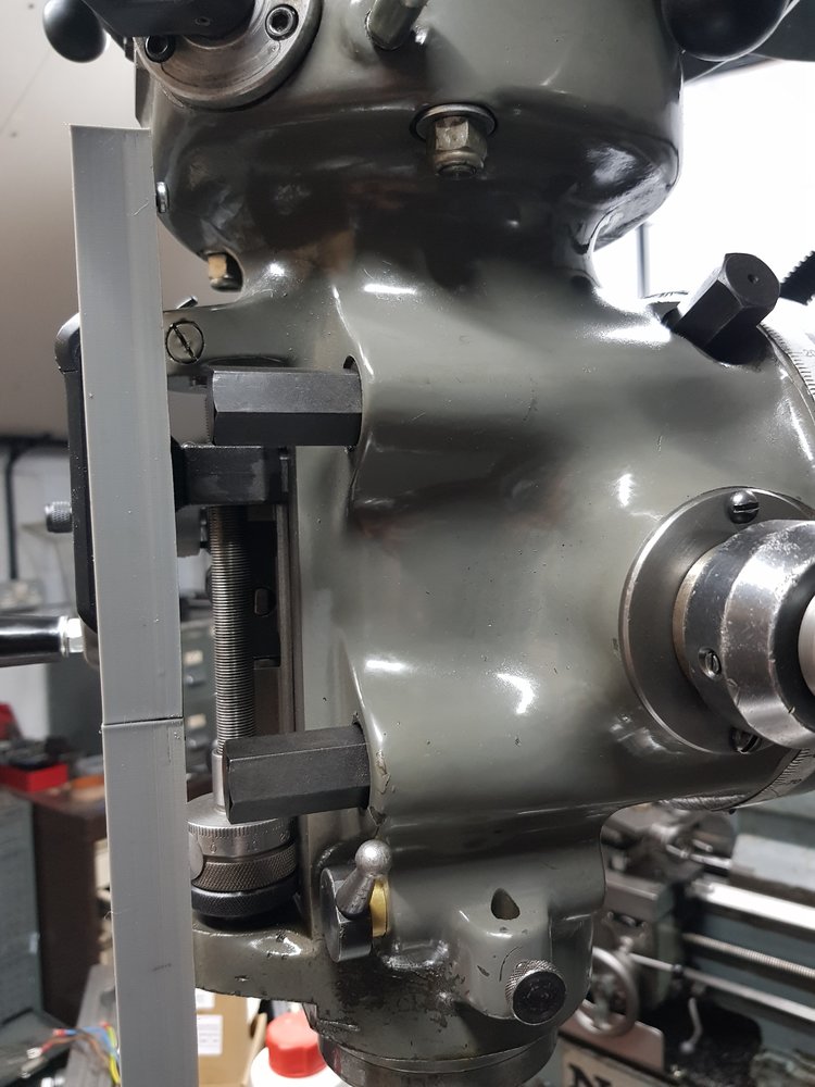

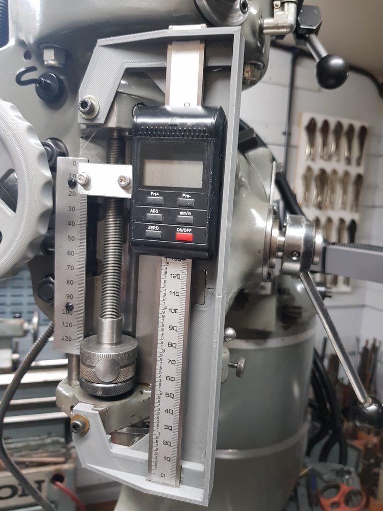

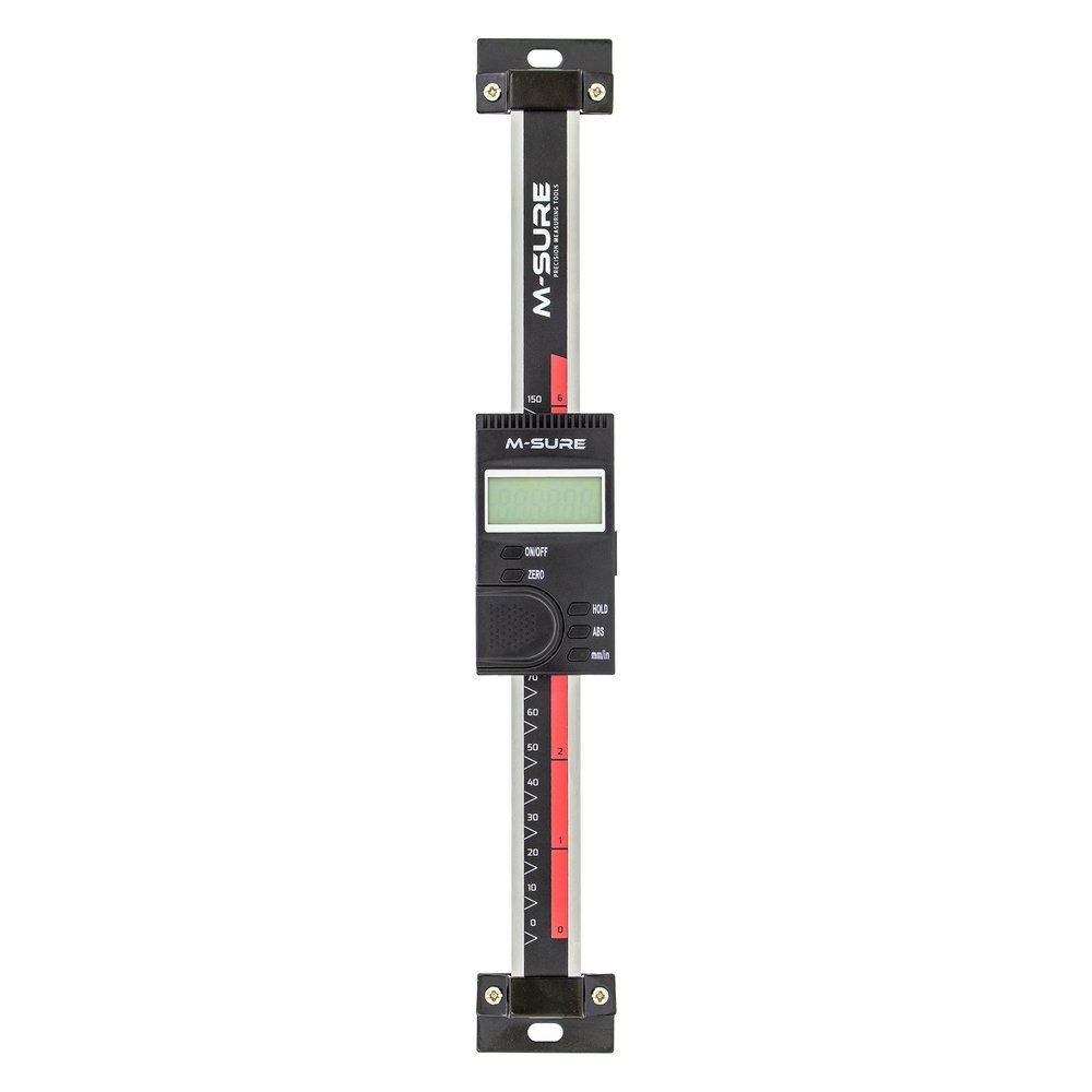

Awesome...its one thing i need on the bridgeport.Finally got my quill Dro printed and assembled , took quite a while to design as I didnt want to limit access to anything
uses a standard 150mm vertical readout you can get an m-sure one for £32
M-SURE MS-272-150 Digital Linear Scale Metric/Imperial Gauge 150mm (6 inch) MS-272 Series
. Advanced functions include Auto wake, ABS/INC, Data hold. Data output: Cabledwww.machine-dro.co.uk
its a tight fit but locking screws just in case
still good access to nuts
Holes will need drilling and tapping in the head and quill nut but you could just bend tabs top and bottom in the bracket to stop movement. Could also 3d print one but if you own a bridgeport and cant make one you should sell it !
I can post on Thingiverse if interested
