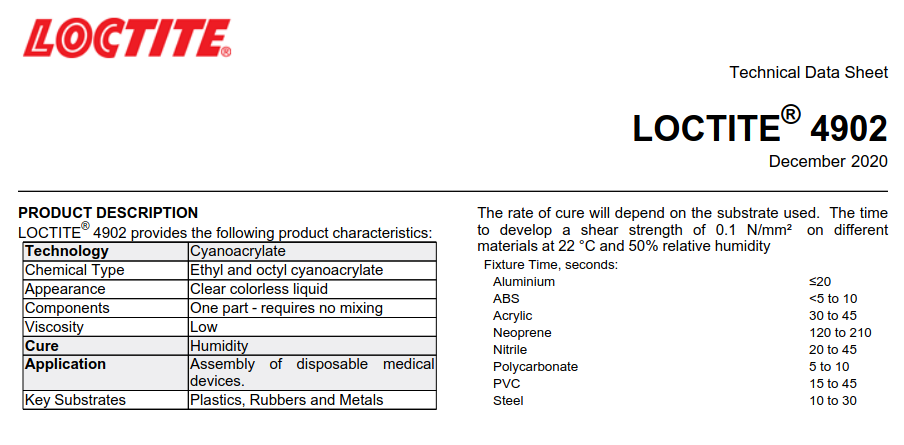

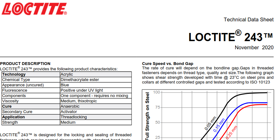

But the short of it is that it is not classed as an anaerobic adhesive. 1st pic. There are distinctive ones that are. i.e Threadlok (acrylic) 2nd pic Please look at the cure column. Mfr is HenkelBaking powder kicks the reaction off because the inhibitor in superglue is slightly acidic. Baking powder neutralises that and kicks off the polymerization. It's also usually that which kicks the reaction off in the case of surface moisture too, rather than the moisture itself. But yes, there's oxygen inhibition going on as well, oxides cap the ends of the chains and massively slow polymerisation. It's why even if you pour out a load of superglue and then stir water in it in the open air it doesn't just set instantly. Close fitting parts - especially active metals, act as catalysts and accelerate things rapidly. It's why superglue cures so much faster in thin bond lines, you exclude a lot of oxygen, you raise the PH more from surface moisture that's alkaline, and you have a large catalytic surface to get the oxide end caps out of there as well.

Sounds like the manufacturers are mistaken?But consider this. Superglue will set far faster in an assembled threaded fastener than most, if not all, threadlocking products, yet it doesn't polymerise when applied to one thread or the other (male / female), prior to assembly. So, what is going on there if it isn't anaerobicity?
Pass.No, the manufacturers are not mistaken. Think of it from the manufacturer's perspective though, and the involvement of marketing departments. Superglue is used quite a bit in medical applications (likely to be quite a lucrative side of the business), where water plays a big part in the polymerisation process so, what do they decide to put on the technical data sheet? The TDS is not a full and detailed summary of all the known chemistry (which they might not want to reveal too much about in any case). The fact is, water, oxygen, surface chemistry, and the inhibitors incorporated in the glue mixture, all play a part.

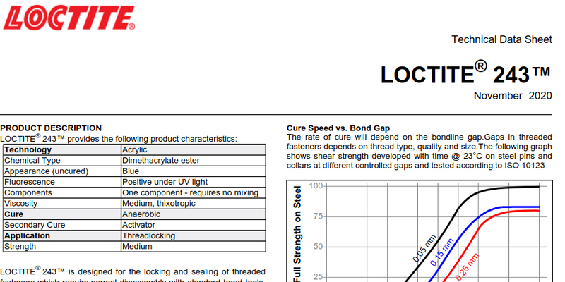

LOCTITE® 4902
Clear, colourless, 1-part, highly flexible cyanoacrylate liquid adhesive designed for the assembly of flexible medical devices.www.henkel-adhesives.com
PassBecause as I said, there's far more than one mechanism at play. Anerobic cyanacrylate threadlockers won't set on many materials, even with tight fitting threads and no oxygen around.
If they're purely anerobic like the TDS says, they should cure. But they don't, because they need other conditions *as well* to catalyse and kick off the reaction.
You can kick off superglue with no moisture at all - mix some baking powder in a big tub of superglue and stand back as it'll cure so damned fast it'll probably get up to a few hundred degrees, smoke like hell and probably give you serious eye pain if you're anywhere near it - no moisture required at all.
Same with adding purified, PH neutral water. It won't actually kick off the glue because it won't neutralise the inhibitor in the mix.
