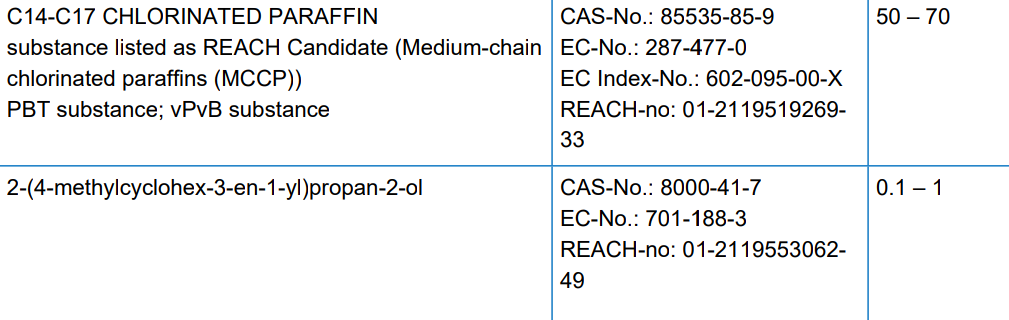

That will be your review on amazon then.. by "Moose". Thanks for the offer, but I may aswell just buy a tub.I've tried a few different things, but that Tap Plus is without a doubt the best i've used. I mostly power tap in the mill or lathe and that stuff makes a significant difference. I was very skeptical of it until i tried it, but now i'm sold on it completely.
If you want a small pot of it to try out, PM me your address and i'll send you some.
That probably explains why I have to wear a mask when making heavy cuts using RTD.The MSDS for Rocol says this
While the Molyslip stuff has no hazardous ingredients!? I suspect they have cheated with their documentation for the chlorinated version of tap plus.
He’s not likely to be taking such heavy cuts while tapping, methinks?That probably explains why I have to wear a mask when making heavy cuts using RTD.

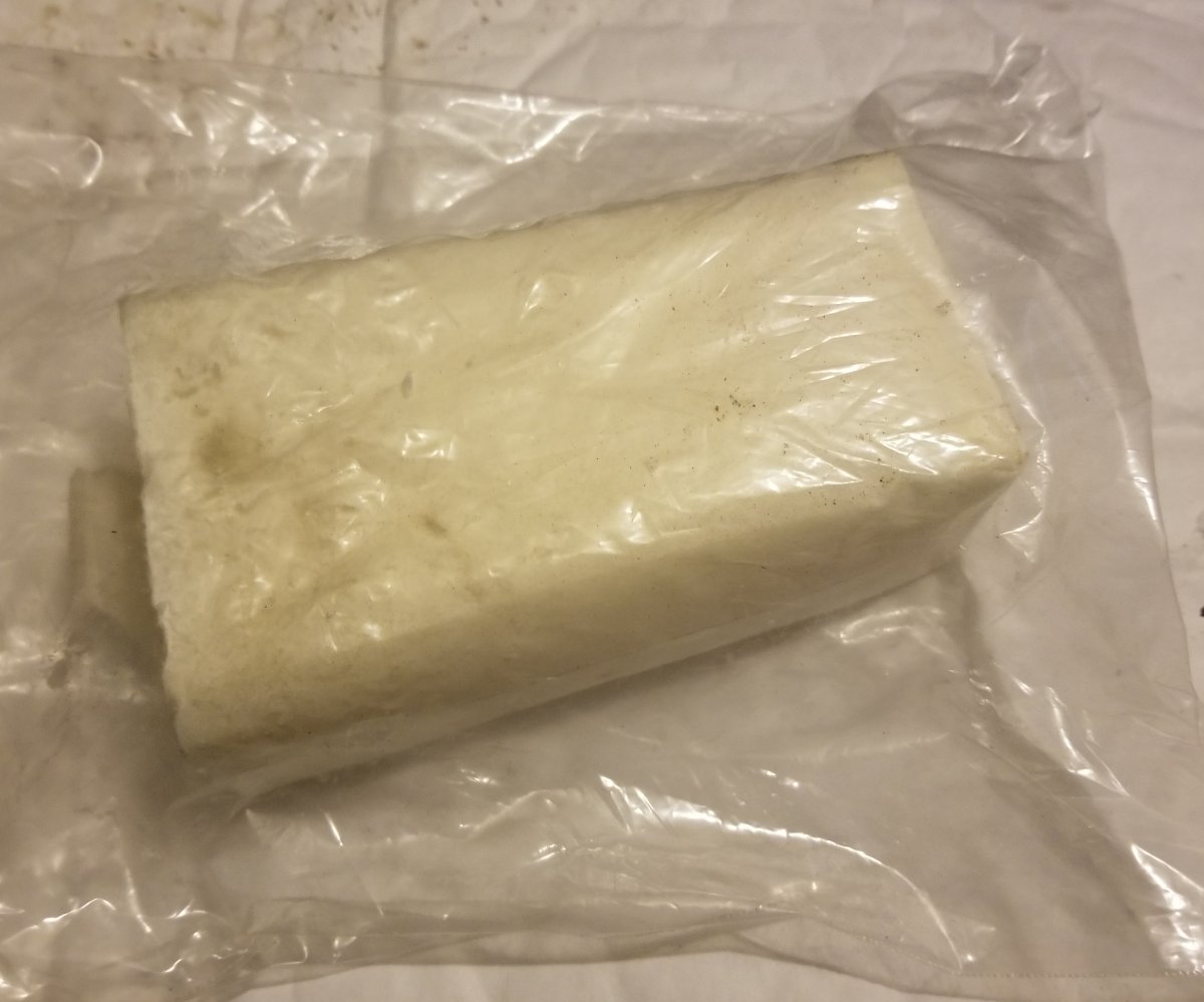

That’s what I use , not a fan of the paste’s especially in this cold weatherjust remembered i got a gallon of rigid cutting oil for threading given its 40 quid for 5 ltrs![]()
I use tallow on dead centres when grindingAnyone use tallow?
