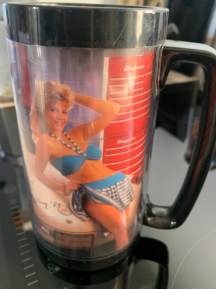

It’s like a lager advert!
Each one has two months on it. Hence six is the set.Reminded me of those cans of Tennents(¿?) lager you used to get, with pictures of Scotswomen on them. The printing looks just the same, and the models don't seem to have changed much either
What happens if you turn Mugs upside down
I think the inference is "Are they like those "tip 'n' strip" novelty pens?"
What?!

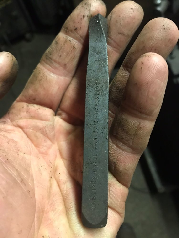

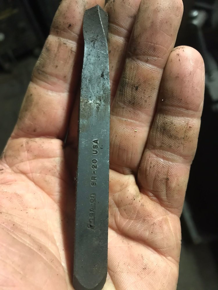

I think these are different tools, the ones @Keithmac is talking about are specifically for removing knackered allen/hex head screws/boltsThese are the old type
There’s a set of 5. The only thing that is better than the new ones is you beat these in then wind them out with a 12 point socket. The harder you pull the more they bite. They have never lost.
As with the other set, and the new ones (I imagine), 99% of the success is in the correct pilot drill

They’re available … unfortunatelyI am going to get a set.
I have the older ones like a twisted square bar, but yours are better.
Left hand drill bits are a good thing with any extractor
