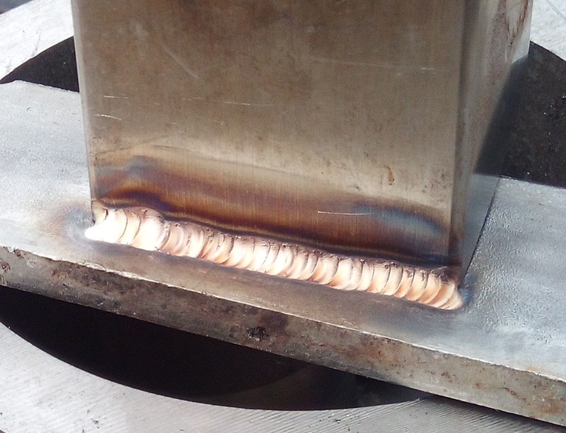

Not bad at allWell I must apologise to @Richard. I got some brazing rods from him a good while back and as I was busy refitting a boat I set them asside to try later on.
I clear forgot about them and only today when I was looking for something else I came upon them.
Didn't have any steel handy so I wondered if it would work on stainless, I had just been welding up a header tank from 50mm x 50mm x 1.3 stainless box so gave it a go.
Brazed it to some 8mm thick plate and it went reasonably well for a first attempt.
So long as there is enough current to melt the filler the gages of the material your joining is pretty much irrelevant.Ah ok, didn't realise that was what it was. Probably had the current too high, reckoned it would need a bit with me joining to the 8mm plate.

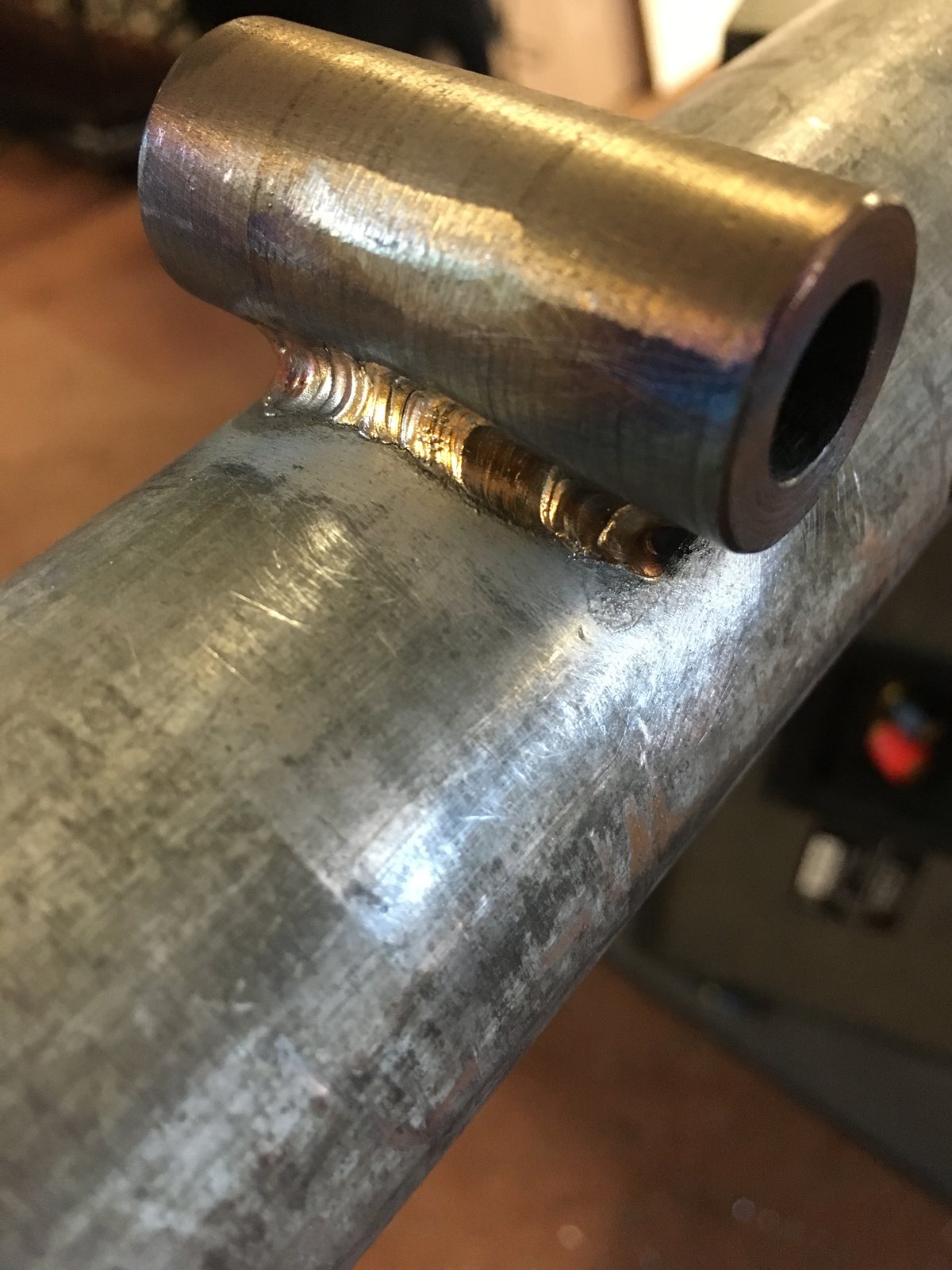

TidyI used to believe the same, however I dont have a problem in DC. This was from today. 80 amps, 2.4mm tungsten, SIF No8
2"scaf tube.
should say 1 of the frames will be for the bike in the avatar.........1932 ACE........
