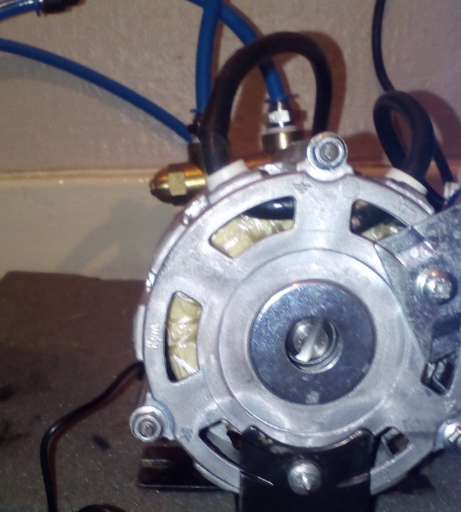

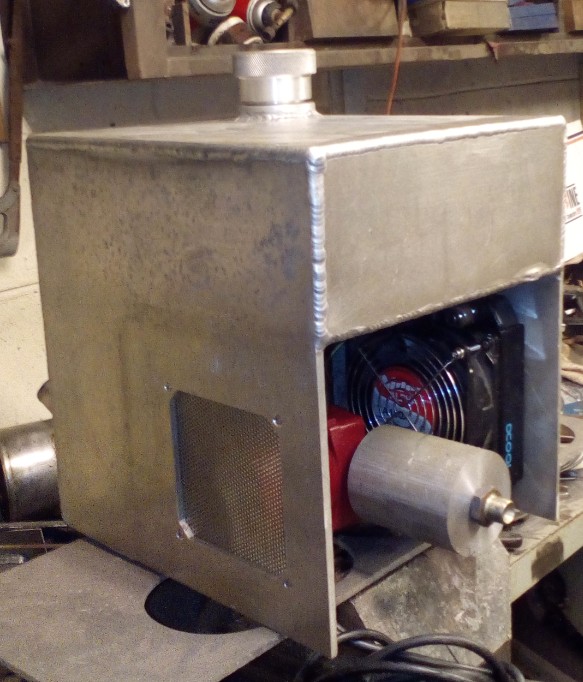

As said mine doesn't have a protruding shaft, see pic. Could be done by making a shaft up and a housing, would need bearings etc so much easier to just bolt a fan on the outside of the cooler I have now as it already has a place for a fan, see second pic.Like so but instead of using it as a fan for the rad like this person you could turn it round and use it to cool the motor.

You'll only need one fan for the exchanger. Can't imagine that motor is going to get that hot personally.Sound. Ill get one ordered up. The Heat exchanger, Pump, IN and EX Fans will be in the same chamber. Im hoping the EX Fan will pull air past the pump to help keep it cool.
Sounds interesting stuff Giz. Look forward to seeing it.Don't worry Richard. I will certainly do a build post/ How-to when i get round to it. I will be adding a couple of Gauges as well to compliment the setup.

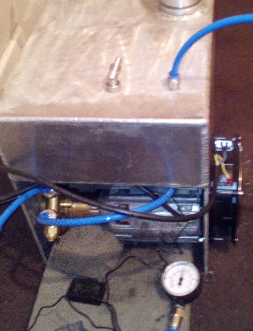

It appears to be doing the job mate.Ok temporary test setup in the old cooler tank with fan fitted on the outside. I can not place the motor fully into the fans airflow as the tanks output is behind the motor but it is about 2/3 in the airflow.

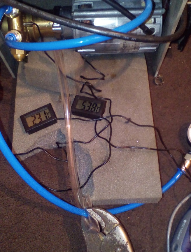

So first pic showing before I start, only had one temp gauge with probe on motor but as can just about be seen temp of motor is 20.5 degrees.

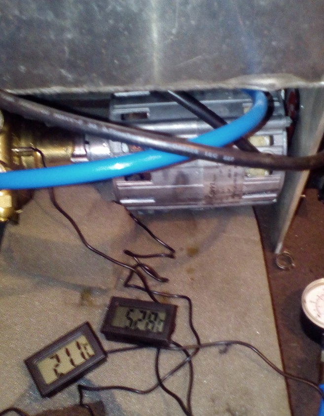

Second pic shows it after running for about 1.5hrs, motor is now 52.8 degrees and has been sitting at that for over an hour so seems constant at that. I also placed a probe into a hole in the pump, temp is 21.1 degrees so basically it has stayed the same as the motor was before it was started, looks like the fan is stopping the pump from getting heated by the motor.
