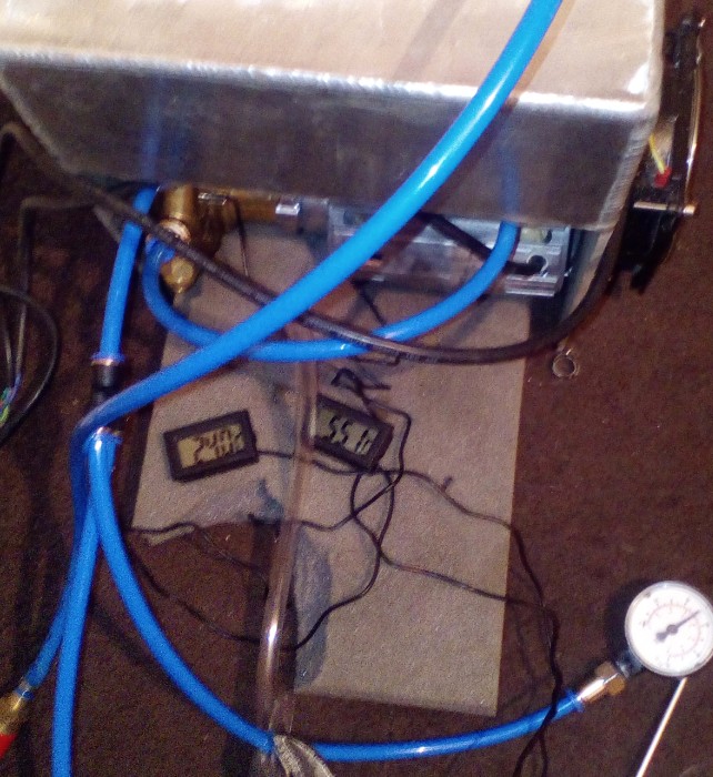

don't know how i missed that.Gauge on right is motor temp, one on left is pump temp (have probe stuck in hole in pump)
This is the trick mate. If your getting the warm air out then it doesn't matter what temp that motor gets up to.Oh and no it doesnt seem to be heating the tank, the airflow from the fan seems to be making sure the heat gets blown out.
Is mk2 a 12lt tank also?This tank should be worst case as water is above and the end of the motor is actually touching the Alu, so if it is fine in this I have no doubts at all that Mk2 tank will be fine.
The only thing I need to test for now is whether the volume of water will be enough to keep things cool or whether I will need a rad. No big deal as there will be space for a rad but it will be tight

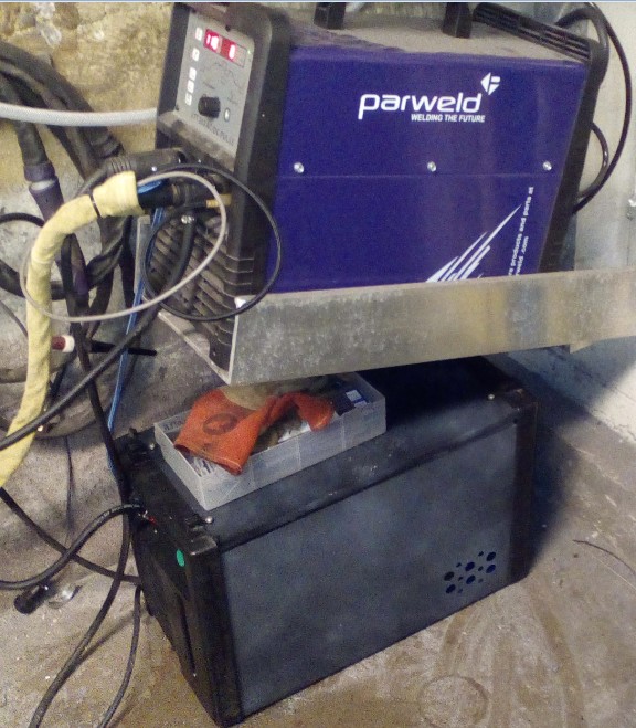

Looks ideal sat under there. Hope you filled her up first lol.Been busy the last while and will be for a while yet so bought a cooler from @Richard. ,until I get time to make my own, it arrived today.

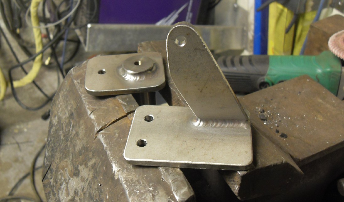

Hooked it up and have just done a couple of small stainless welds and everything is working fine
