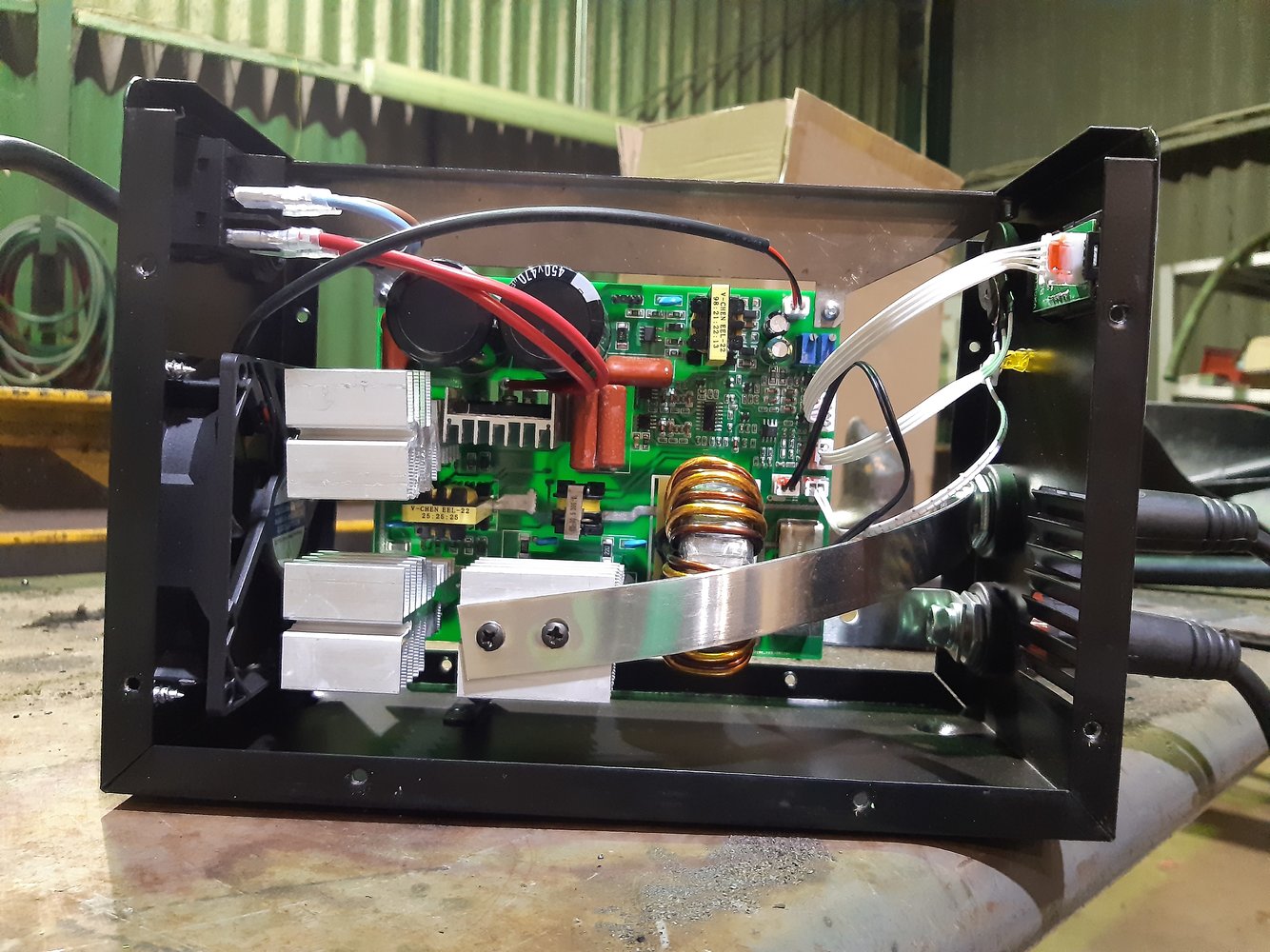

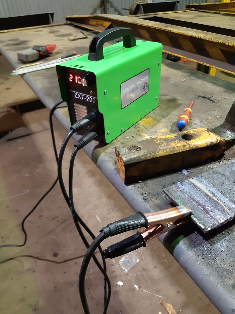

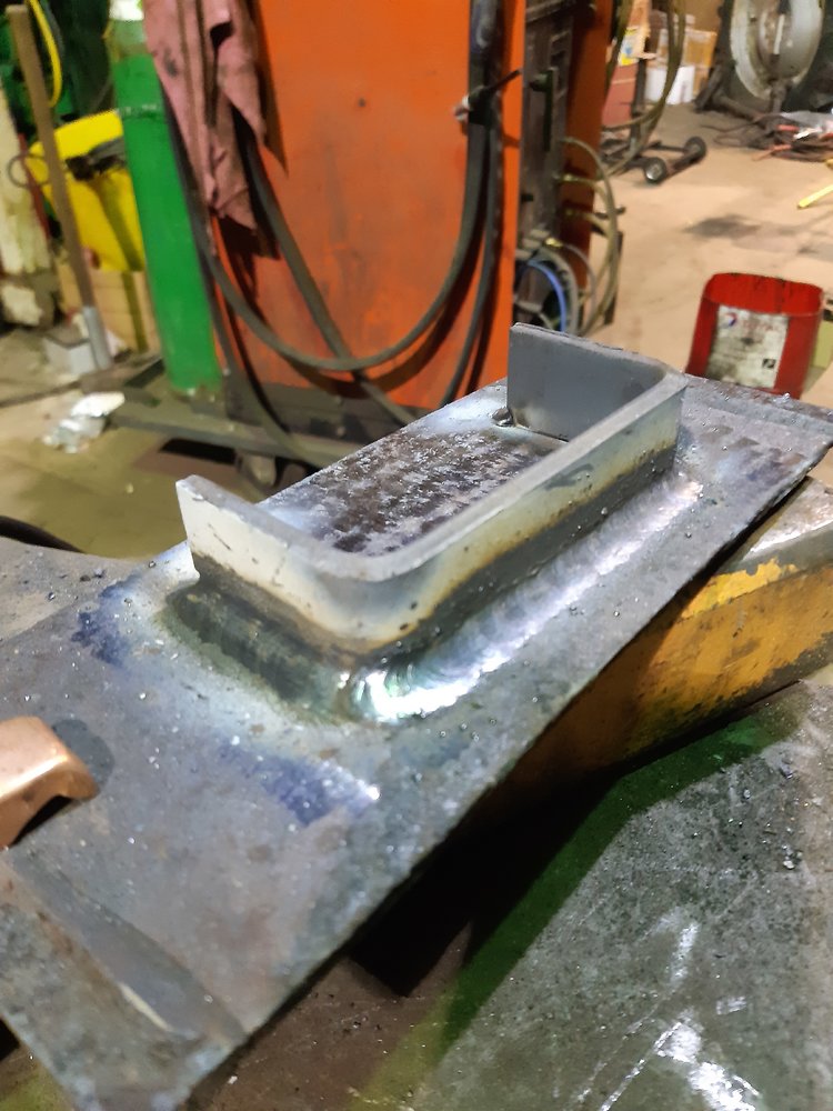

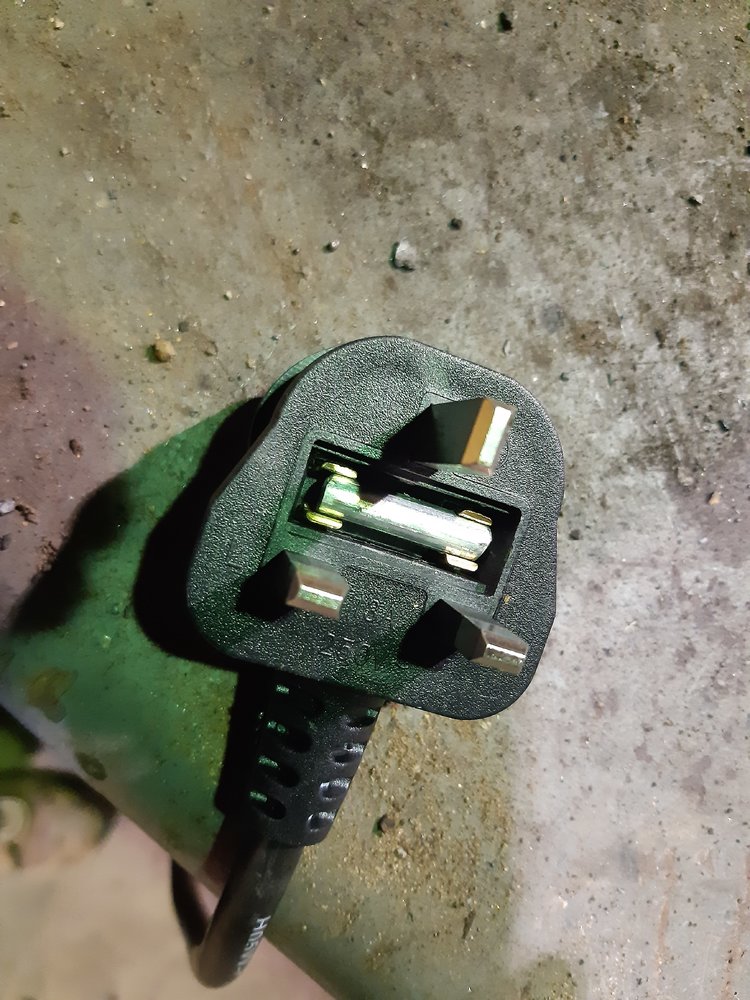

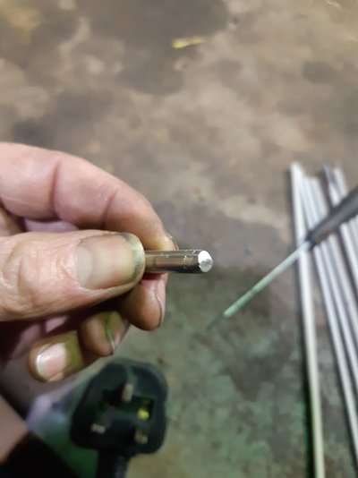

Probably doesn't have a thermal overload going by their use of the slow blow fuseThe current meter over reads by a good 80amps showing 210 flat out which I reckon is actually about 130. But it works and ran 10x 3.2mm rods in a row without cutting out flat out. The welding leads were smoking though. View attachment 320239View attachment 320240
I would have thought a 13amp fuse would be cheaper than that slug!No words to describe that plug.
