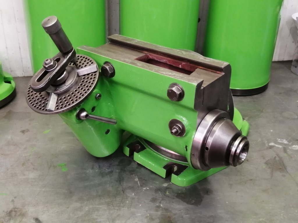

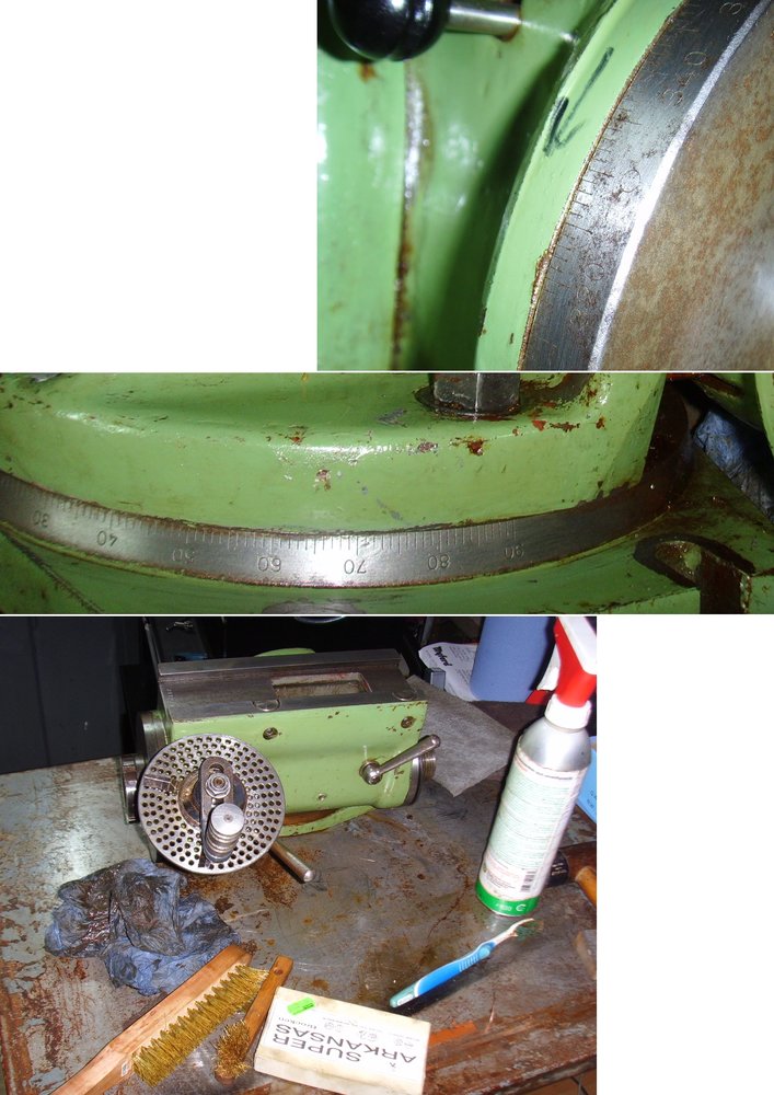

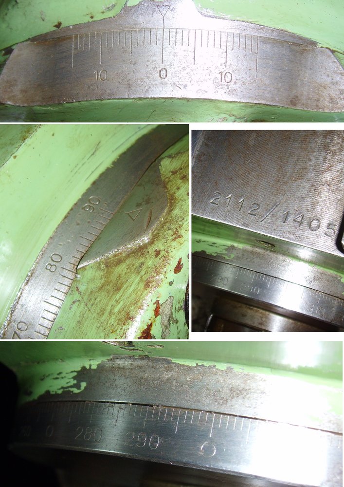

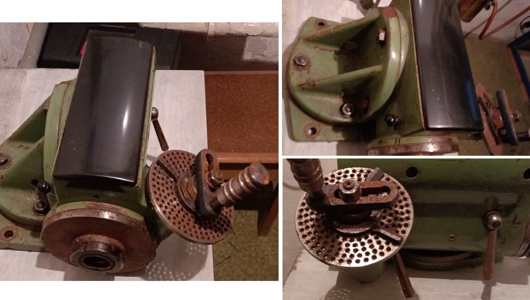

Sunday evening, a phone call, "I don't know if you can do anything with it, it's in a cellar, that has to be empty, the thing is really heavy, something mechanical, but it doesn't do anything - I'll send pictures":
A rusty heap, stood in a damp cellar against a damp wall on the damp floor - but still promising - got it yesterday, round trip ~100km.
Absolutely solid, nothing moved, not even the bakelite lid could be pushed open - so first I soaked it in Ballistol.
Today I went to work : it is - you have seen for yourselves - a dividing head or dividing apparatus.
But this is an FVT from Friedrich Deckel, Munich - the company that has virtually set the standard in mechanical engineering here at home, at least for milling machines. Some people would give their right arm for a good FP1 or FP2; these and their successors FP3 and FP4 can still be found in productive companies today ...

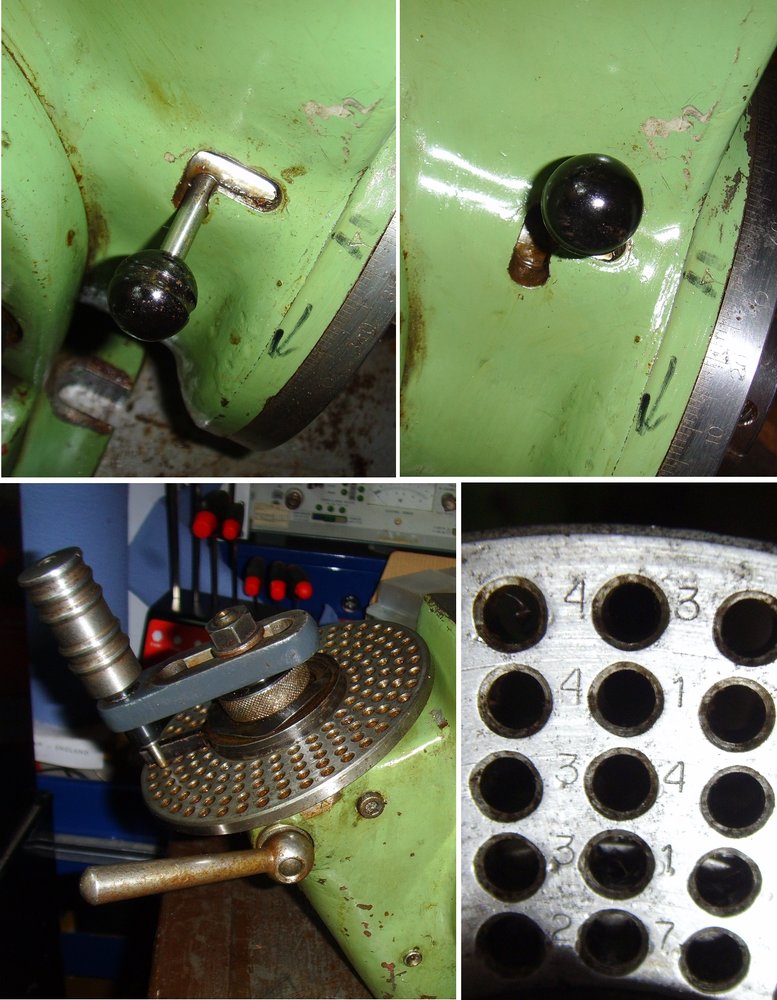

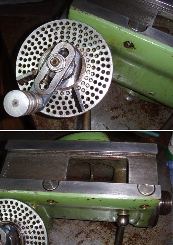

I have been able to achieve that much in the meantime:
Everything moves again, every function is given, all scales are free and readable again!
The gear ratio is 1:40, 40 turns of the handle for one full rotation of the work piece.
The head every 15° has a detent for 24-fold direct dividing, the small spring-loaded knob is armed by raising it and locks into the next 15° detent when the handle is cranked.
For indirect dividing I only have this one disc, but something can be done about that ...
Enough rust seen for today
Carsten

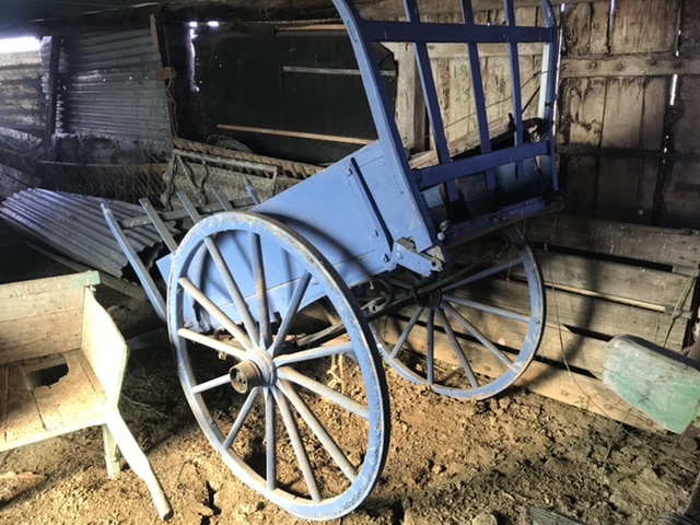

A charrette, a small cart. Our elderly neighbour has it in her field barn which she’s now sold and wants rid of it. It’s quite small and has very short thin shafts, so not horse-drawn; maybe a donkey cart, or just hand drawn?
