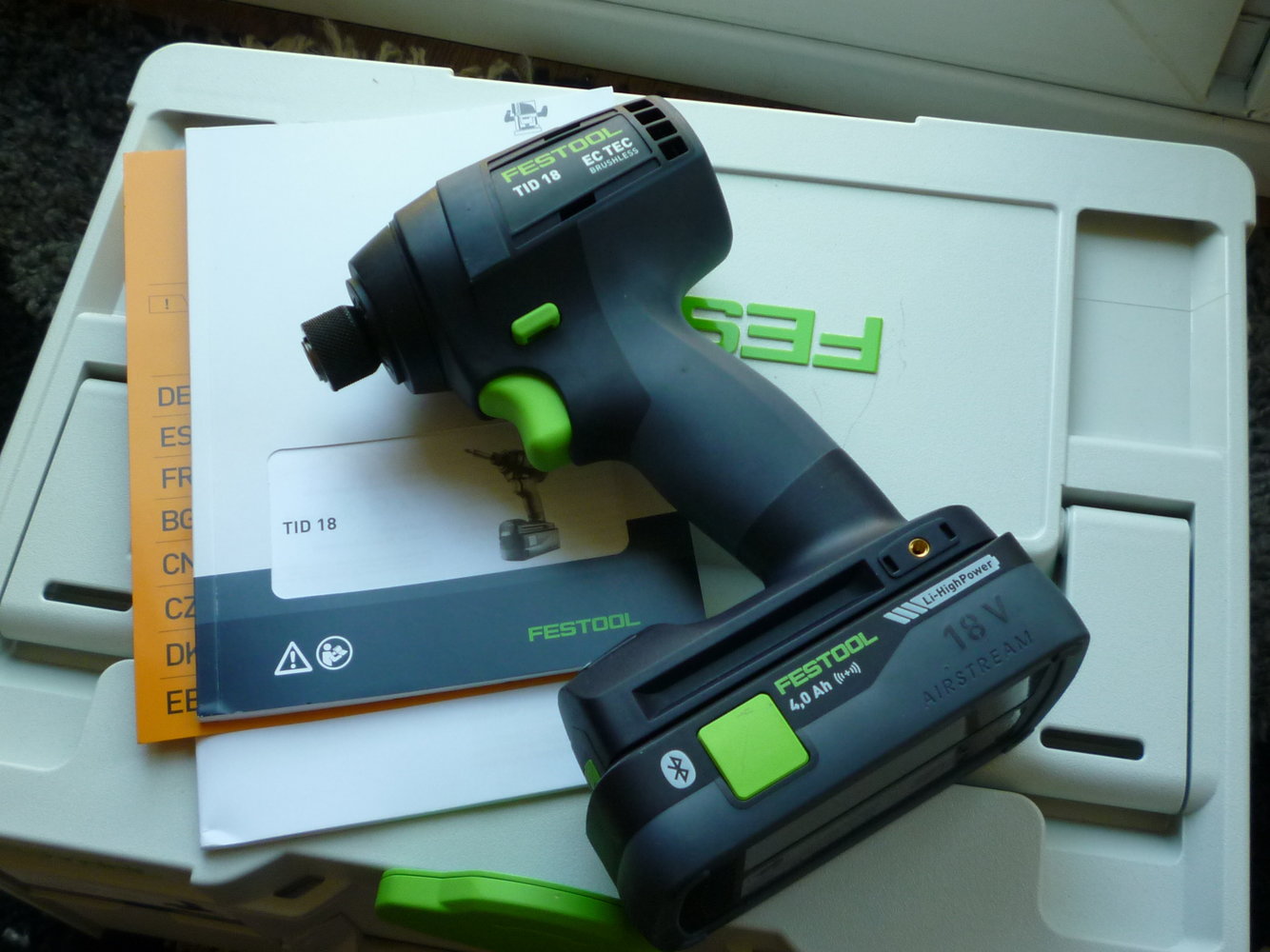

Did 18 or 36 v ? I've loads of the Hikoki / hitachi stuff and can't fault it .A new impact gun after the old sealey finally gave up. As I already have hikoki/hitachi batteries it made sense.
It’s a bit of a beast, only tried it on car wheel nuts so far and it’s like they weren’t there, I’ll give it a go on the lorry nuts and see it gets on
View attachment 349292 View attachment 349293
It’s 36v, I’ve got a few of the 18/36multivolt batteries and plenty of the 18v batteries for all the other hitachi/hikoki stuff I’ve got. It’s all good gear, it puts up with the abuse I put it throughDid 18 or 36 v ? I've loads of the Hikoki / hitachi stuff and can't fault it .
