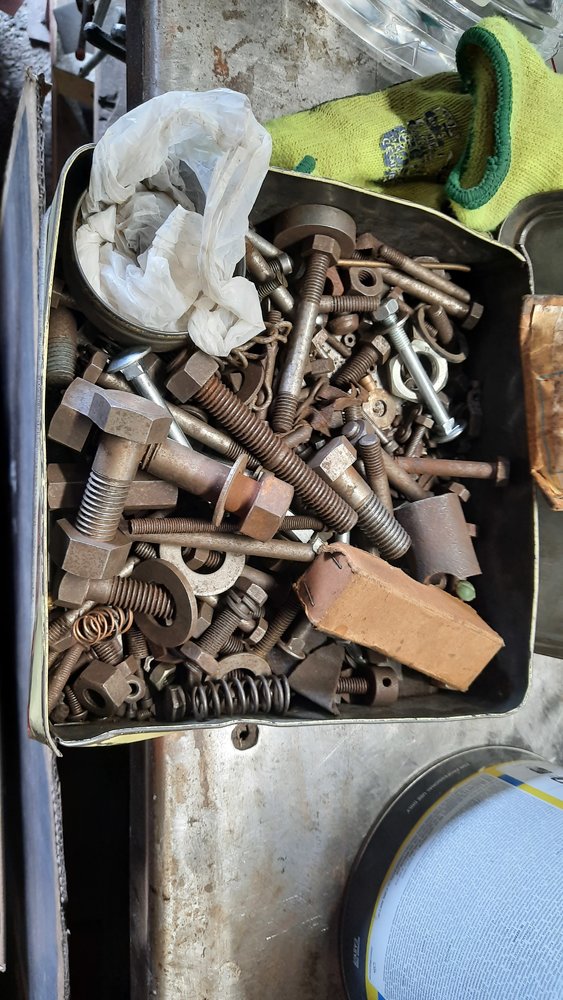

That's a seriously good box of useful bits - totally enviousSpotted a tin of old nuts and bolts outside a house for scrap, it would have been rude not to take them away.View attachment 361476
The person who threw that box out is going to need one of those bolts next weekSpotted a tin of old nuts and bolts outside a house for scrap, it would have been rude not to take them away.View attachment 361476

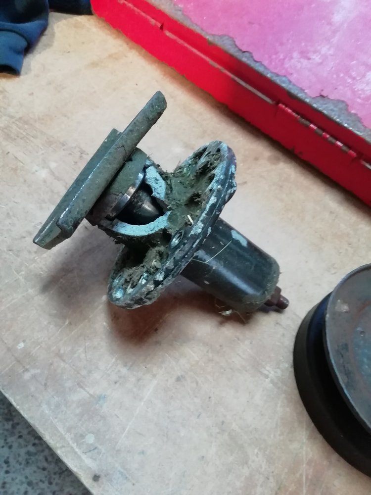

A broken ride on mower blade spindle assembly, just what I didnt need! Its off an American Roper so lets hope it crosses over to something else in the UK
First place i looked.. 4 tiny washersWhat's in the card box?![]()
Yes you can.Cant beat a tin of things, everybody should have one
