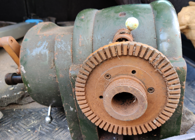

Firstly, this dividing head & centre seemed a bargain for £30, even though it's far too big for my current milling machine. One day I'll get a bigger mill and, as long as I can figure out a way to hoist it onto the table (it's too heavy for me to lift!), it'll be very useful.
Lots of surface rust, but everything moves very smoothly (once I'd figured out what to do with all the levers so it wasn't locked in position). Needs a chuck, but I'll worry about that once I've spent some time cleaning it up.

When its level, does it reach anywhere near the level of the split in the dividing head? Or is it lower/higher?A few more piccies of the £30 dividing head (still in the boot of my car)...
Rusty spindle nose. The direct indexing thing has two sides, one with 60 (I think) teeth and one with 56 teeth. I guess the 56 tooth side is most useful for dividing into 8 or 28? I can't imagine many times I'd need to divide into 7, 14 or 56! Centre height seems to be about 120 mm so probably 4¾".
One dividing plate, but the sector arms are missing so I'll have to make some I guess.
Despite the rust, the hole counts are still visible:
I haven't completely figured out this end yet:
I've worked out how to engage and disengage the various drives (for worm input, gear input or free-turning for quick indexing), but I haven't figured out what that knurled thing is on the back of the spindle. It keys into the dogs on the spindle, so can't turn and I can't budge with gentle pulling force. Any ideas what it's supposed to do?
Re that knurly nut, it should come out to reveal a machined internal - parallel or taper.
