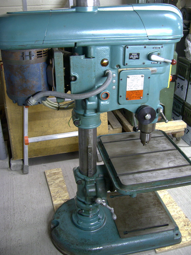

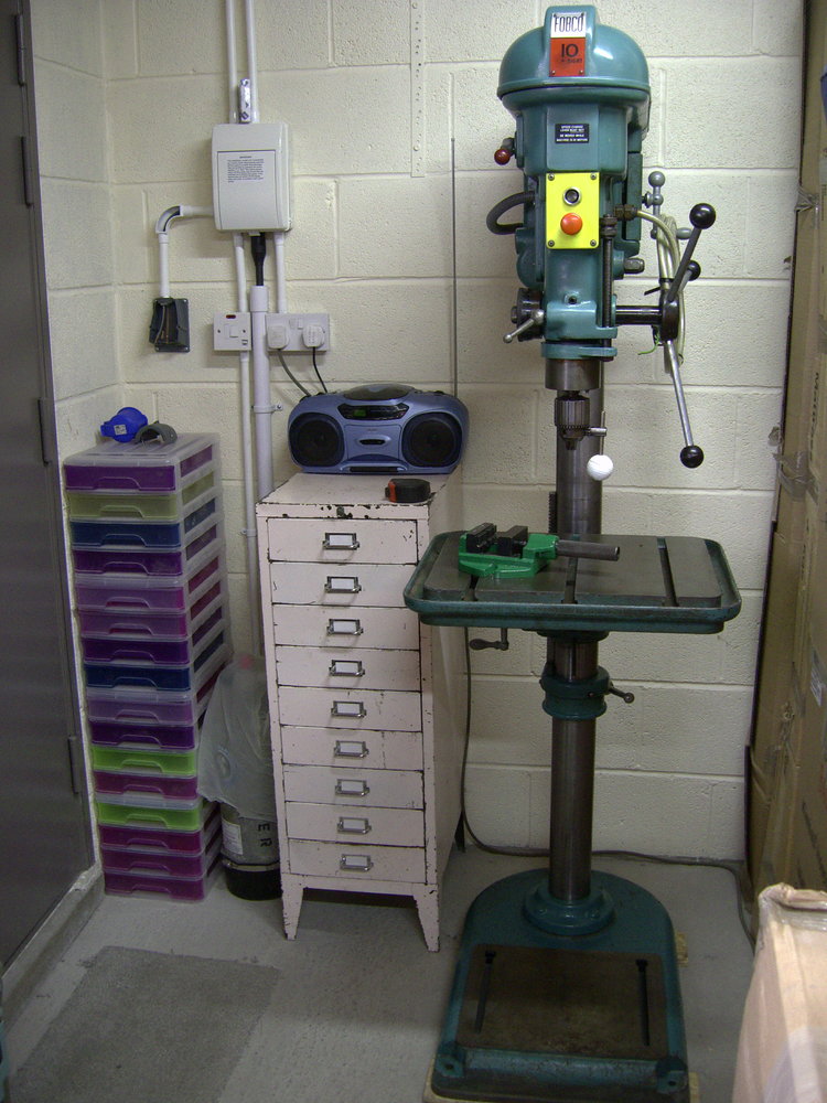

Its great to see a machine with an "undamaged" table.

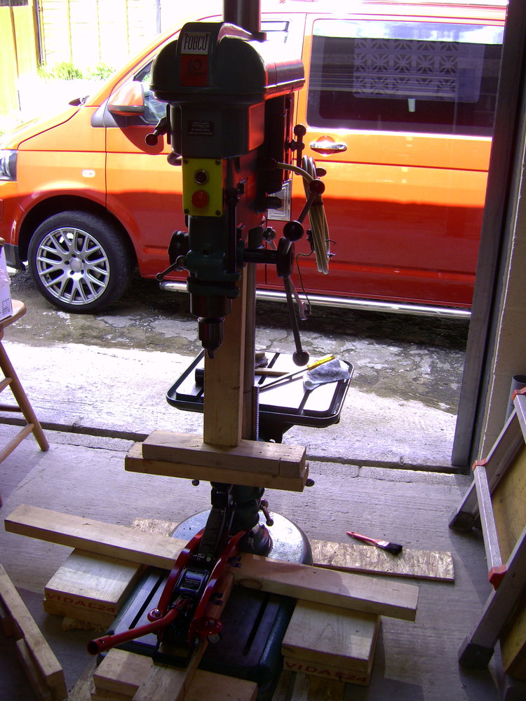

I know what you mean. Both my friend and I had a heck of a time getting the Fobco press I bought in and out of my van. Didn't think it was going to be substantially heavier than I thought. Getting the head back up the column was no easy feat either, but swinging the table out of the way and using a jack with some different length timbers, I was slowly able to raise it. Converted it to run off of single phase, and set up a plug & play box by my electrical mains with two appropriate converter's that work for using several machines I have.Mine is too - was a sod getting it in and out of a Transit Connect, though...
Still got to sort a new control box, mashed before I got it!

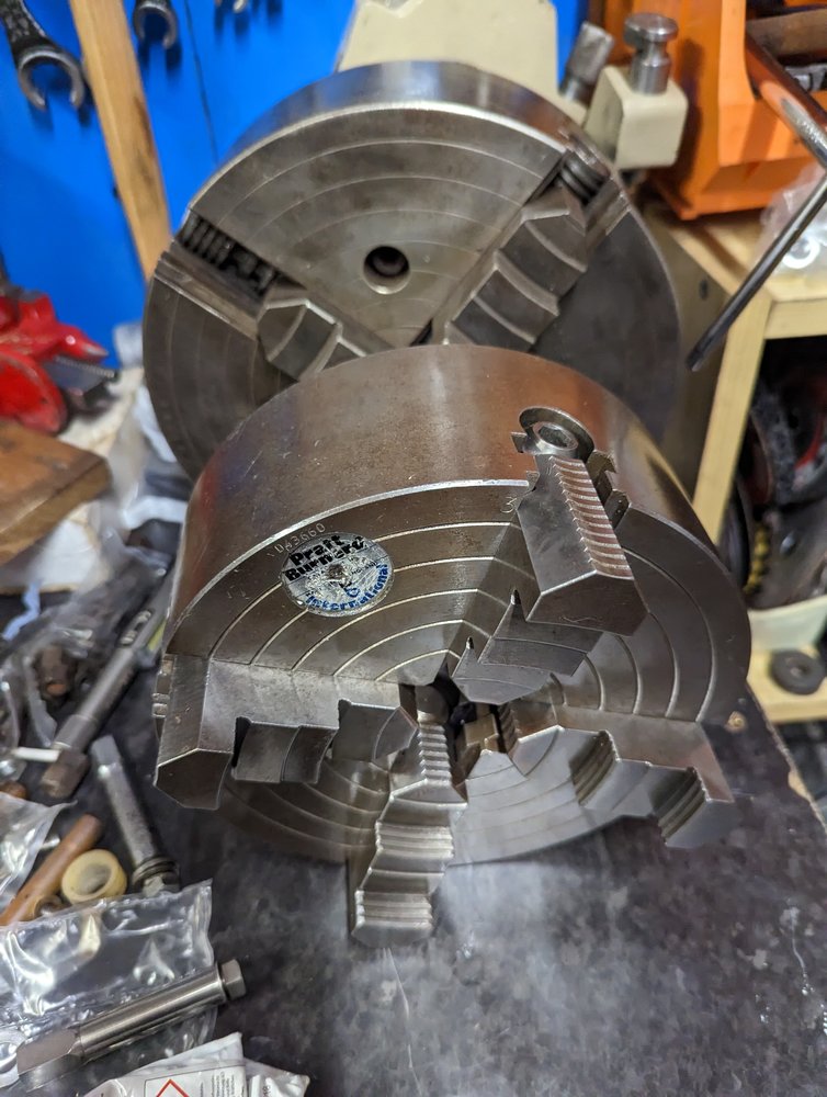

I have an 8 and 10" neither are fun to lift. Nice clean chuck
Easy to lift? They had a moan about that parcel when I dropped it off at the pet shop (ups drop off point)
Compared to my 10" chuck its a bit easier, just need to eat your porridge in the morningEasy to lift? They had a moan about that parcel when I dropped it off at the pet shop (ups drop off point)

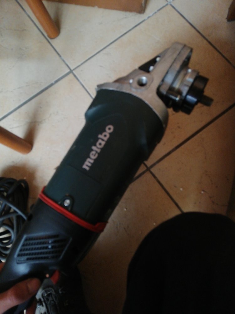

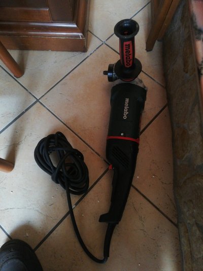

I've got a spare for a 115mm one. I'll check if it's that diameter, won't be for a week as we're about to go holidays!The Beast came home today

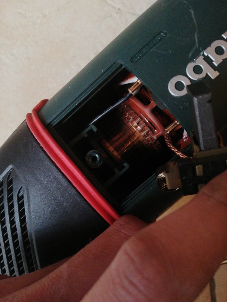

And as i thought, the only fault was the broken plug
It actually works perfectly
Made in 2014
It has worked very little time
The armature commutator still shines and the brushes still have the factory wear pattern on the contact surface

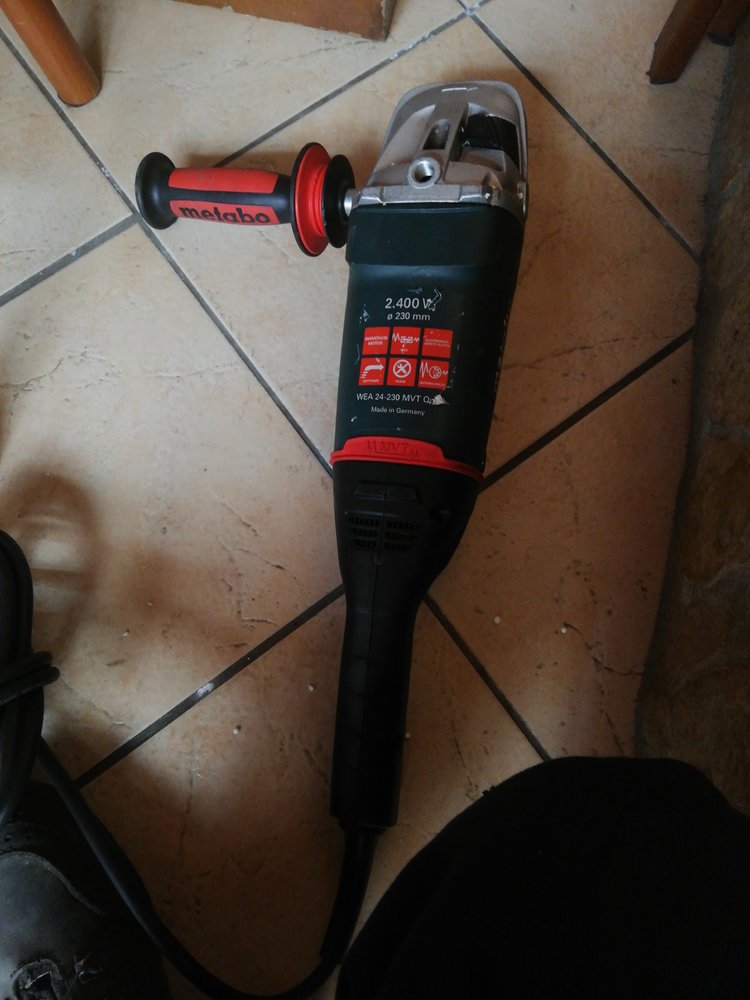

A real bargain for 50 euros.
Have to buy the guard since it's a particular size used by Metabo only , can't find even a knock off one
Inner diameter 63mm if someone has one hanging around

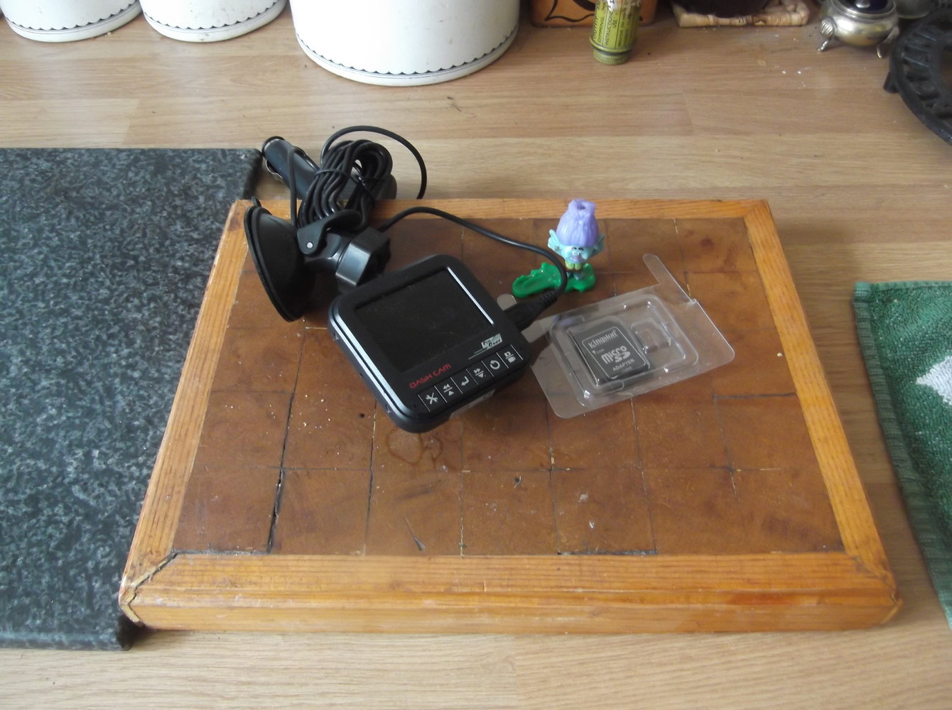

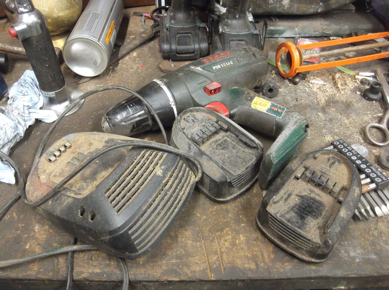

I had to go out today to get some paint.
On the way back I stopped by a friends place. He has just got a new company car, so I got the old dash cam.
Then next to our old MIs was a set of small business, a good place for a skip dive.
I asked if I could dive.
I was told no, but I could have this bundle.

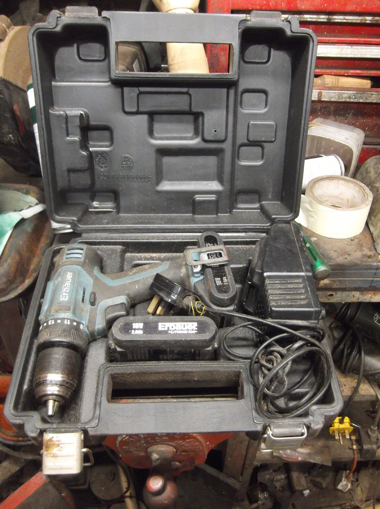

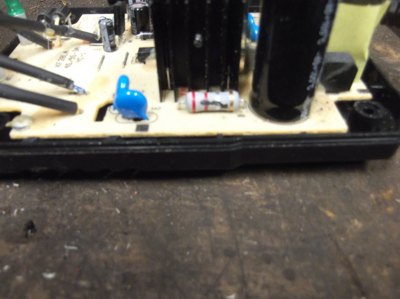

Junked, as it was over heating, I wounder why?
I good clean, PAT and we have a Bosch with 2 good batteries.
Dead, bother batteries flat.
Charger had blown the internal fuse.
Replaced that and it works.

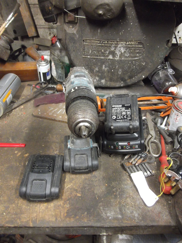

This one had a charger not working.
One resistor and one dead fuse..
Replaced them and we have another drill working.
