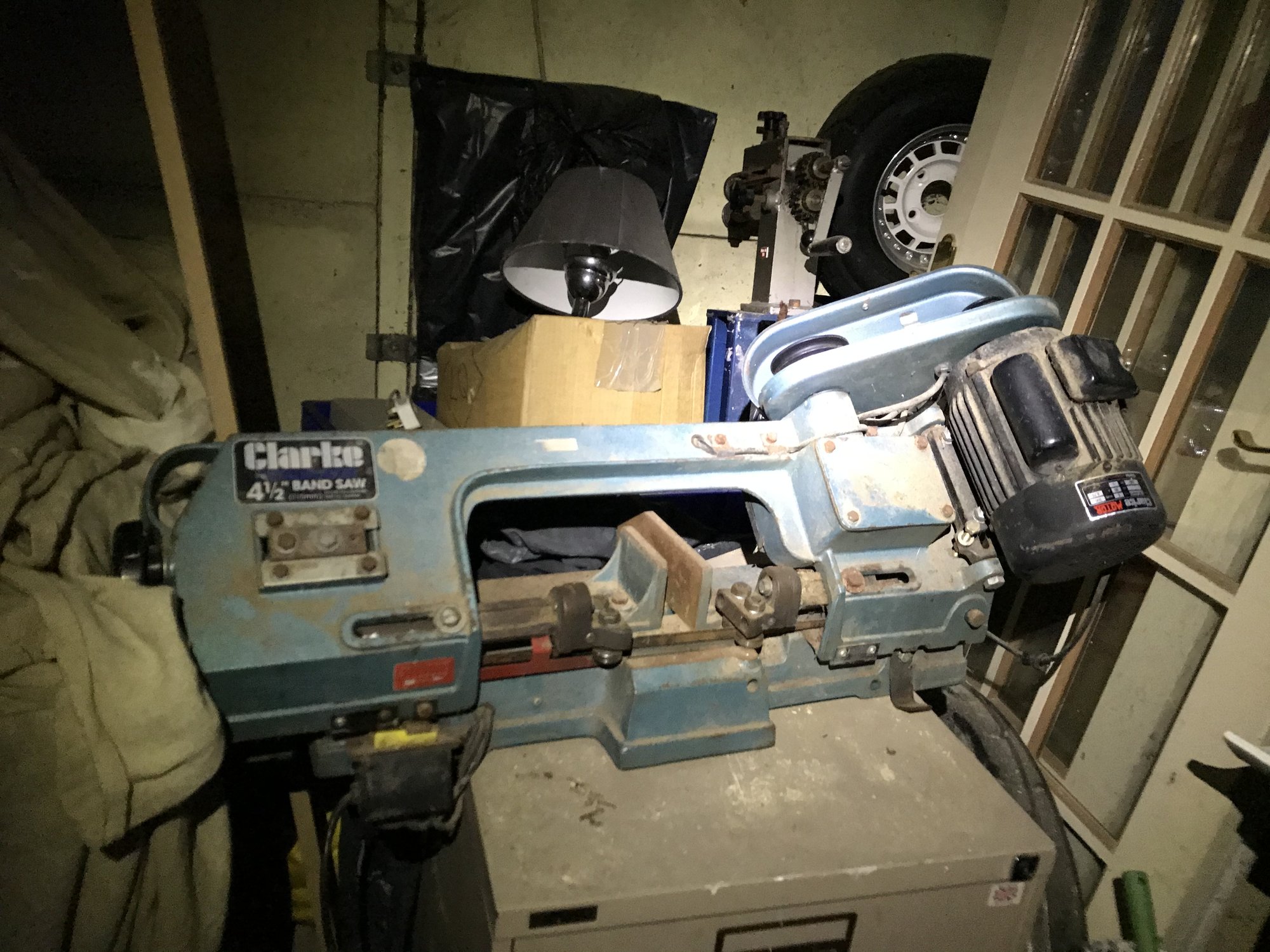

Bought a Clarke Bandsaw on eBay for not a lot of money and was due to collect it today. I got a message from the seller saying they plugged it in and couldn’t get it to work so I could still have it for free if I wanted. So went round today to collect it and was greeted by an old lady who after talking to her for a bit figured out that she was selling up because her husband had died. I couldn’t walk away without giving her something so gave her a little bit of cash I had on me.
Upon getting it home, I noticed the belt guard switch wasn’t secure so that’s my first guess but I haven’t had chance to plug it in yet to confirm my suspicion.
Came with the flimsy stand too but took it off to get it in the car.

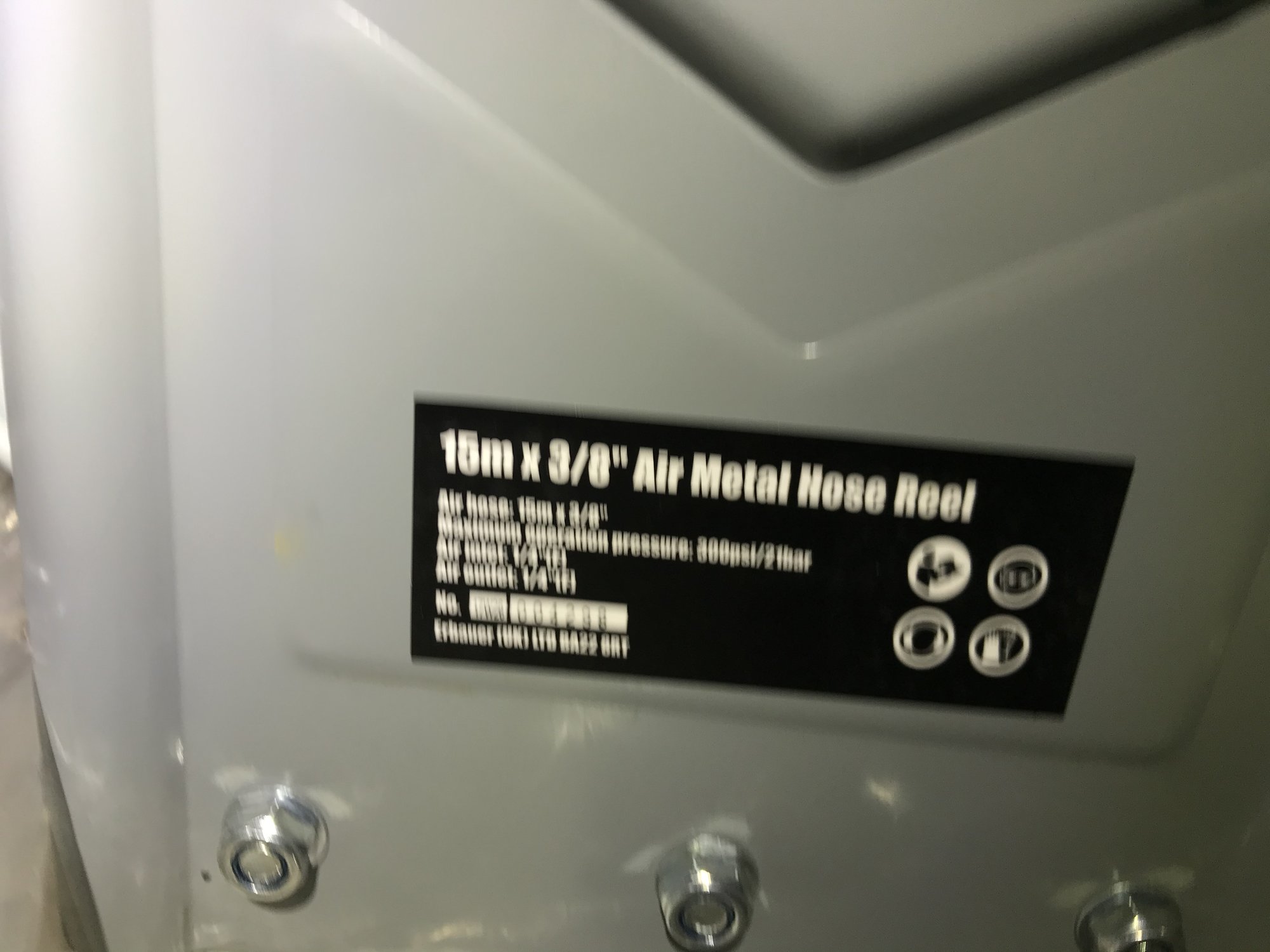

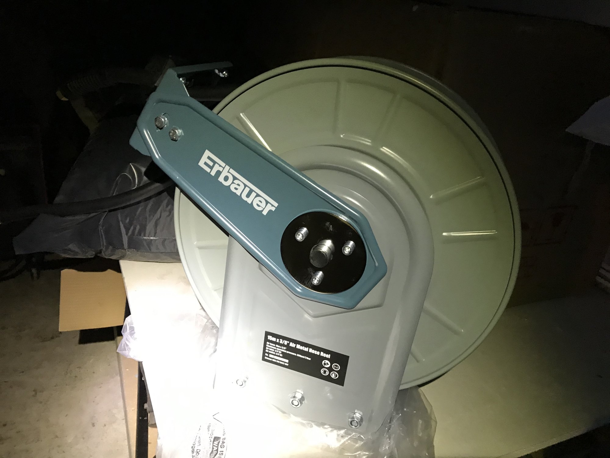

I also bought an erbauer auto-retract 1/4” air hose reel from Screwfix as it was the same price the similar offerings available on eBay. Upon getting it home, I saw those hose and thought it looked a bit thick for 1/4”, checke it and the labels on it and it’s a 3/8” hose reel.

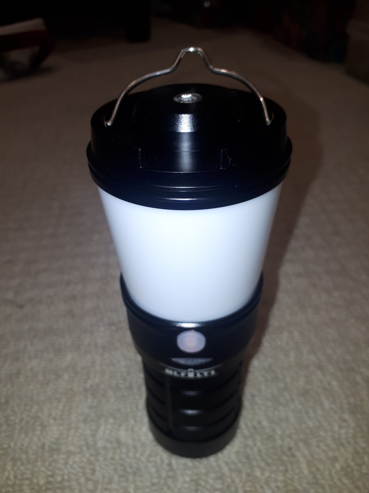

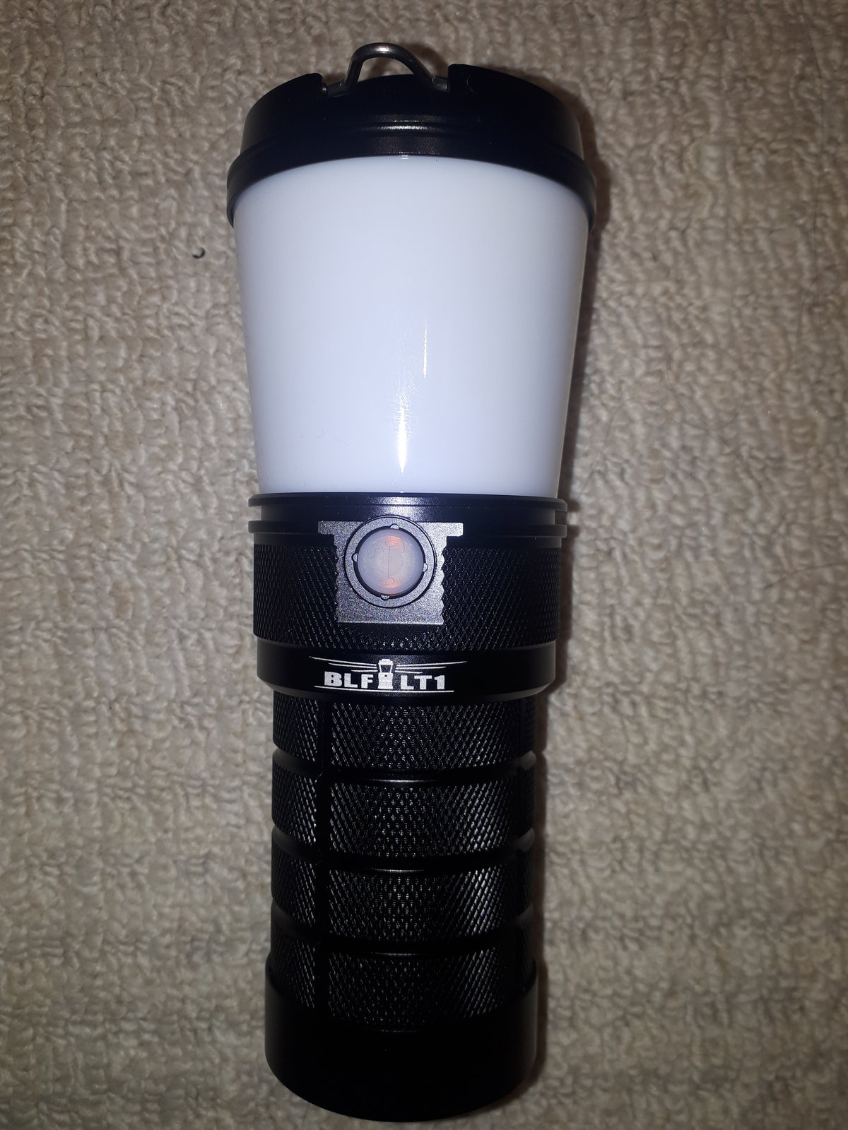

Bought this a few weeks ago, absolutely brilliant light for working on cars, in the workshop and just generally. Worth far more to me than the measly £8 I paid (hence waiting to write about it in case of short life).
The strong magnet on the base holds the thing at any angle, the rotary switch adjusts to any brightness, it is seriously bright on full power and the batteries seem to last for ever. Most useful, best value thing I have bought in a long time.

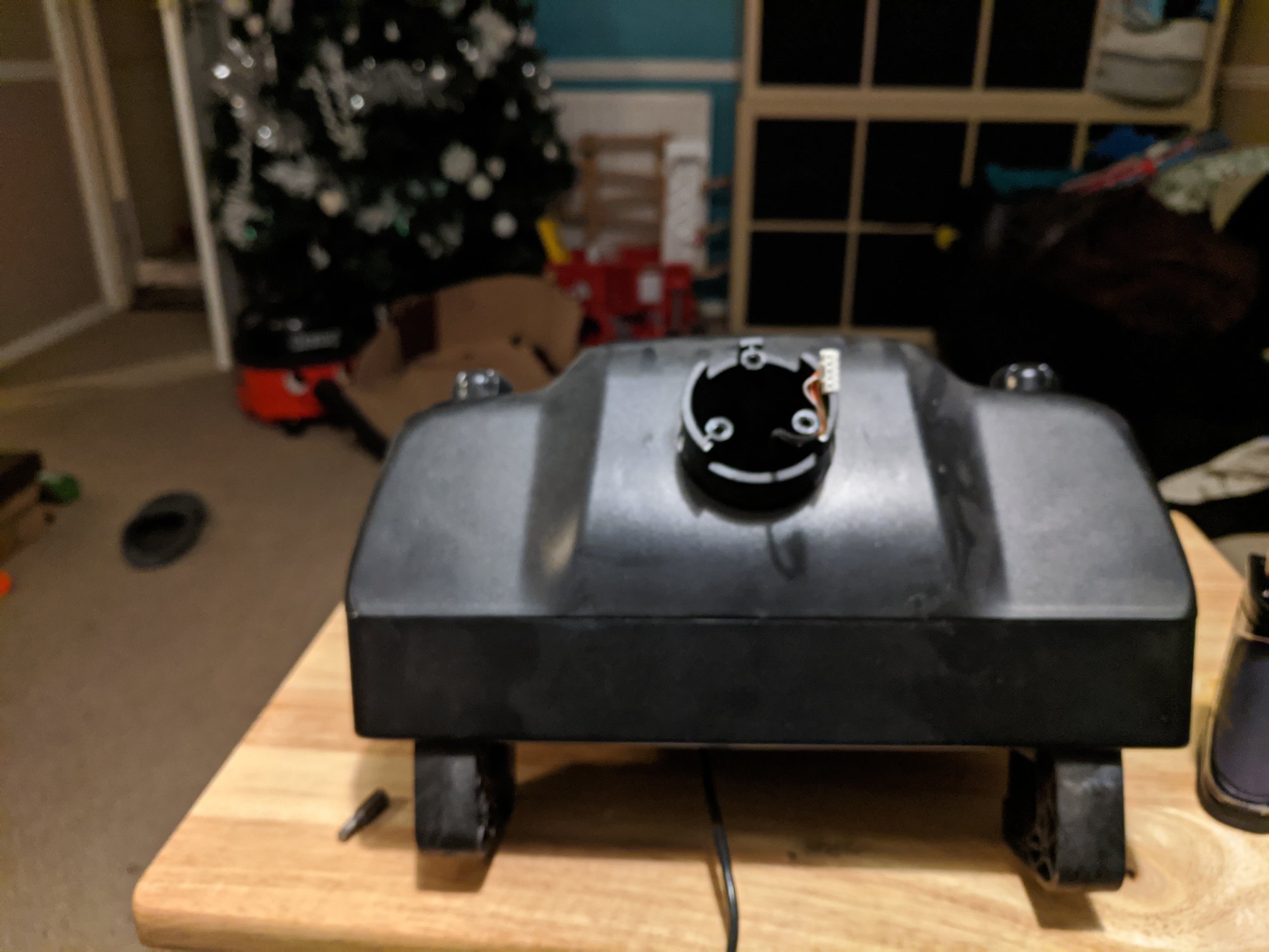

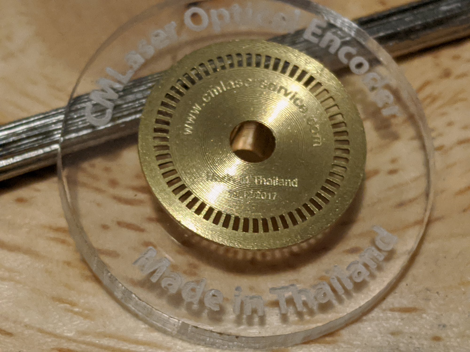

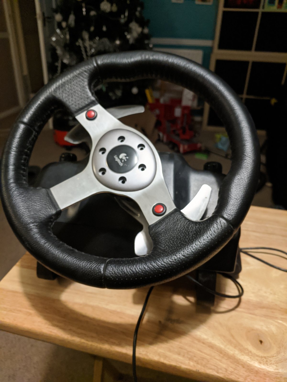

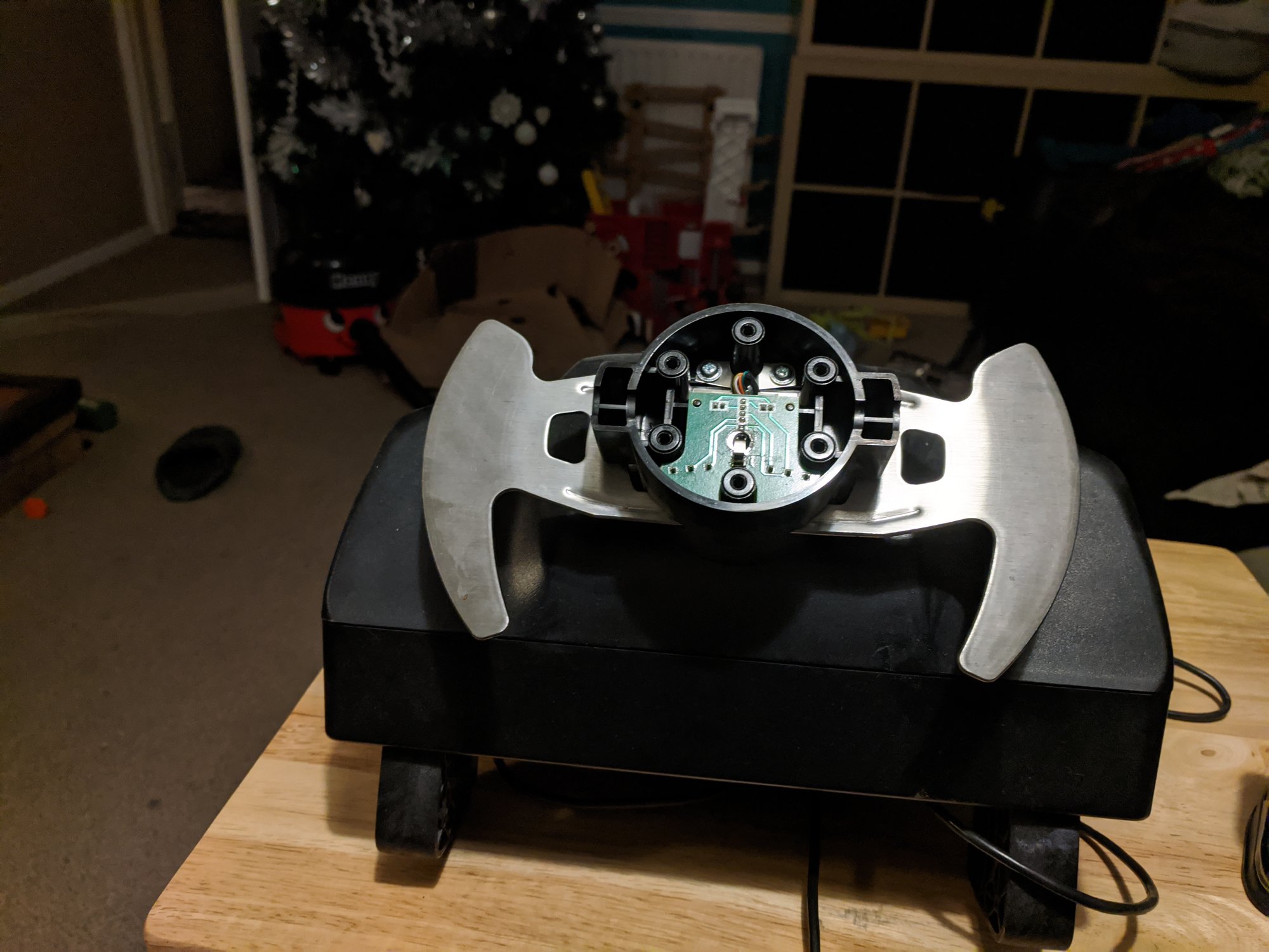

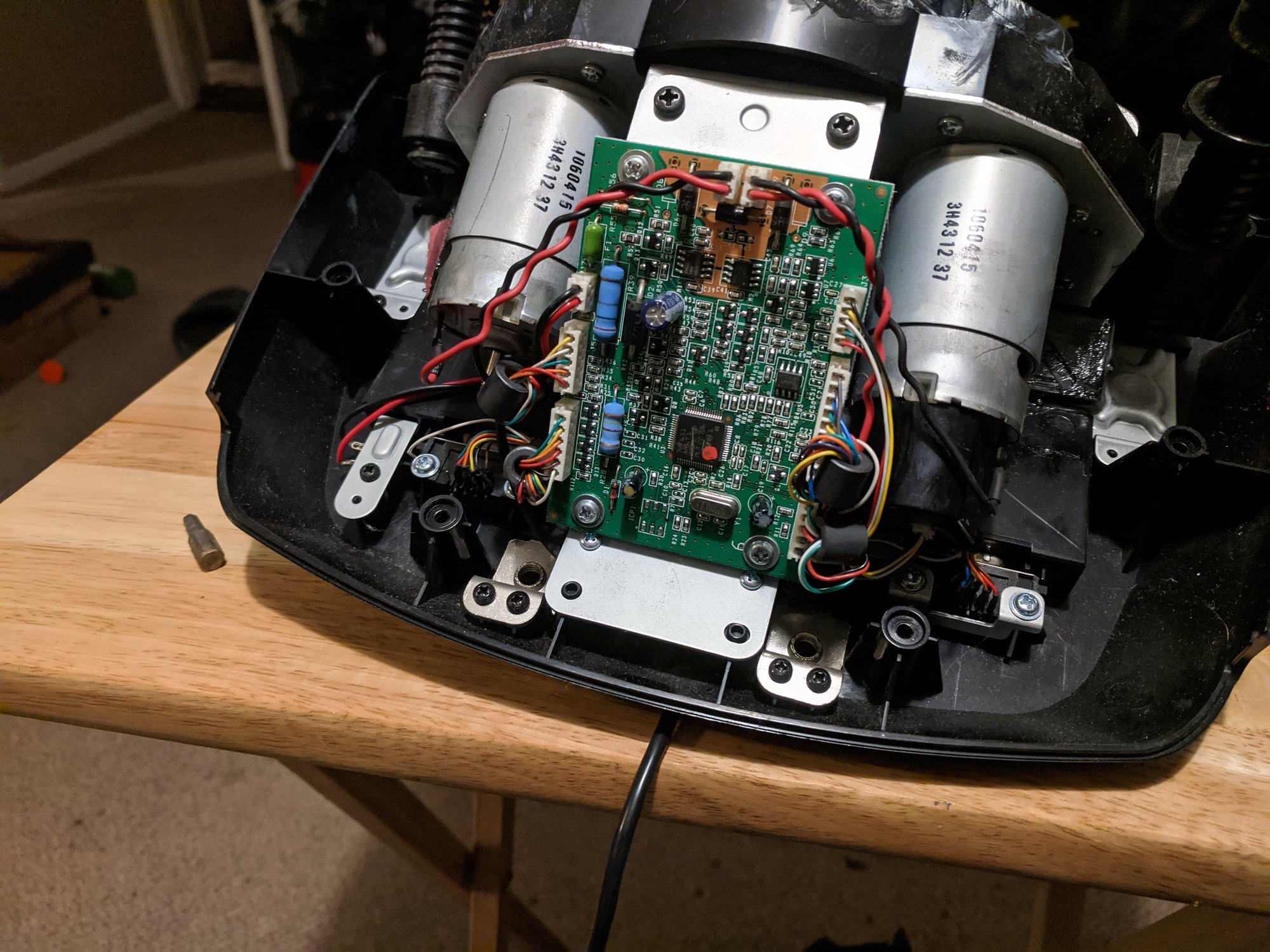

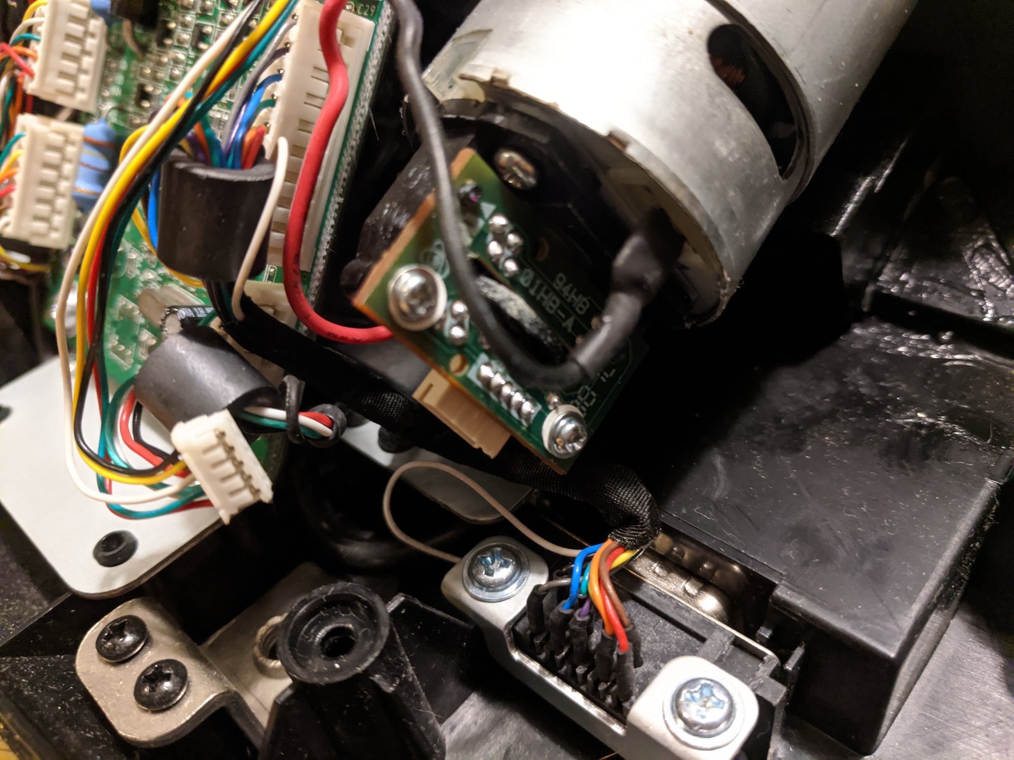

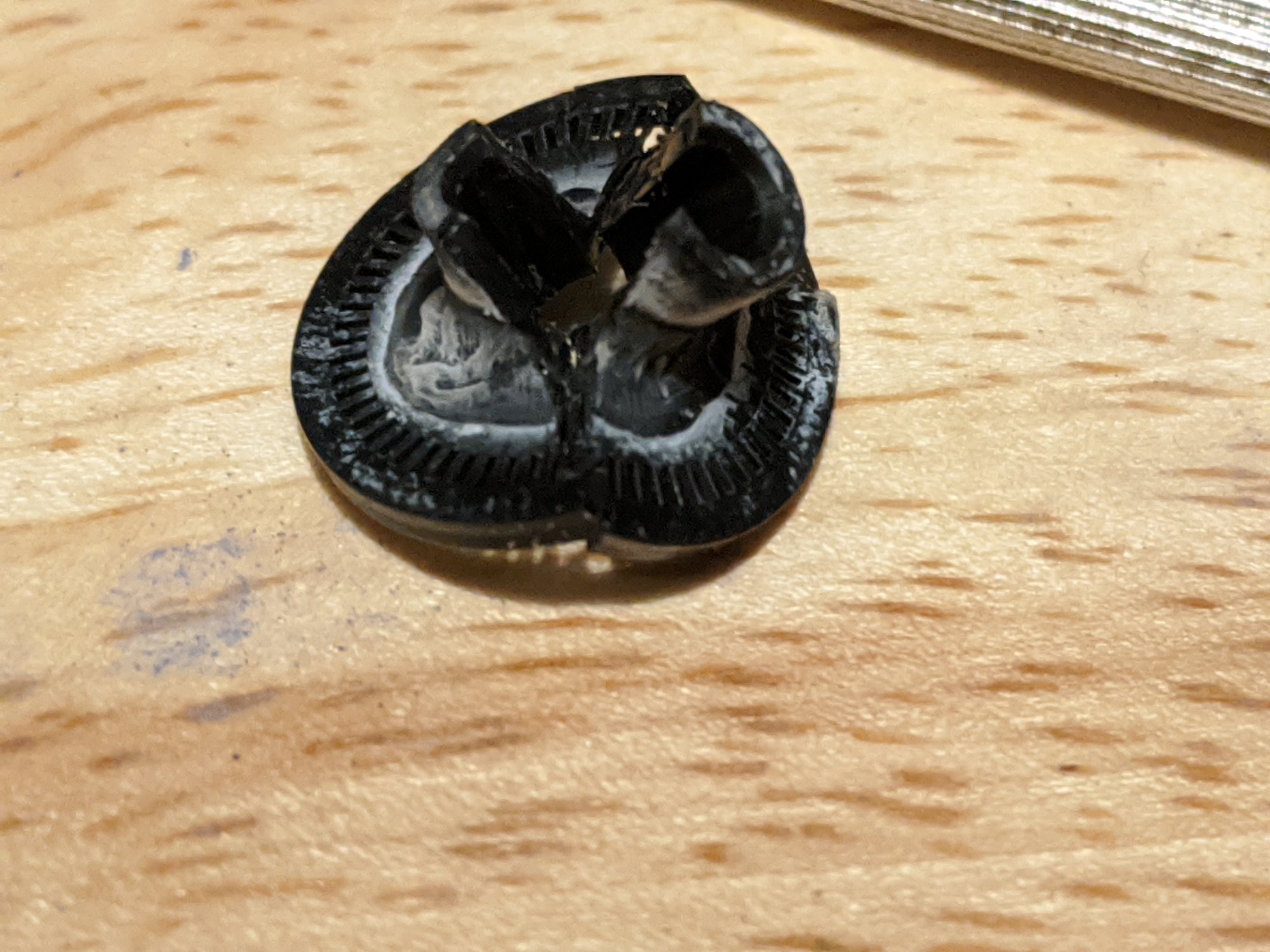

Not the psu. The rotary encoder. Given the cost of these new I wouldnt have expected them to be plastic but they are. The crack allowed the encoder to spin on the motor shaft stopping it calibrating and zero hid input.
Some careful supergluing and its alive. $38 for a brass replacment from thailand. Proven to work so not the end of the world. No way I could machine it myself. View attachment 127584
http://cmlaserservice.com/page_g25_g27_optical_encoder_wheel.html
