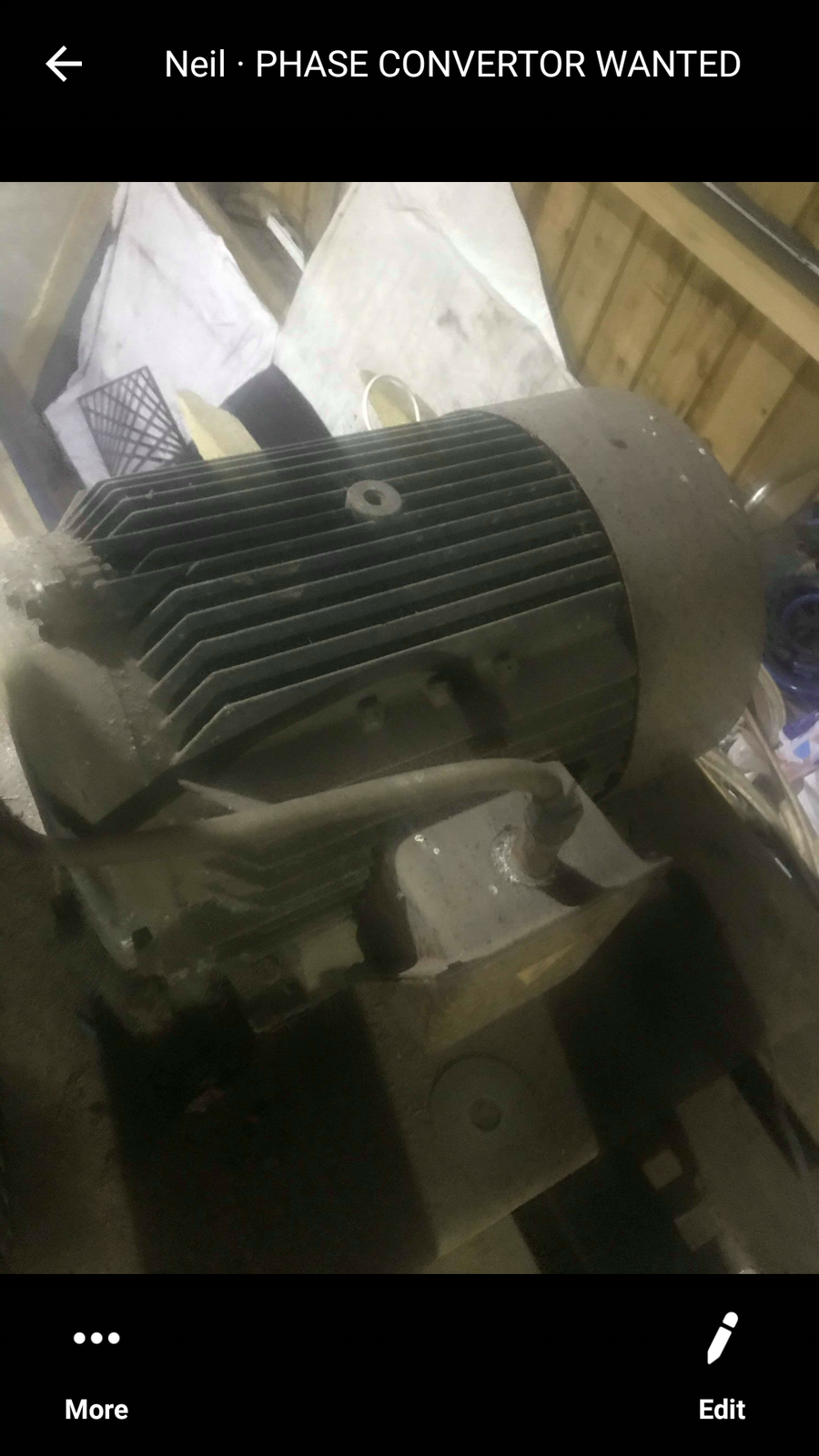

I don't think I can run the motor off a VFD. The photo isn't very good but it states 400v. It doesn't seem to be dual voltage so I think I will have to swap that out. I think I would like to get a dual voltage 3phase motor and play around with a VFD rather that get a single phase motor. I wont have to upset the rest of the control wiring that way.
Can anyone confirm whether the motor is no use to me?

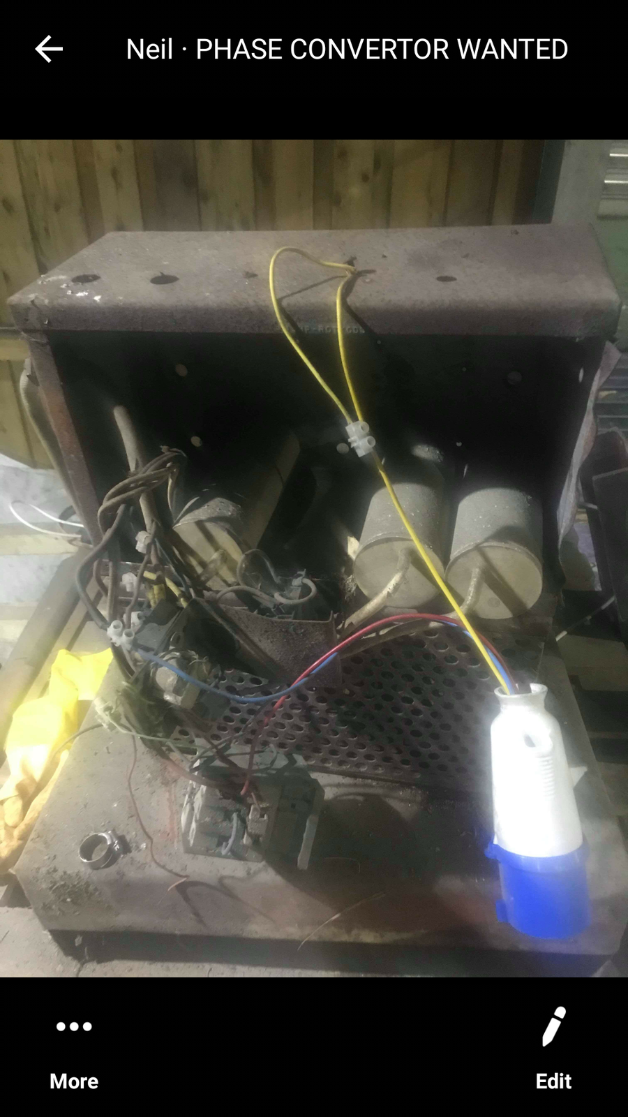

Is that also a step up-converter?Today I acquired a 15hp rotary phase converter, for £100 someone had purchased it with a fault and played with it and got stuck and left it , I've had a quick play and stripped alot of the doggy wiring away that had been lodged around the relay etc stripped it back to the contactor and 3 transformers and manualy adding the start cap suprisngly it runs silky sweet needs some run caps as the voltages are a bit out but I'm happy weights a stupid amount ,
VFD isn't a good way to give power to different loads (example you are already using the drill mill and you start on a bench grinder)it will take off the power .You will have to modify the control wiring. VFDs do not like having their output disconnected when live. You will let the magic smoke out. However, it's well worth having the VFD.
For simplicity a rotary converter will run everything as is via the main supply to the machine.Great advice.Thank you. You might have saved me some money and grief there. I did a bit of reading up on vfds last night. As a short term economy measure I will fit a vfd directly to the motor as its is. I believe it will run with some reduced fuctionality. I'd add a link but im typing this from a phone. I think I can get the same torque but at a reduced running speed. That will allow me to get the mill running and allow me to have a play.Will get the motor looked at at a later date. Theres a goog thread on here about pulling out the star points on a motor but I'll leave that to someone who knows what they're doing.
Can you draw a wiring diagram of your converter as I can improve my design and save me money and time?Yes it's a step up single 240 feeds a bank of three transformers in parallel out into the motor and 3bbig unknown size caps for starting running like that phatom phase is at 385 ISH put a. 100 if cap from L1 to L3 and it stabizes around 417 just had it running my Tec arc inverter set on stick welded sweet
