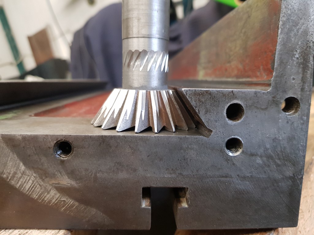

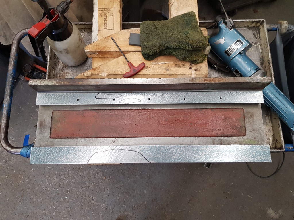

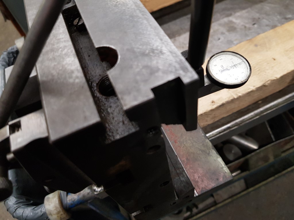

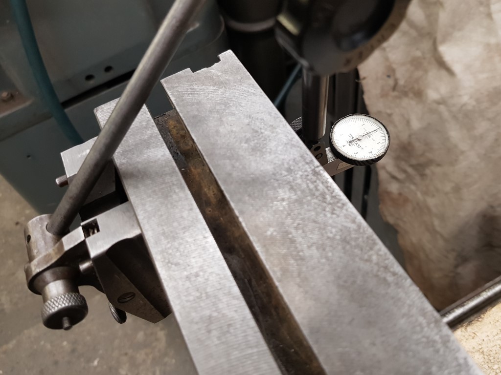

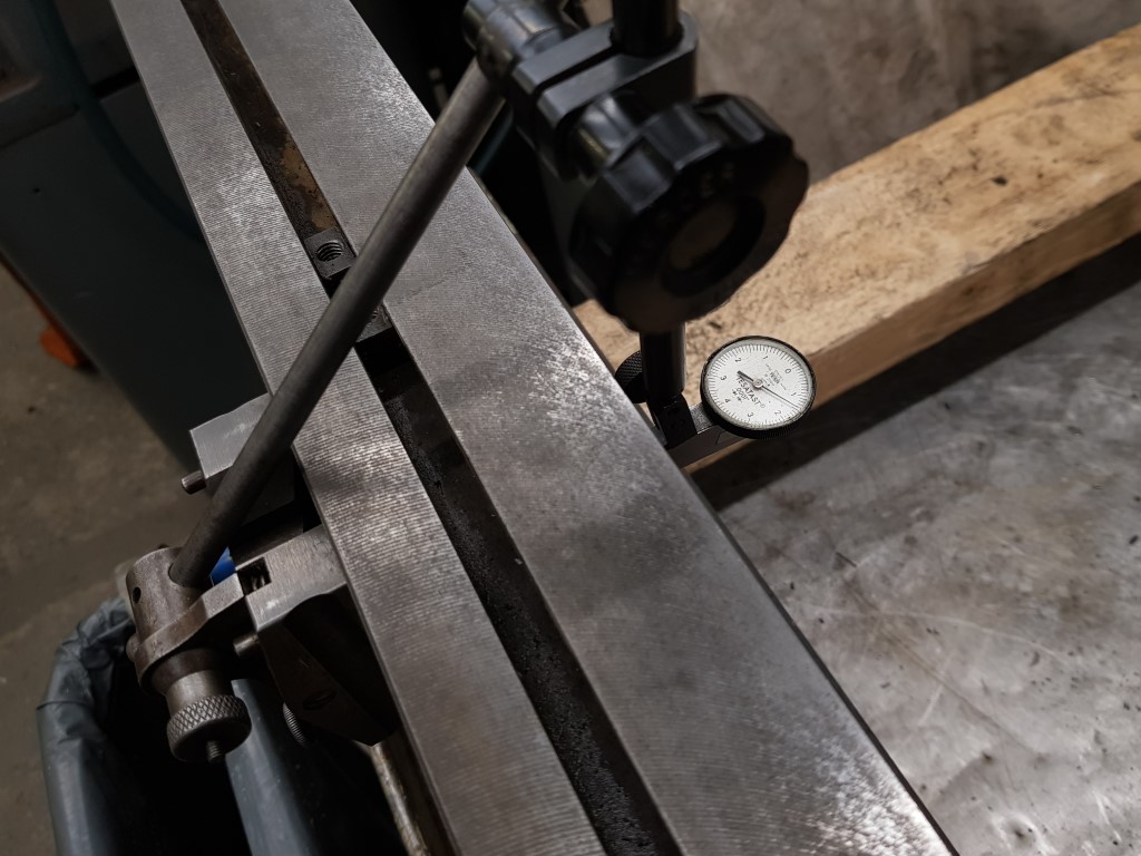

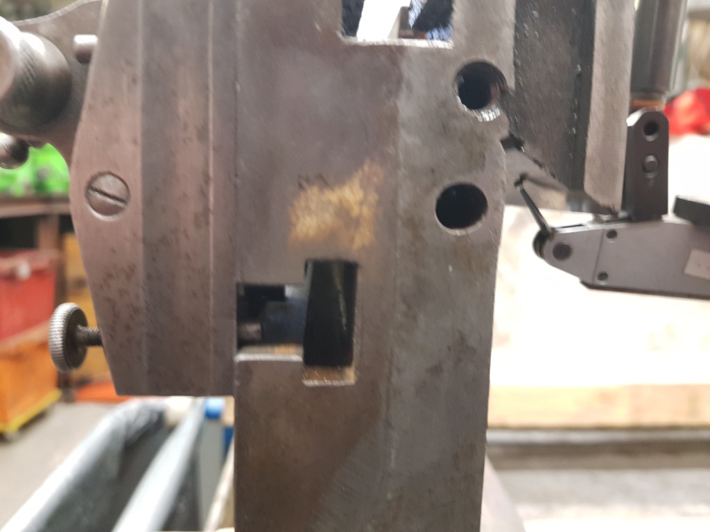

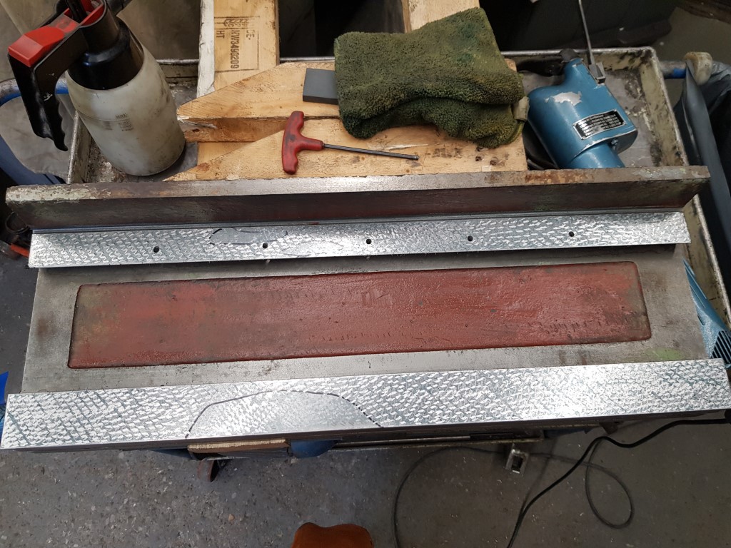

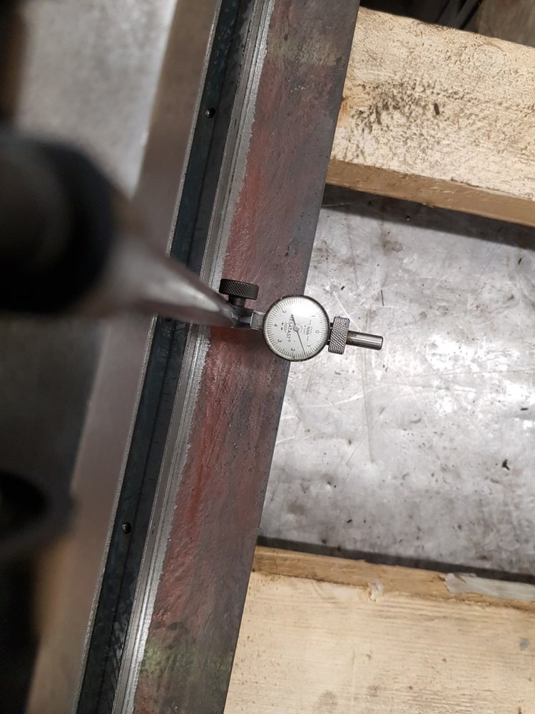

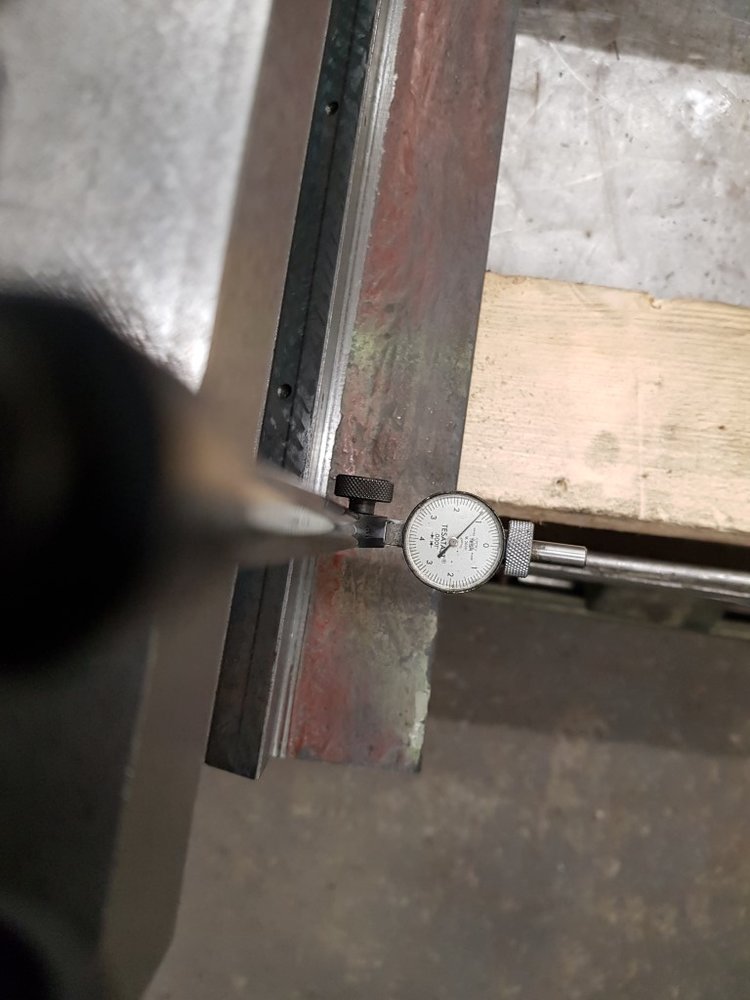

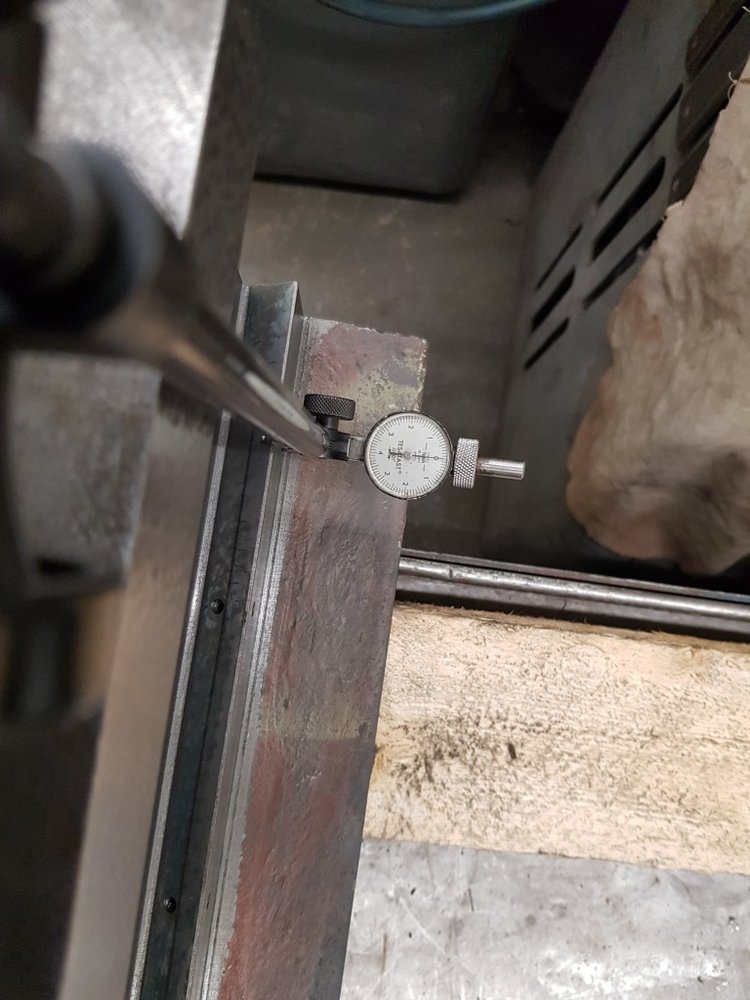

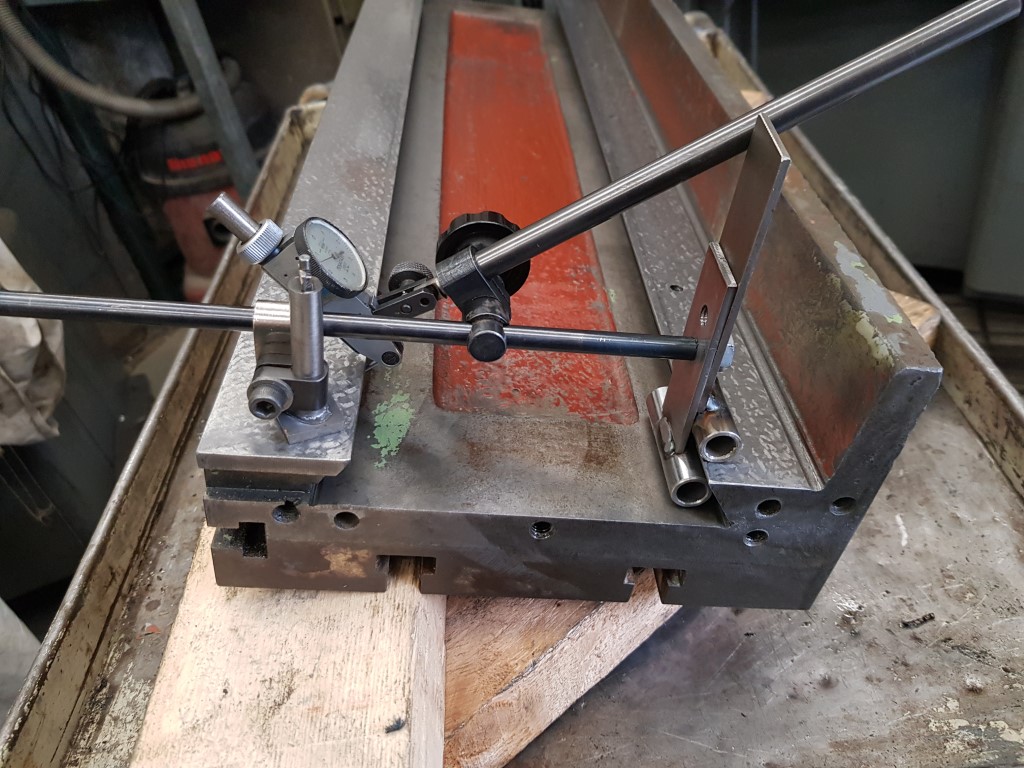

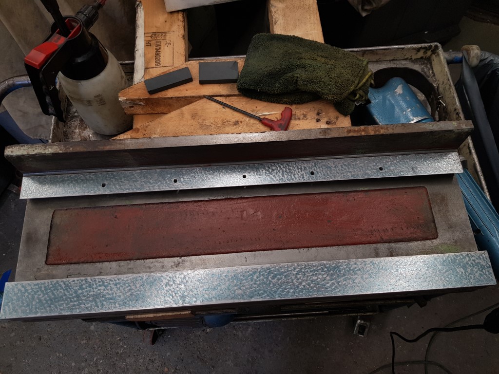

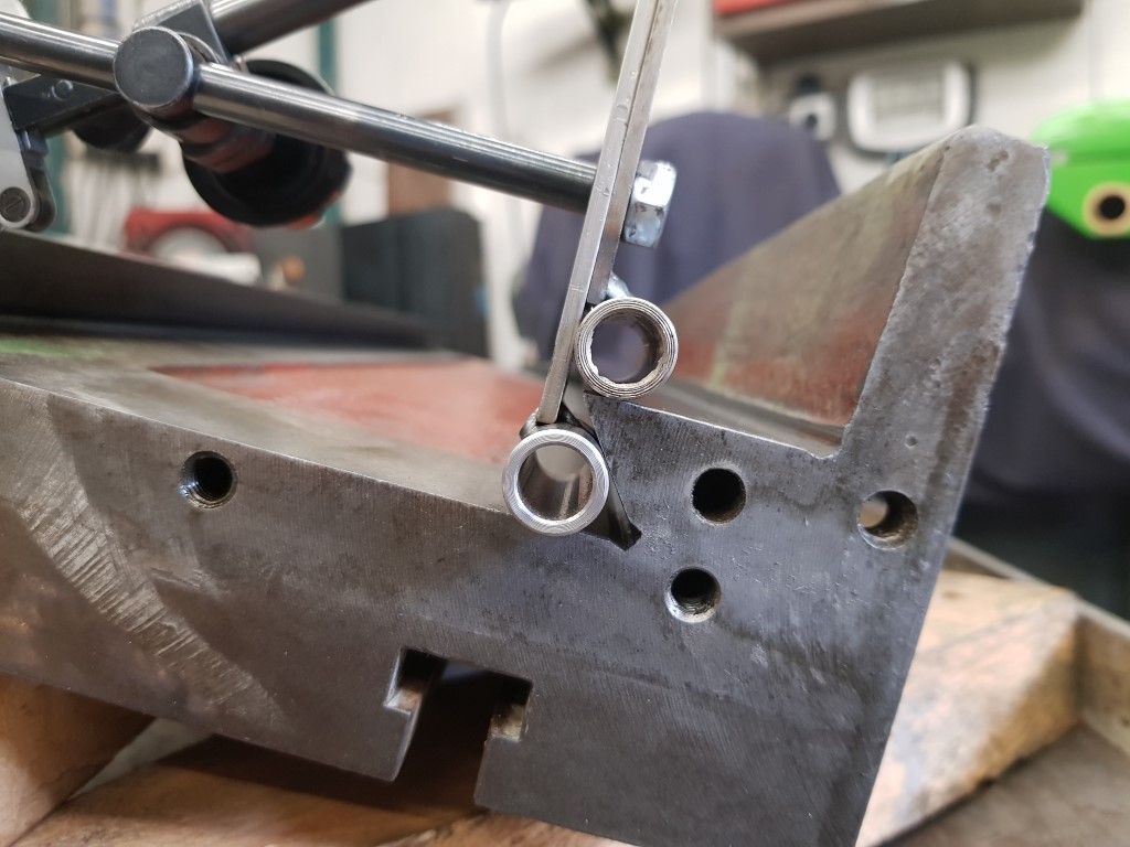

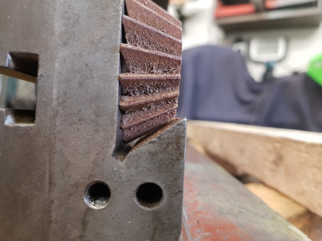

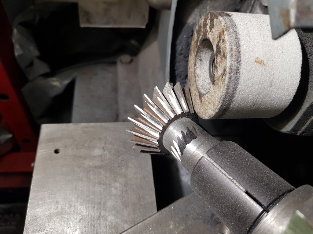

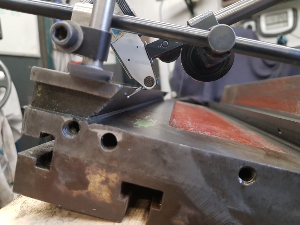

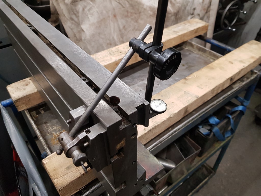

I could not help myself I had to scrape out that half thou taper. I got to thinking that since the most of the wear I scraped out was at the front, being already slightly tight at the back would only get worse with wear. So I got it down to a tenth or two (hard to tell when the needle reacts that much to the scrape marks). The Y slide now moves very smoothly with no evidence of tightening up as before.
