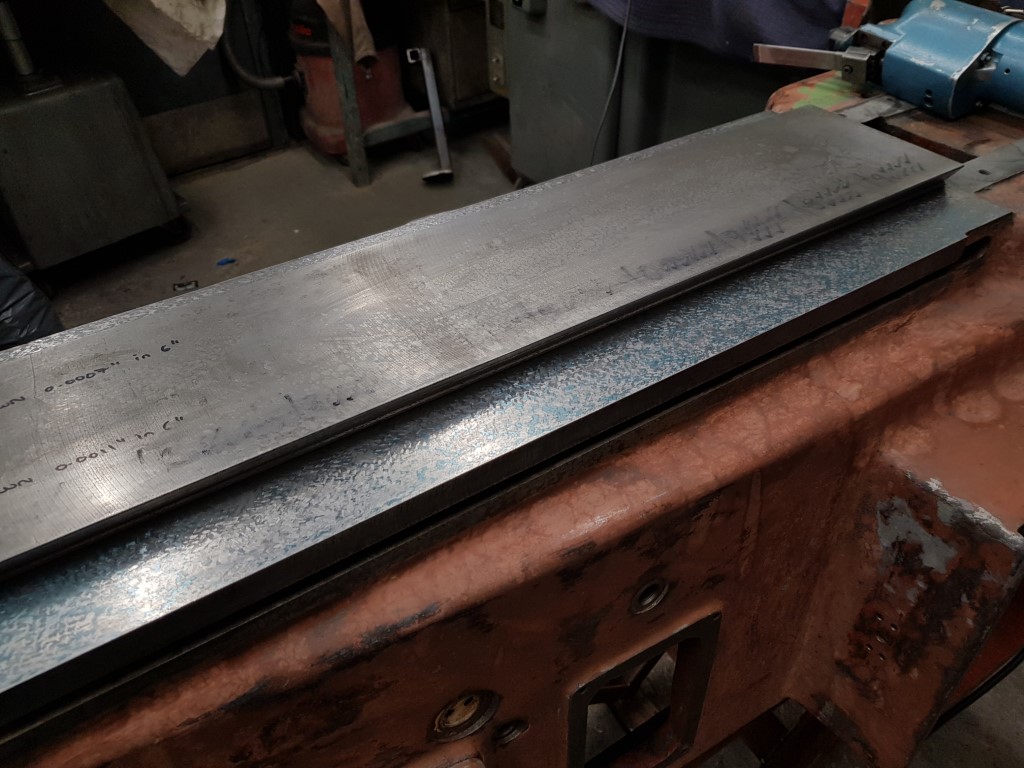

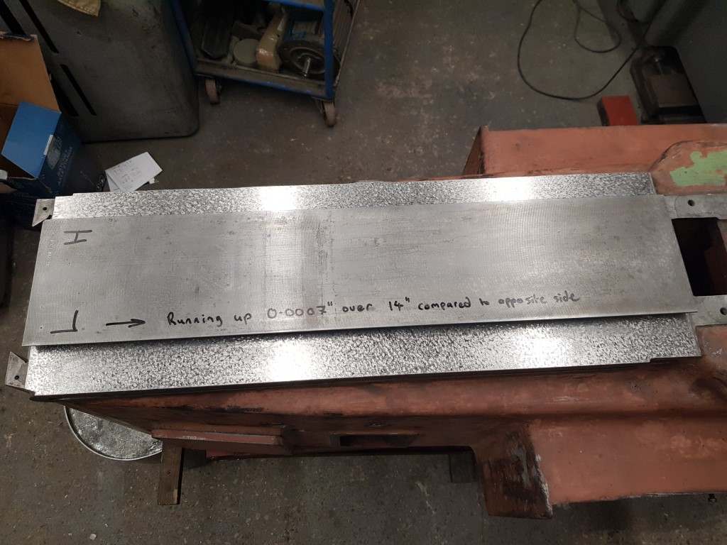

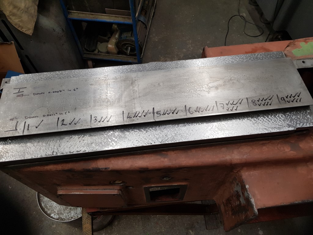

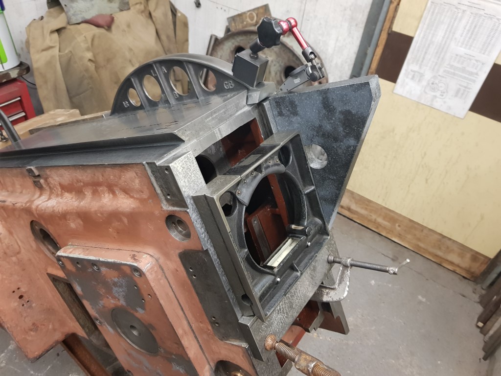

If it wasn't so damned difficult to move I'd... ...plane the front flat.

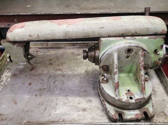

If you cannot take the casting to the planer, can you take the cutting tool to the casting and machine it in-situ?
If you fit the Z- and X-axes, you have something that moves up, down, left and right under precise control to which you could mount a cutting tool of some sort.
The big issue would be that it would not cover the whole surface in one setup. However, if whatever it is could be rotated 180 degrees, it could be made to do so.

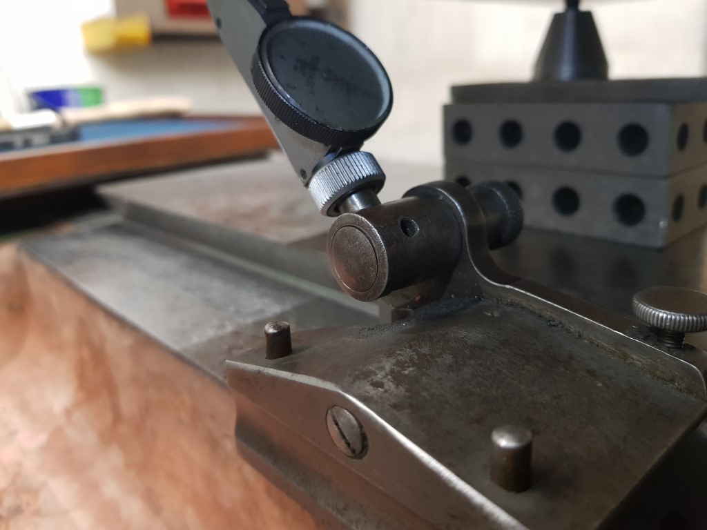

Imagine a cutting tool in the spindle of the dividing head below (with the overarm and outboard support removed). With the two rotational adjustments on the angle plate, you can point the sharp end of the tool at every point of the surface you want to machine.
If you can find a way to mount it, the powered spindle below would do. Where it attaches to the Y-axis is a reference surface and if that surface is fixed to your X-axis, it is rigid enough and long enough to be able to overhang and use a flycutter.
