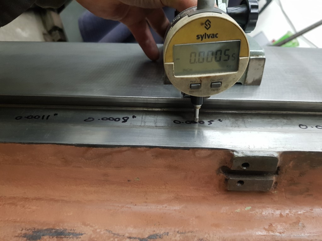

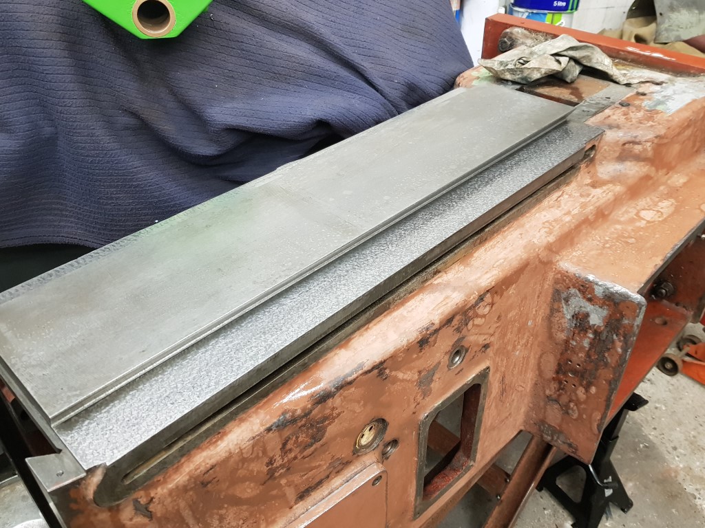

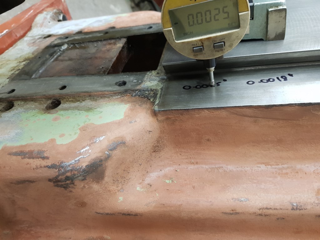

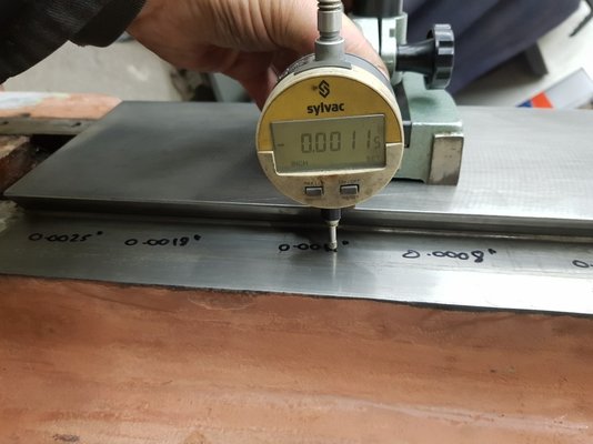

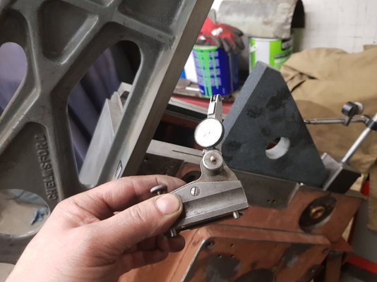

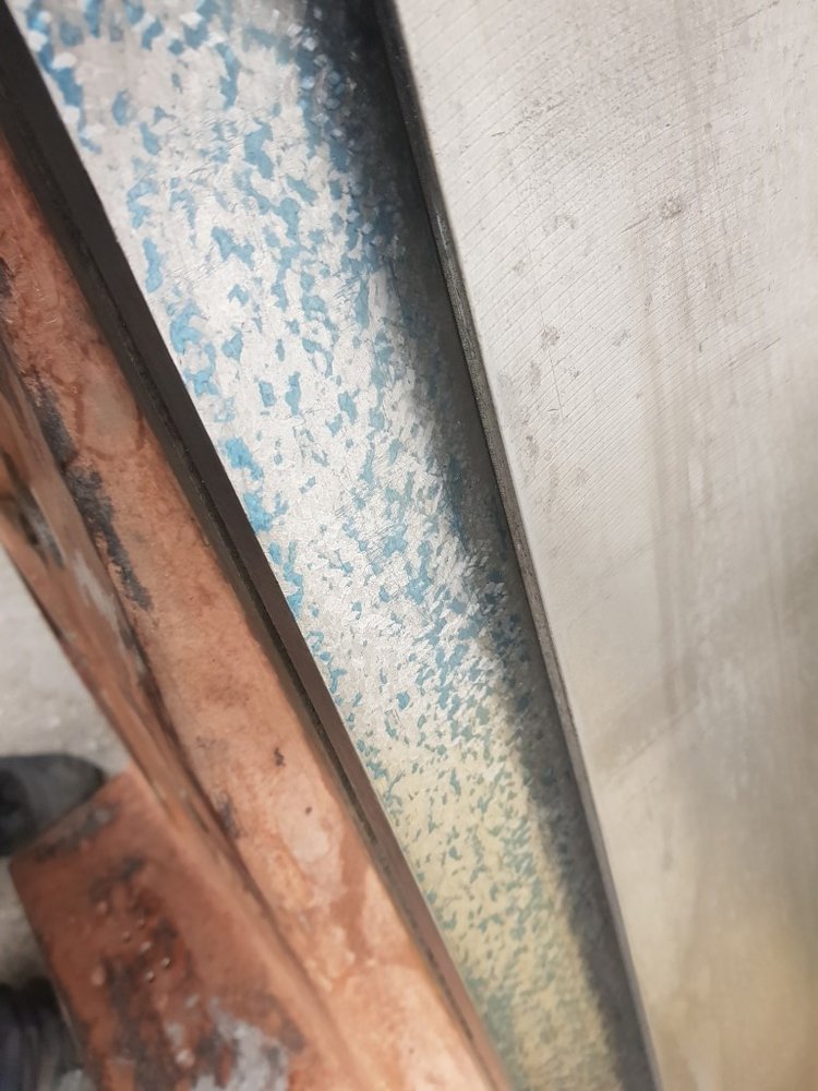

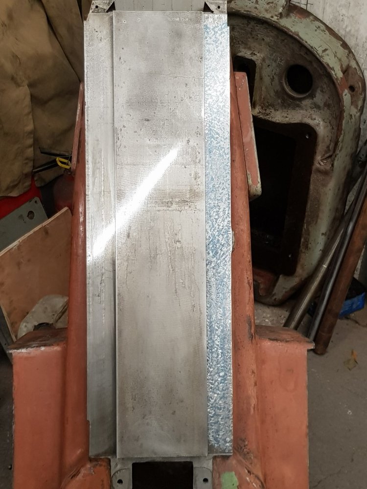

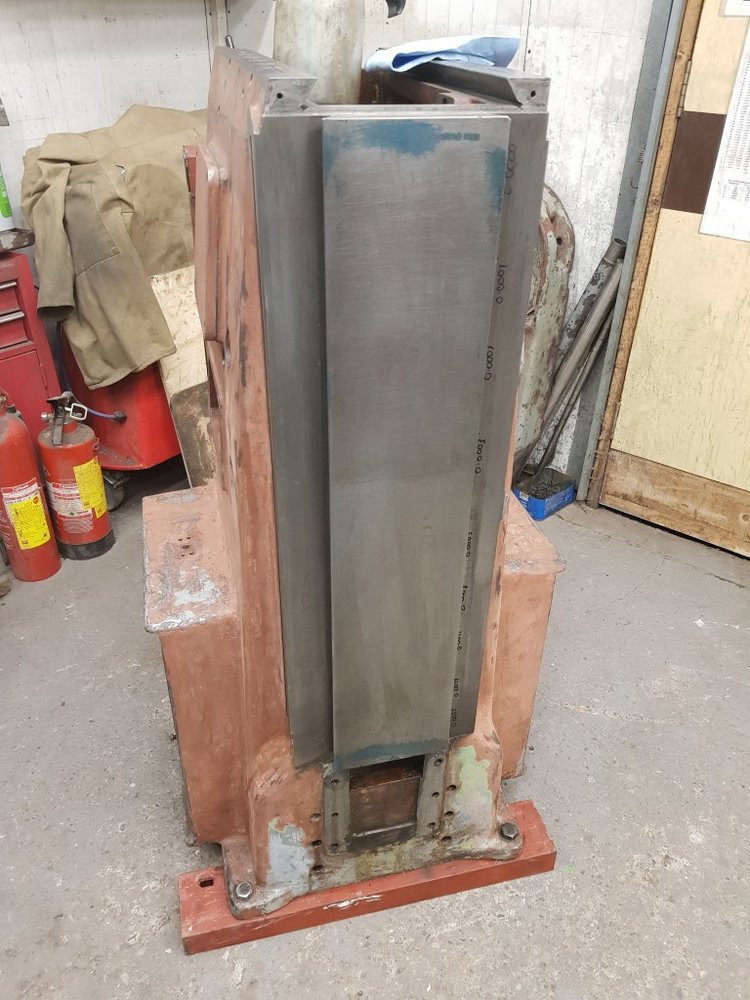

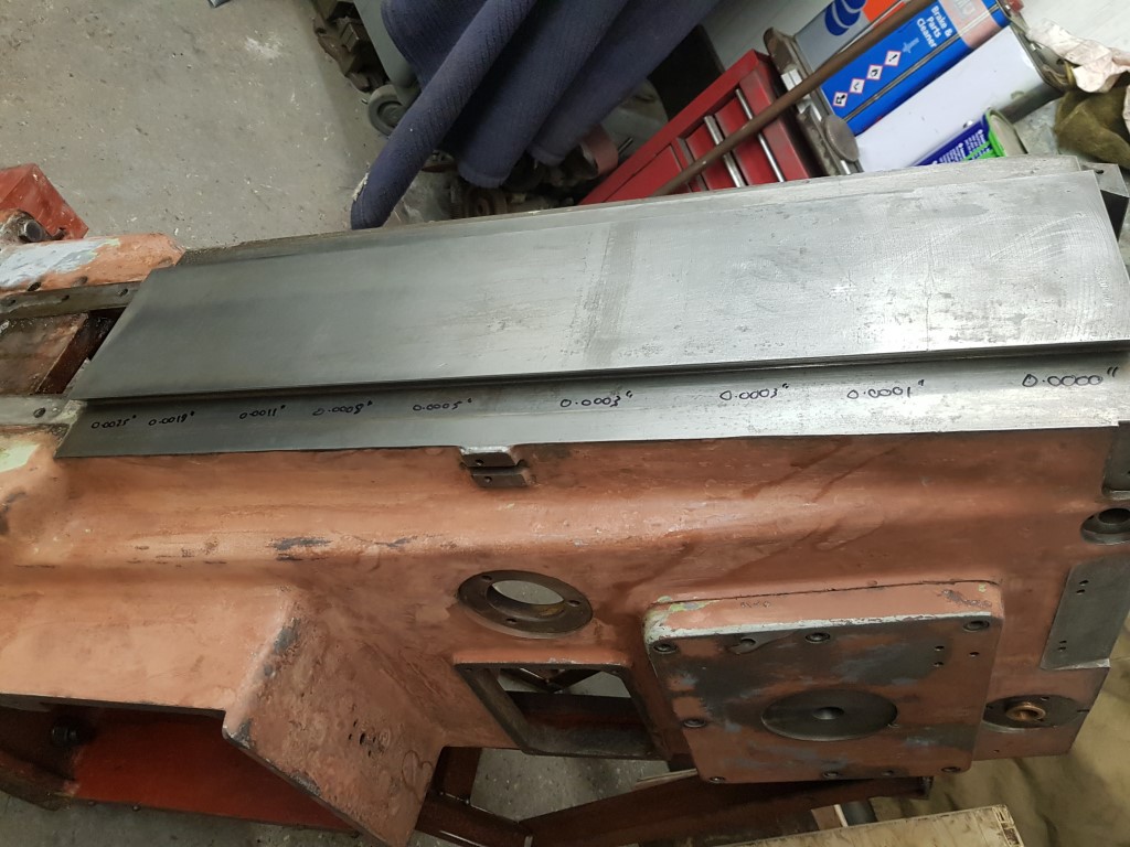

How will you ensure you do not change the alignment/geometry of the vertical ways? To the x and the y axis?
Very surprised how a lateral moving part can wear so much over time..guess the secrete to longevity is oil,oil,oil on the ways.

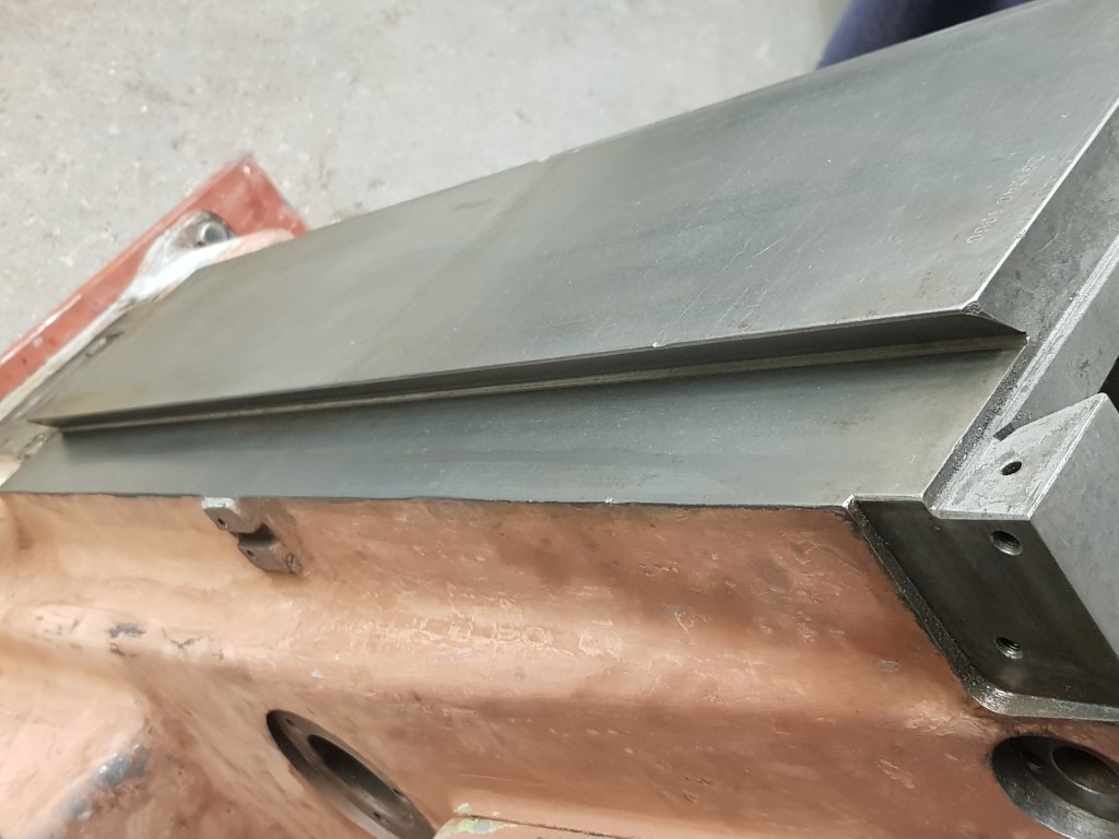

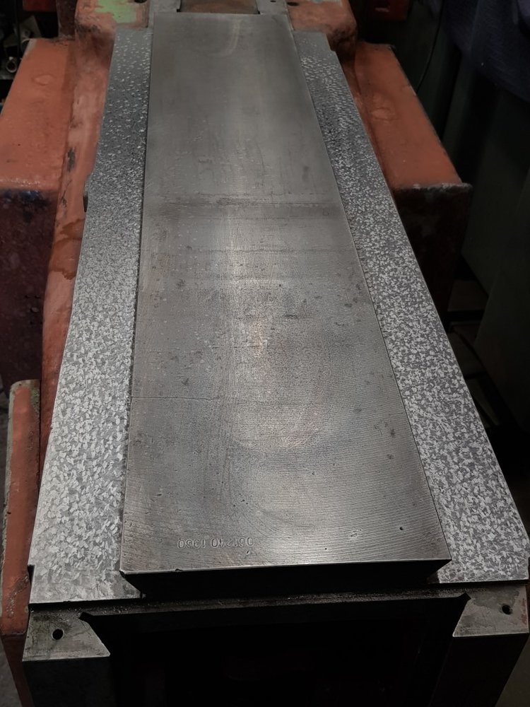

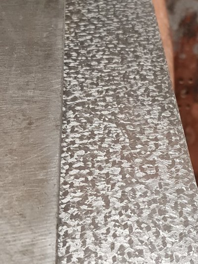

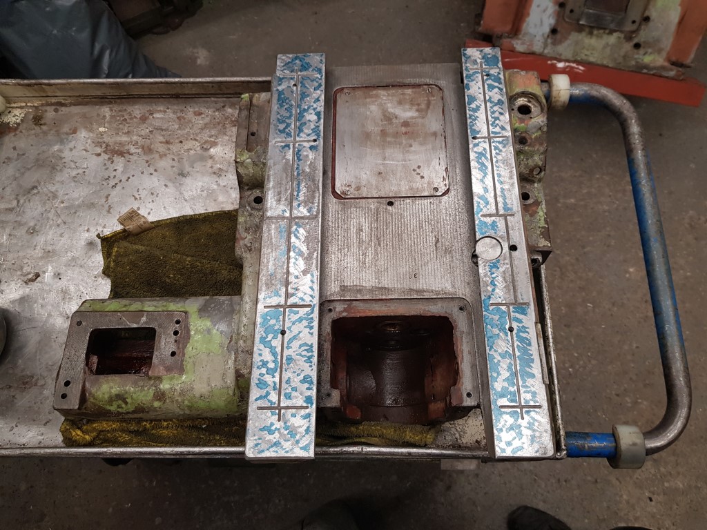

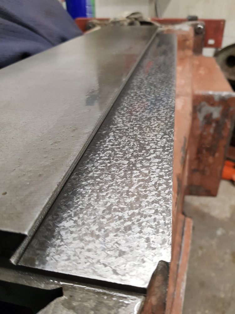

Are they shaper tooling marks in the recess?

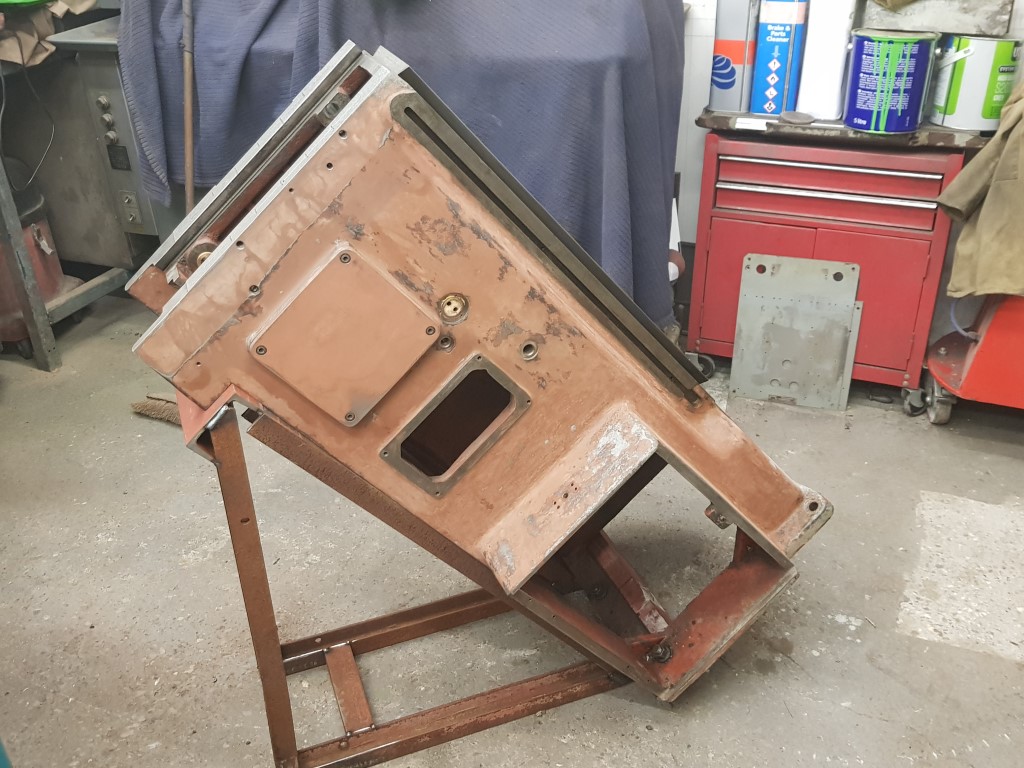

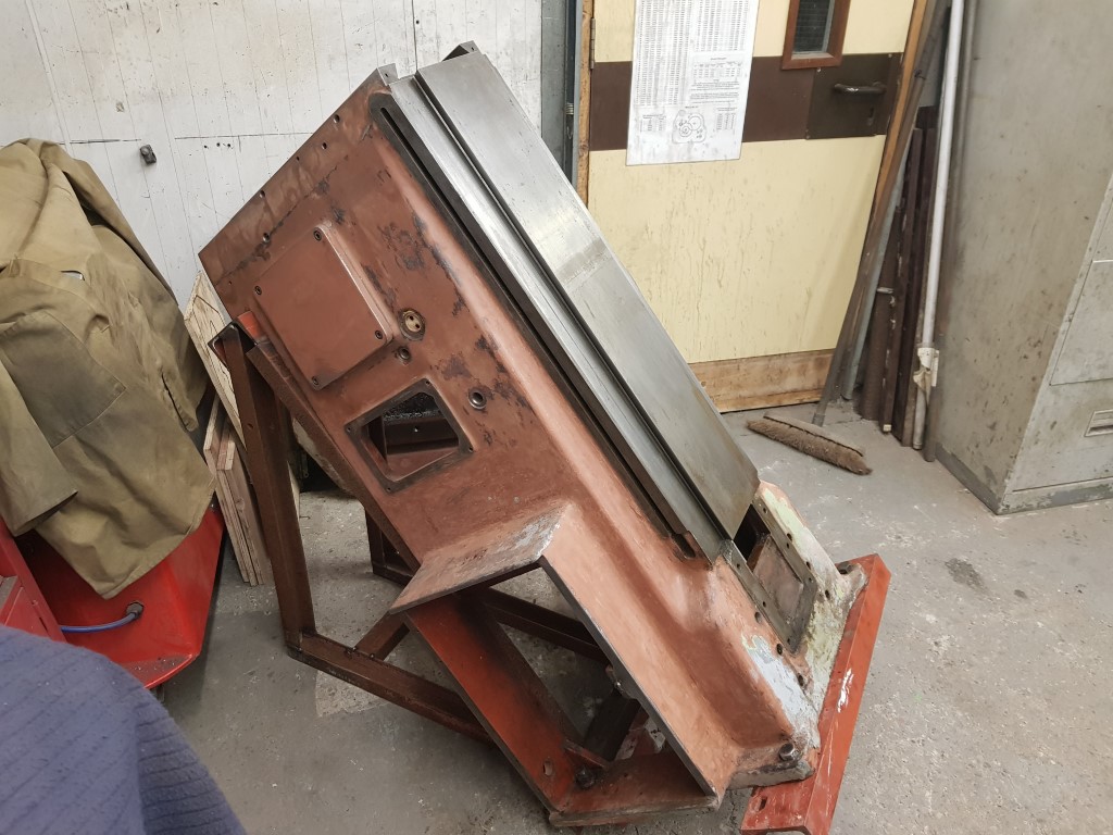

It'll be better than new when you've finished Pete,
I hope that the back recovers.
