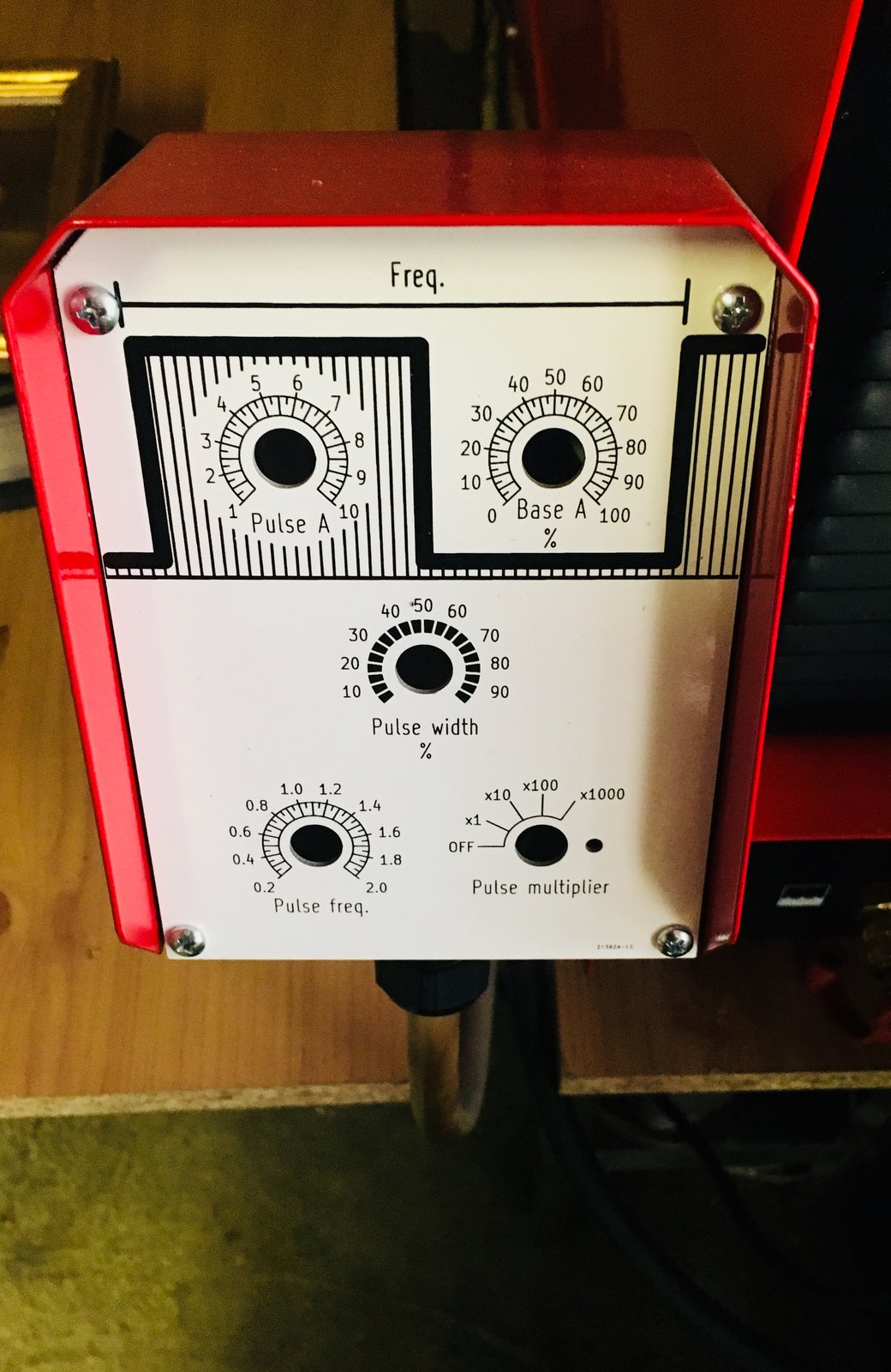

Yeah not so bad mate. Should get this pulse remote tested tomorrow now the multicore cable is here, RS royally let me down on that one. The connector I decided on for the board meant I was limited to .5mm2 size cable, surprisingly hard to find a 10 core that wasn't 4 quid a meter.How’s the trans tig treating you Hugh?

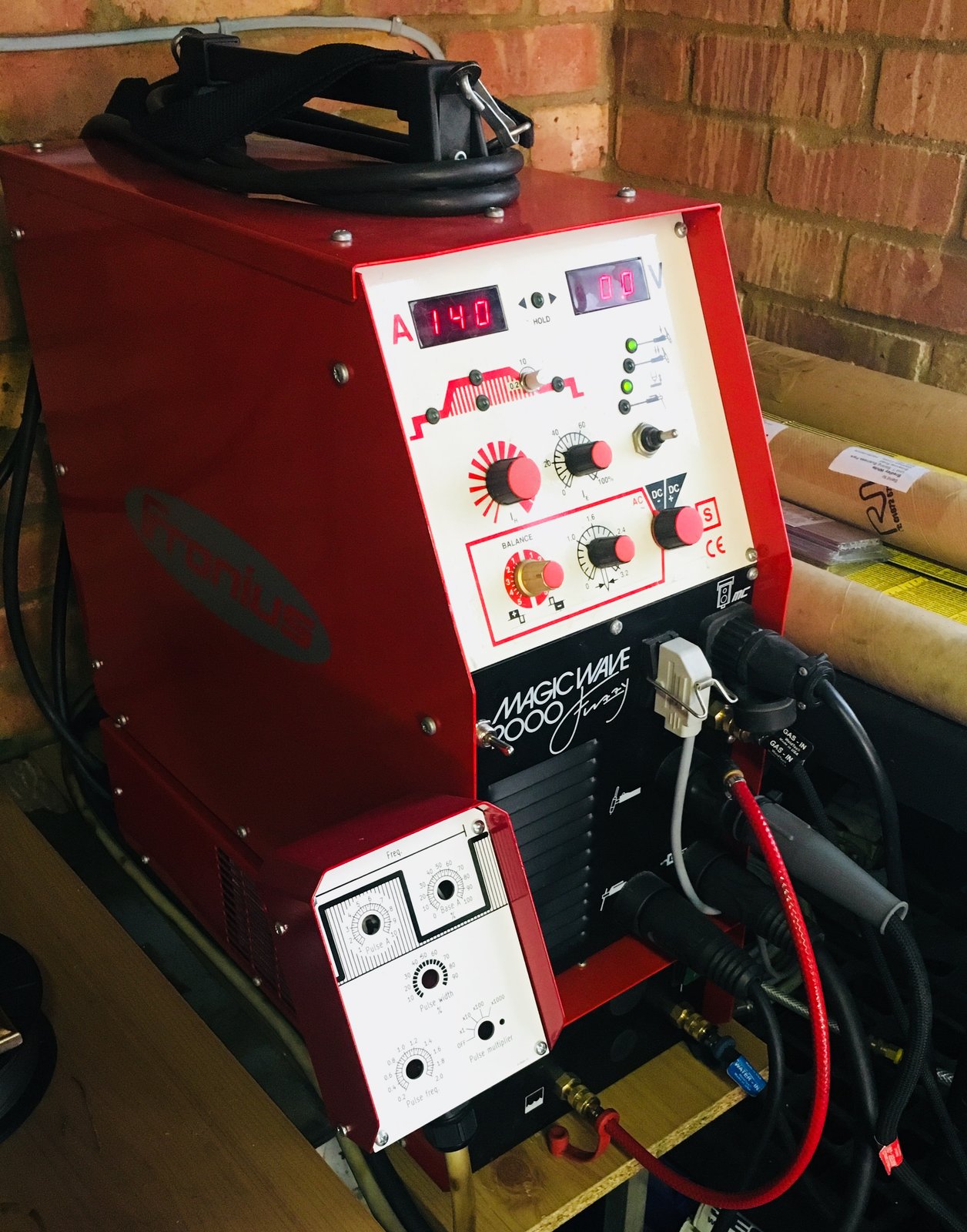

Hi I'm assuming that the MW2000 is the same as the Castotig 2002!!, could you give me a pinout for the Castotig 7 pin Torch Connection, I've fitted a WP26 torch and only need the trigger pins for on/offI can drop down and then come back up again in 4t, I never use 2t anymore, makes my fingers sore.
I'm not sure how to set it to a straight click up/down, there is a 2t and 4t special mode mentioned in the back menu.
Oh, and inside the case of mine is a mw2000 circuit diagram with the pinouts and description of the torch connection. I'll scan it and upload it to my album.
Thanks Hugh, Think I got it figured Pins 2 and 4 are the trigger for the torch, I have a remote RCT-F Pedal also and the control pins on the pedal are B and D for microswitch and A, E and F for the Potentiometer, don't know how these line up with the 10 pin plug on the machine though, hope you can help with that.Ill sort this tomorrow for you

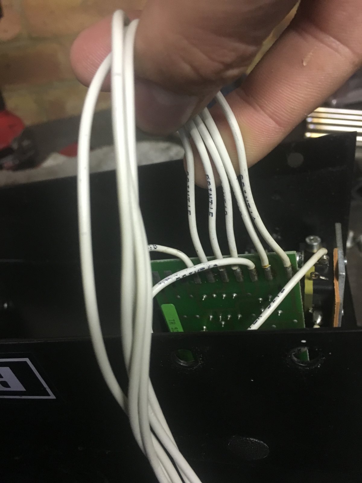

Nope the plug has been removed from the pedal for some reason, these usually come with a plug at either end of the cable with an identical plug on the pedal as fitted to the machine (plastic male 10 pin panel plug) but this one has a cable gland fitted at the Pedal end with the wires soldered directly to the pedal PCB with the wire numbers 1, 2, 3, 4 and 5 connected to the PCB A, B, D, E and F. and no plug on the machine end of the cable.Alex what do you mean by don’t know how they line up on the machine?
Doesn’t the pedal have a plug fitted.

Can't get that to work, when I switch the machine on the HF starts with the plug connected and there is no response from the machine when the pedal is pressed, do you know if there are any links inside the plug on the machine end of the Pedal cable??There in alphabetical order mate
A on board is A pin on machine plug
B on board is B on plug and so on. Easy.
