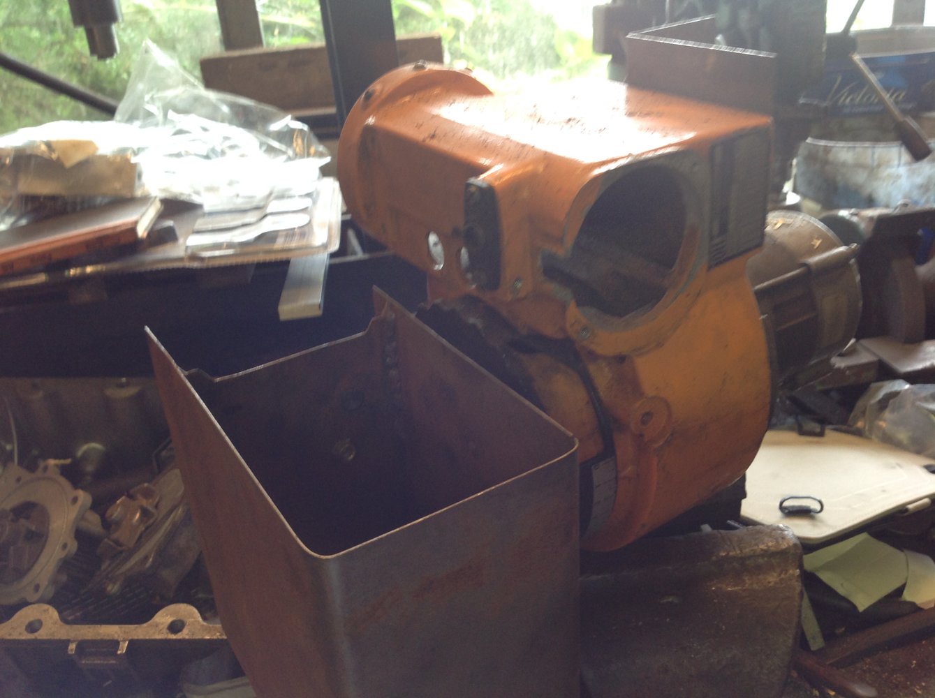

Get a grip - engineering a small enough one would be nigh on impossibleRotary cup type burner will be best for burning slugey rubbish.
agreed, keeping me out of the pub would be a good start though.....

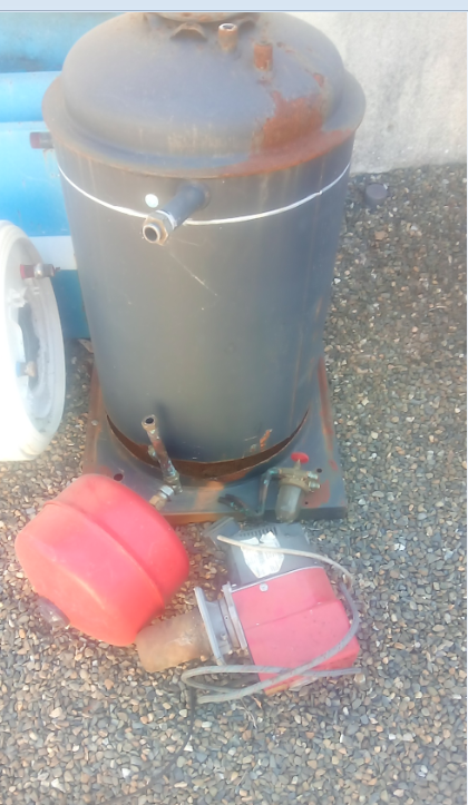

aye of course youre right, I've never been one to miss a good opportunity to overcomplicate simple things. I did think of just running it on pure diesel, and it'd be basically ready to run, but where's the fun in that...... besides we have lots of waste oil, inherited on the farm, and plenty more from all round me, so why not....
I think my "bouncy castle" blower thing is 400w. It produces more air than is needed!
So not battery powered, but a whole load different to having a 3kw compressor cycling away.
You won't run a pressure jet burner on anything but diesel or heating oil. Even preheating and filtering waste oil would be a pain in the but unreliable. That's why the commercial wo burners use delavan vacuum jets.@8ob Aye, same sort of thinking, don't really want to have compressed air if I can avoid it. My thinking was to get the oil hot and fluid enough after start up to be able to run on the burners own pump to the nozzle albeit probably with a booster pump from the tank, eventually passing the lines near the exhaust gasses. won't be a smelter anyway, only a foundry so won't need gigawatts of power anyway.. should be able to get it to a workable solution. Like most things, the complicated part is making it simple... All food for thought..
you mean the ozirt burnerThat Irish lad on YT does a simple build. Starts it by setting fire to an oily rag from memory then just dripping the wo into the burner pan. Hasn't he been discussed on here before? Might even be a member here?
