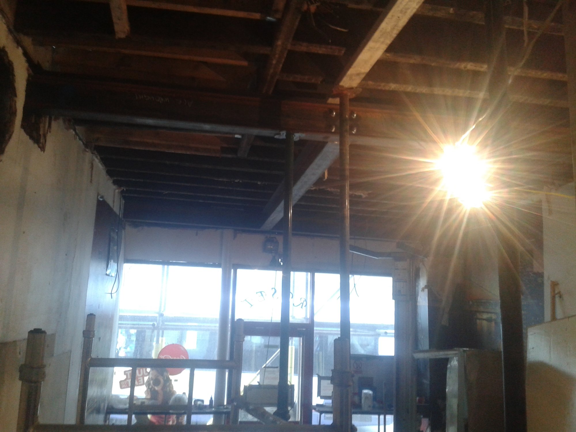

Total disaster waiting to happen, Get a building inspector involved, and hope that he knows what a sound weld looks like.
As i read this thread that is exactly what i was thinking, Acrows tomorrow and a structural engineer Monday morning.I'd be getting some Acrow Props under those beams until its properly inspected.
I must admit I find this whole thing down right dangerous and stupid and I'm not supriseds we don't here of lots of catadioptric failures as a result.
I'll see what the building inspector says but suspect he will just say speak to a structural engineer as that's all he's obliged to do.
However having tried to contact my engineer, who's also useless, he's not responding.
I'm now trying to search for welding inspectors but have no idea who to contact.
I know a bad weld is not necessarily an unsafe one, even a half decent weld will carry a lot of KN, however I'm still not comfortable with the way this has been done with absolutely no professional understanding of how important these connections are.

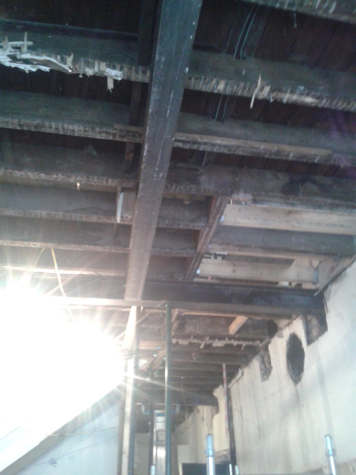

on your 6th photo it looks like the beams are sat on the top of the bottom flange of the beams running from back to front. If that is the case, and both ends of the beams are mounted like it then it takes awaythe worry of it falling down.
Shockingly bad welding though, and if the builder doesn't agree with that, then I'd be worried about that builder and what other corners has he been cutting down the line. I guess that they don't think the customer will look in any detail and notice these things. Good that you did .
If it were me, I would have a meeting with the builder and give him 2 options.
1. Get a proper welder in to rectify the problem to a suitable standard.
2. You'll get a proper welder in to rectify the problem and stop the cost from his fee.
3. If the steels with plates came in like that (I.e fabricated in a workshop) then ask him for a copy of the O&M manual ( this should include a copy of structural calcs amongst other key documents ) for the job as you need it for your buildings insurance. You'll soon find out whether the fabricator is CE certified or not.
The main thing in these situations is to sound like you know what you are talking about and don't take any BS off the builder.
Personally if the beams are sat on the bottom flanges , I would grind the welds out and use angle cleats on the end of the double beams to connect to the main beam. One each side , with the holes drilled and tapped in the web of the double beam as there is no access to the back as they are close together.
