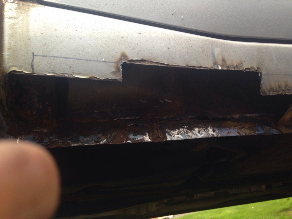

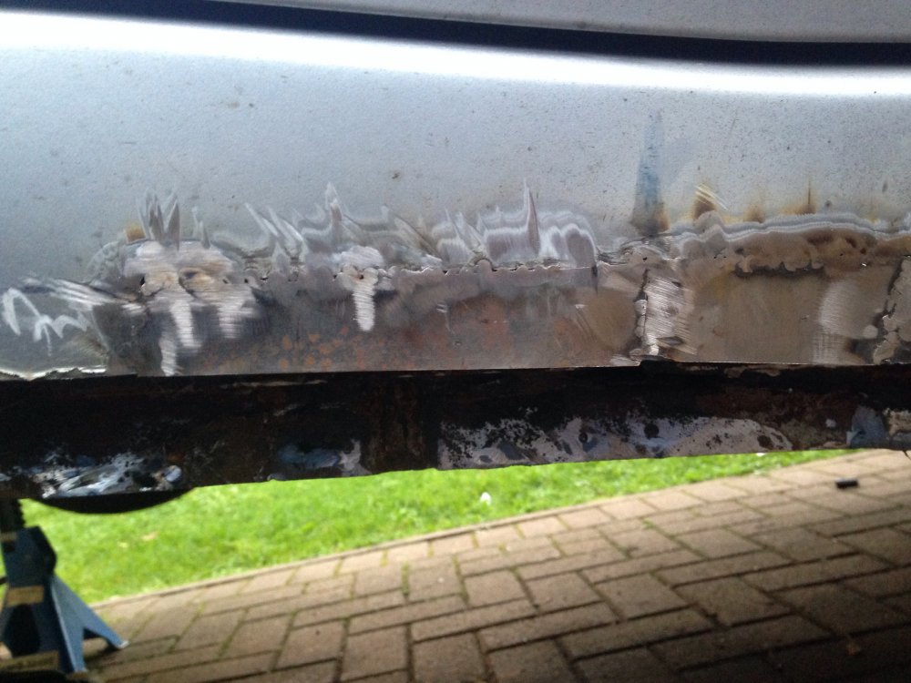

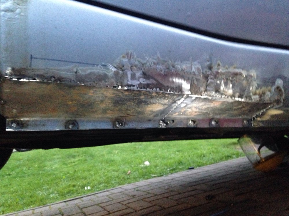

Only the bits of the patch that you have cut out and butt welded need to be a continuous seam weld, any parts of that patch that were spotted originally can still be spotted.
As a tester, I think I should know.
10. Acceptable methods of repair
It is essential that repairs to corroded or damaged areas are properly carried out. This requires that suitable materials of appropriate gauge or thickness are used for repairs. Additionally:
· Any plating or welding extends to a sound part of a load bearing member.
· the repair must appear to be virtually as strong as the original structure with only continuous seam welding being acceptable for patch repairs (even if the patch extends beyond the prescribed area).
· spot welded joints are acceptable where the original panel has been replaced to an existing spot welded flange (provided the original defective panel flange has been removed). Stitch or plug welding is acceptable as an alternative to spot welding in these cases.
· MIG brazing, a combination of adhesive bonding and riveting, or amalgamations of these with other joining methods may be the vehicle manufacturers recommended method of repair. Such repairs must therefore be accepted unless they are clearly inadequate.

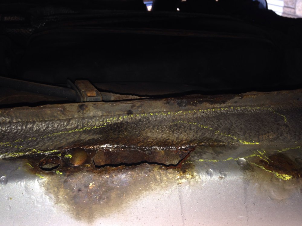

the Corrosion Assessment Tool is a little plastic hammer with an aluminium handle for scraping rust off brake pipesHaving identified the important load bearing members and ‘prescribed areas’ on a vehicle, the tester should determine whether they are excessively corroded, firstly by visual inspection and then by finger and thumb pressure.
If necessary, the Corrosion Assessment Tool should be used to assess the extent of any corrosion by careful scraping or light tapping of the affected areas.
It is important that use of the Corrosion Assessment Tool is restricted to ascertaining that the failure criteria are met and not used for heavy scraping or poking of the affected areas.
Excessively corroded metal, or metal treated with filler, emits a duller sound than unaffected metal. It is not permissible to apply heavy impact blows or to use a sharp instrument to probe at the structure
