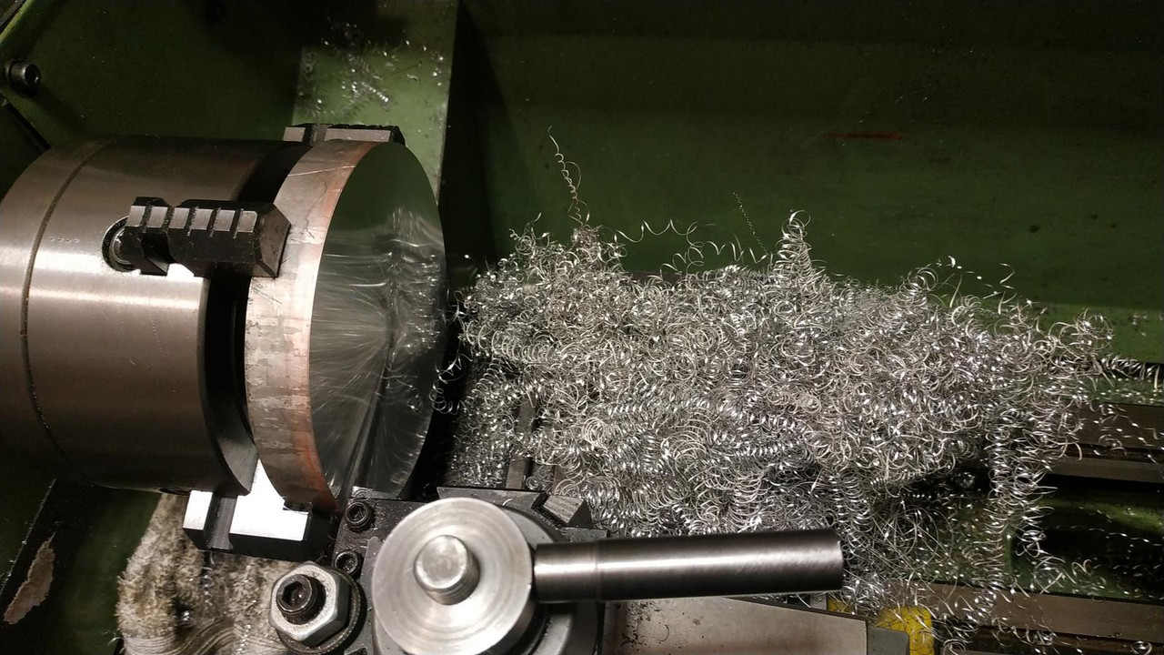

Kram if you grind some HSS with a really steep top rake it will slice material off at 3x your current rate without stressing the motor.
Derlin/acetal. Nice machineable plastic.
Avoid nylon. It will do what you want but its like cutting dog ****.
Not that lucky. Most of the DeWalt gear is A direct fit thankfully. But need adapters for other tools to suit. Poly?Dont mind nylon with very sharp tooling, but when it goes wrong worse than dog ****
Id go poly myself if they are one size id cast them.
what size do you need..i have some nice chunks of machinable plastic here if you need anyNot that lucky. Most of the DeWalt gear is A direct fit thankfully. But need adapters for other tools to suit. Poly?
