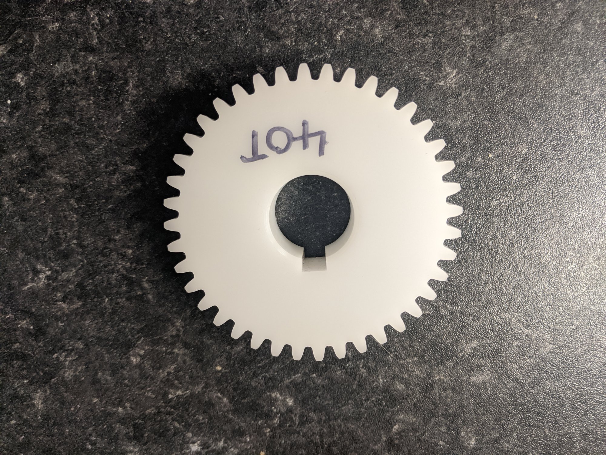

Why not? Time to cut or chances of a mistake? To reduce the second, print out a disk with 127 lines on it (there are online things that will give you a pdf), stick it on the blank and set up a height gauge/scribing block pointing at the lines. Then you can do a quick visual check of your indexing before pushing the cutter through it.

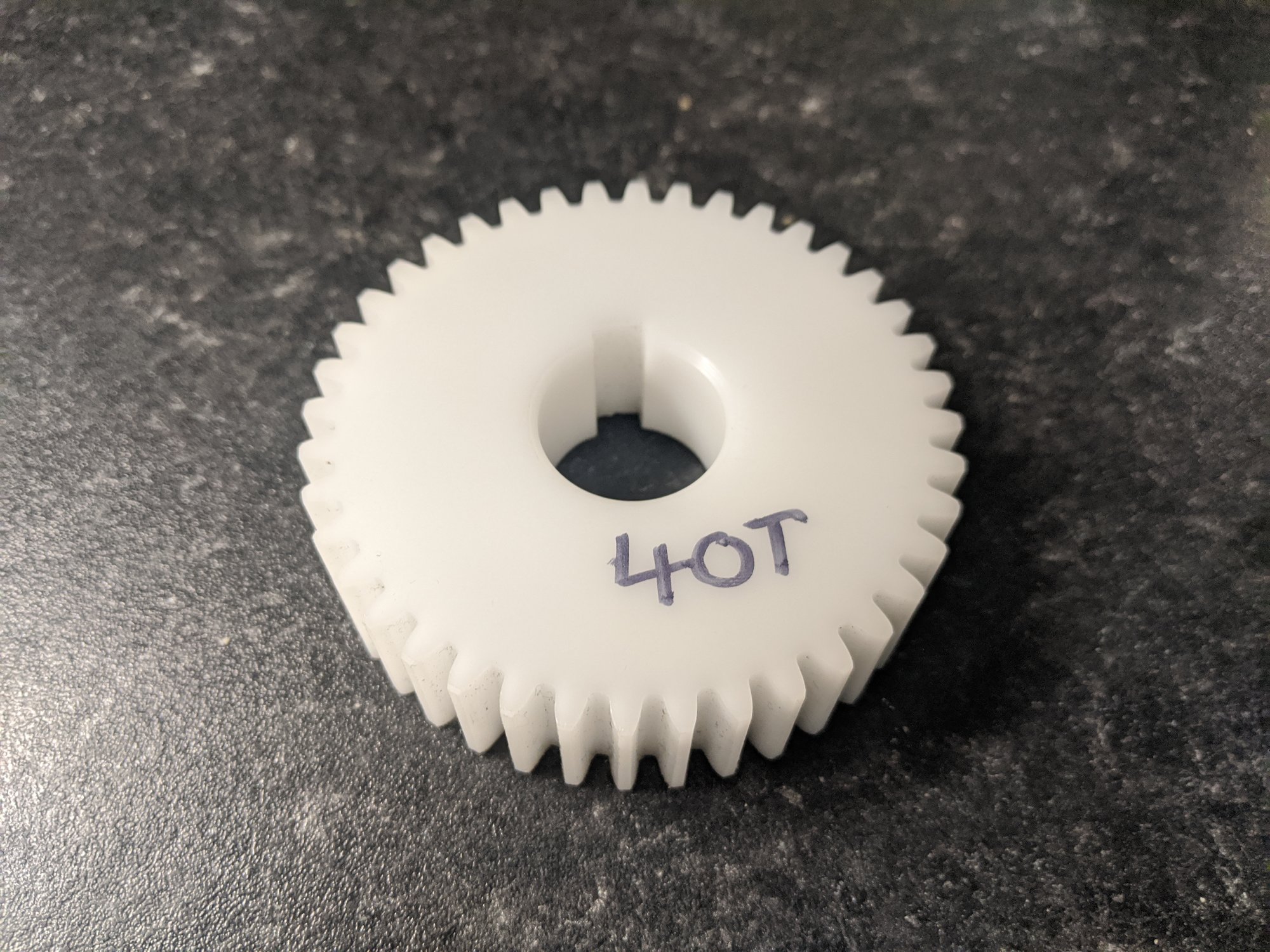

Dividing head and a set of Chinese gear cutters.
Get yourself a stepper motor and a DivisionMaster if you can afford it. That'll halve the time.
