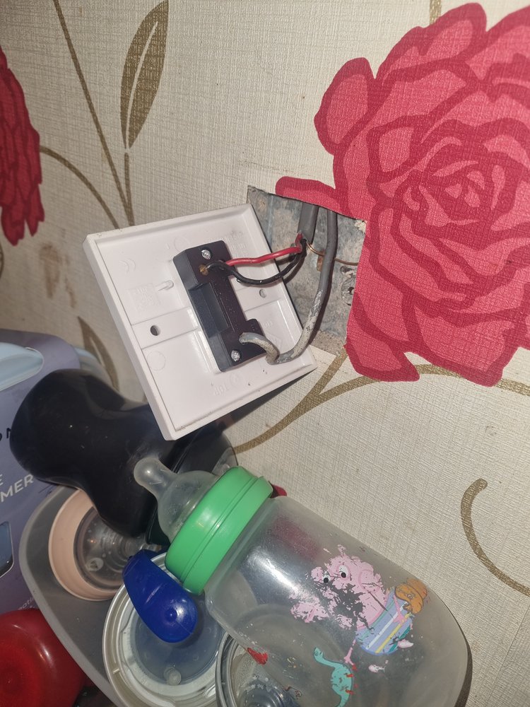

That's the problem. I can add one to a single light switch. As its got live and neutral in and live and neutral out. But the actual switches have a common and L1 and L2No battery. I use one in my workshop. Just wire it into the circuit & job done.
I know in principle how to wire it just not how to get it to work in my existing circuits given where things are. My Wife is however obsesses with table lamp type things so I have taken to automating those with sonoffs for the alexa control while carrying a cup of tea type moments.@brightspark or @dobbslc, (I believe), should be able to give you a better idea.
All the wires up there are black cable so no way will I be messing with them.You will have a neutral up in the ceiling rose/fitting so you might be best using a sonoff mini up there and leaving the existing switches alone.
Get the Tapo bulb that was linked to above - leave wiring as is…All the wires up there are black cable so no way will I be messing with them.
If anything I will get a kit with 1 switch and two receivers. I know that will work as I cut the live and neutral going to the 1 set of lights and it worked fine.
I can sort it but if I don't know why it won't work , I won't have learnt anything. Lol
I have two lights with 4 x g10's.Get the Tapo bulb that was linked to above - leave wiring as is…
Job jobbed.
Ok, might have been worth a mention at the beginning as that might affect how you do it. Possibly only 1 of those has the ring going through and the other has a switched live only. Our stairs light is a similar arrangement I think….I have two lights with 4 x g10's.
its not wired on the 3 plate system its wired in singles to the lightO
and will have a twin and earth loop to the second lightYes that’s kind of what I was getting at - it won’t be the same as a standard ceiling rose arrangement.its not wired on the 3 plate system its wired in singles to the lightand will have a twin and earth loop to the second light
A friend has lighting in most of her rooms controlled by Alexa.Or swap the bulb for something wifi controllable e.g. not tried them myself!
I would love to say I understand all of that. I value your reply but it won't help if I say ok greatthe single cabe will be the comon either its the live feed or it will be the switched live to the light .the twin and earth red and black is the straps wire to the other switch. live one and live 2 in switches
So if I had started at the other light I might have been better off?its not wired on the 3 plate system its wired in singles to the lightand will have a twin and earth loop to the second light
But I don't have alexa (or google) in the kitchen where I need this extra switch.A friend has lighting in most of her rooms controlled by Alexa.
No changes to the light switches (they now work as isolators if / when needed), the standard bulbs have been swapped for "Alexa-compatible" ones.
Well if I went into the ceiling I could of used the switch I was trying to fit.You will have a neutral up in the ceiling rose/fitting so you might be best using a sonoff mini up there and leaving the existing switches alone.
With a sonoff mini you can use the existing light switch wiring to manually switch the light on/off by connecting it to the S1,S2 terminals. The sonoff does need to be installed at the ceiling rose for this to work to use the neutral.I ended up with a sonoff mini but it comes without a switch. I can't even find one on amazon strangely.
