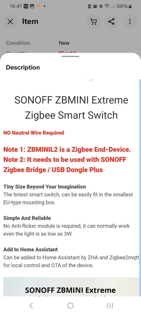

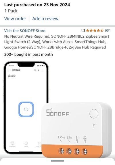

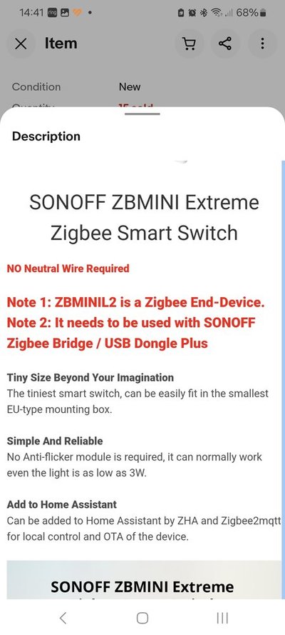

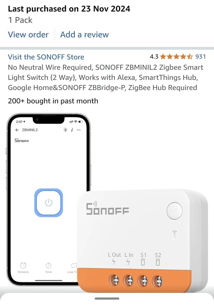

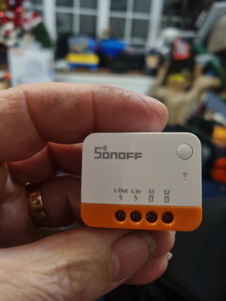

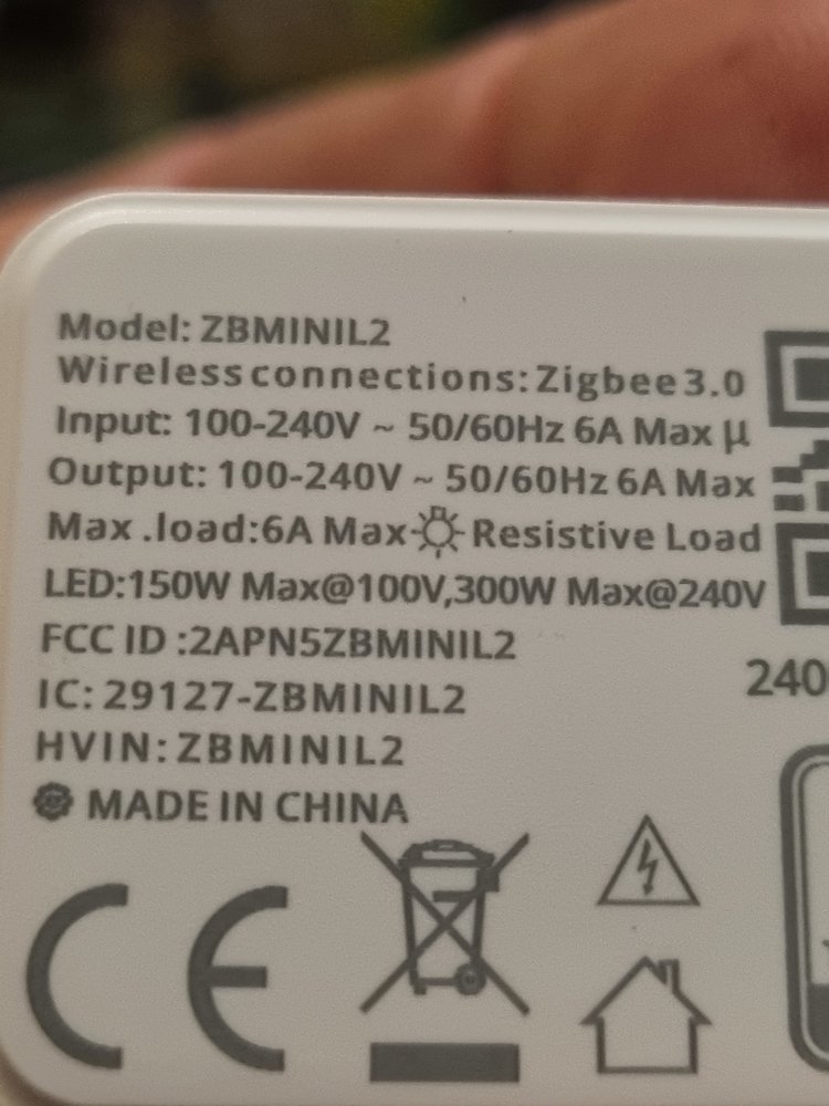

The one I got does not need a neutral. But installing it at the switch to use the existing switch defeats the object of a switch in a more convenient place.With a sonoff mini you can use the existing light switch wiring to manually switch the light on/off by connecting it to the S1,S2 terminals. The sonoff does need to be installed at the ceiling rose for this to work to use the neutral.
