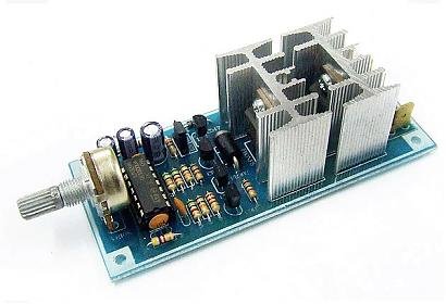

Would probably need a different potentiometer as it would need to go across the motor.
Or replace the pot with a pulse width modulator to switch the tranny on and off, this would increase low speed torque and reduce heat dissipation in the transistor.
Maplin do this http://www.maplin.co.uk/module.aspx?ModuleNo=30310&doy=19m12
It will only work from 6 to 15v, but I see no reason why it shouldn't be used to drive the base of a power tranny instead of a motor.
Coupled with Bump's independant PSU it could be a neat solution.
