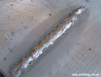

Where ordinary mild steel mig welding wire needs an inert gas shield to prevent it from oxidising when melted, gasless MIG wire has a flux core which forms the shield around the weld to keep oxygen out.
It's the flux that causes all the weld spatter in the photo and the light coloured crust (slag) on top of the weld.
The slag is easy to remove with a wire brush (apart from around the very edge of the weld), and the resulting weld is reasonably neat.
Immediately after the weld is applied a protective coating of slag bubbles up, which means you can't actually see what the weld pool is doing. That's a big downside of gasless welding. In ordinary gas shielded welding you can adjust speed and technique depending on what the weld pool is doing.
My approach was practice on some scrap to get the settings right, then weld consistently and hope for the best.
The arc seems brighter than for mild steel welding and the weld spatters and gives off white smoke.
A flat zigzag torch movement pulling the torch seems to work well with flux cored wire. It prevents the arc dipping back too much into the cooling weld pool (the slag would stop the arc).
The arc is otherwise very stable, but the slag does not conduct so any tack welds would also need to be cleaned up before welding.
The advantage of gasless (other than saving on gas bottle rental) is the ability to weld in windy conditions.
I tried it outside in a gusty wind, and as the photo shows the weld turned out just as good as the one I did inside. Normal gas shielded welding would have struggled in the slightest breeze.
