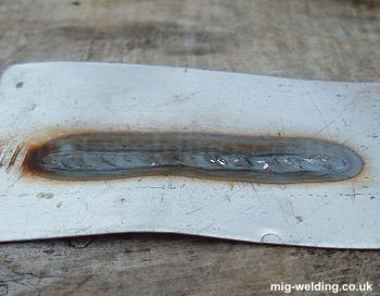

Welding thin steel
The butt weld page showed how to do a seam weld using a continuous torch movement. Try applying that technique to steel less than 1mm in thickness and you are likely to blow a hole in the metal.
The photo is 1mm steel welded at a power setting normally reserved for 2mm steel.

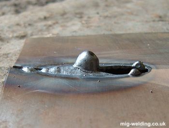

Blow through
You can see what's happened from the photograph. The puddle of molten metal has become so big and heavy it's dropped off the steel.
Often this can be prevented by reducing the amp setting of the welder and the wire speed. Using thinner wire (0.6mm instead of 0.8mm) will also help reduce amps.

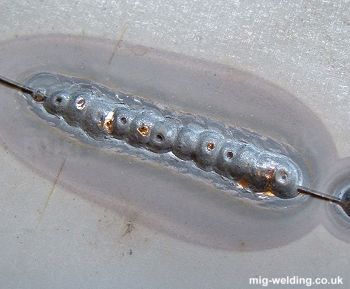

Technique for thin metal
The way around this is to weld in short pulses, allowing a second or less between pulses for the steel to cool down. In the video I've left about a second between pulses. These days I'll normally leave less than half a second. The longer you leave the more chance you'll have of cold joints and pinholes between the welds.
Turn your sound on for best effect. The movie is about 1.4MB so will take a little time to load.
1.4Mb Flash video preloads before playing and includes sound
The completed weld
The steel is 0.8mm thick and the welder power was set to minimum.
The effect is quite neat, though this is a cold method of MIG welding. The danger with this technique is the individual beads of weld might not melt into each other fully resulting in a weak joint.
For thin metal this isn't a problem, but a continuous weld seam weld would be much more appropriate for steel over 1mm.

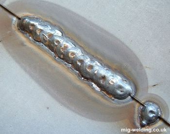

Reverse Side
The penetration is higher than might have been hoped, but the weld is perfectly strong enough.
The stitch welding technique can be very powerful. Here's a shot of 0.3 mm stainless cut from a 5L thinners can that was welded in this way. I was hoping to manage a butt weld too, but the metal was far too thin for MIG and I just blew holes.
TIG welding is the way forward for metal under 0.6mm, and a MIG welder with decent power and wire control is needed for anything less than 0.8mm.
