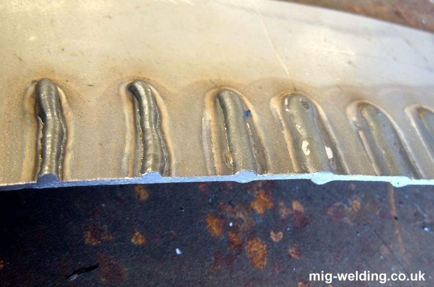

The calculator provides a rough starting point for power settings. The easiest way to fine tune the setting is to practice on scrap steel of the same thickness as the steel you want to weld.
Here a series of welds have been laid on 1.2mm sheet using increasing power settings from left to right. Welds made on the lower settings are quite narrow and tall, and welds on the higher settings are wide and flat.
Weld penetration
Looking at the reverse side of the weld is more informative. The two welds on the left side haven't penetrated all the way through the sheet, but the three welds on the right have penetrated a little too far.
The aim when welding two pieces together edge-to-edge is to end up with the edges of the metal melted into the weld on both sides of the joint, but not to have excessive penetration.
