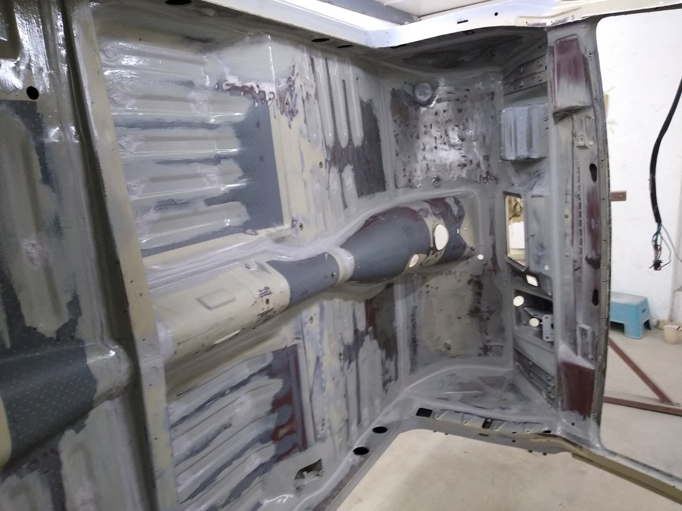

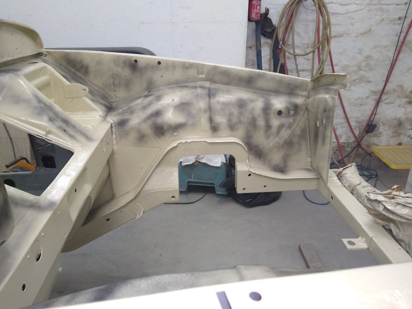

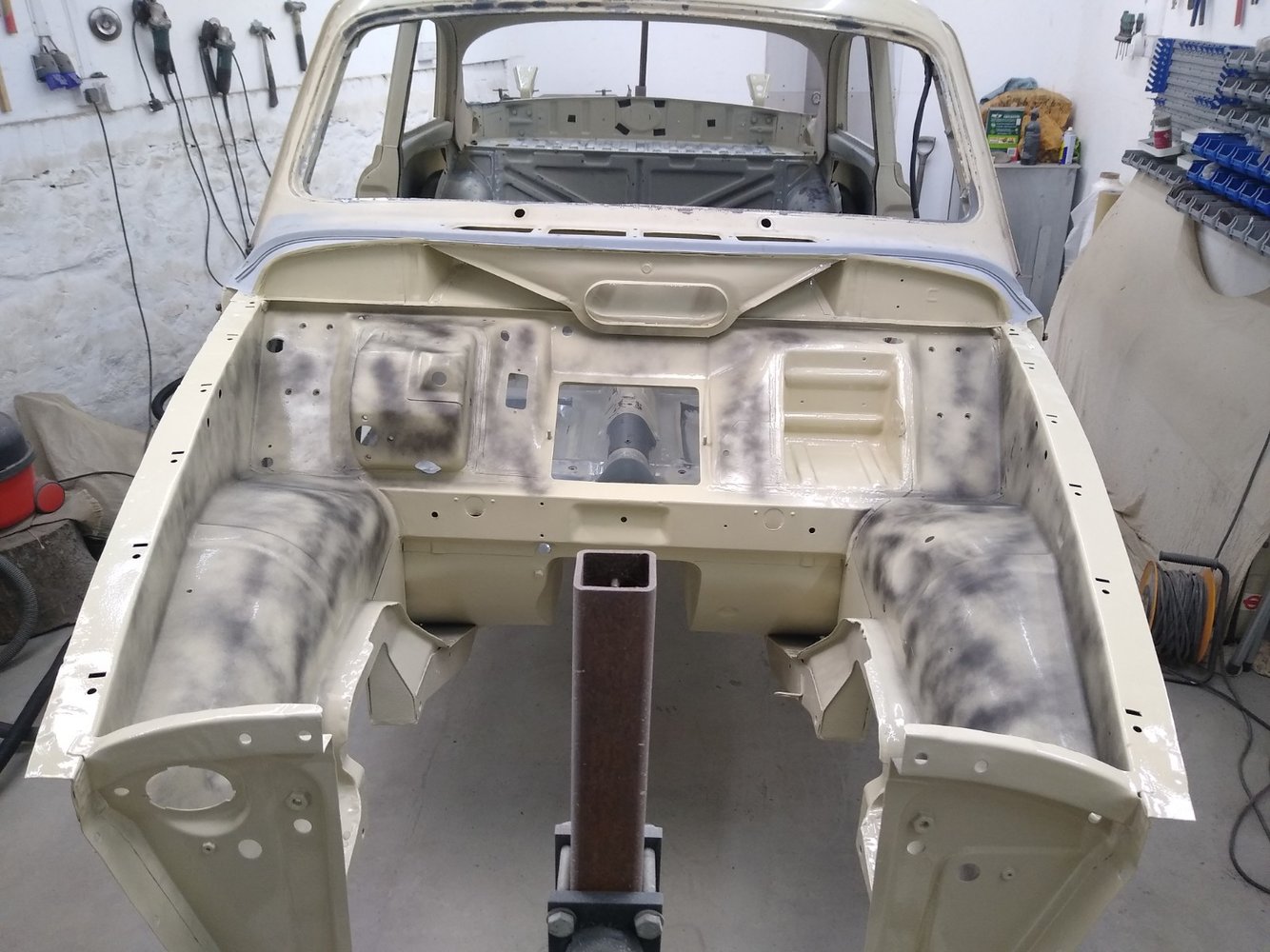

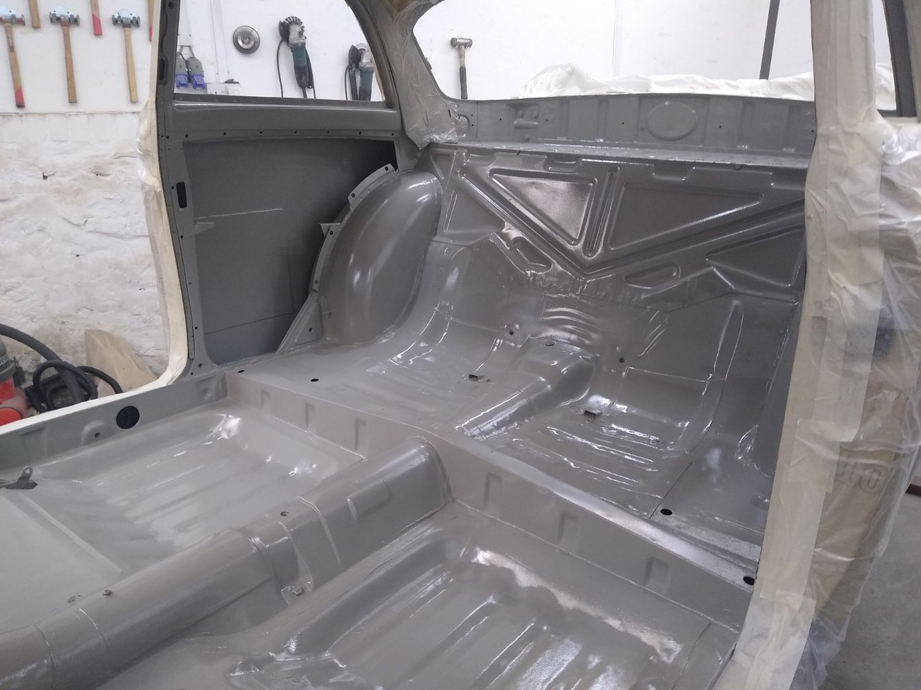

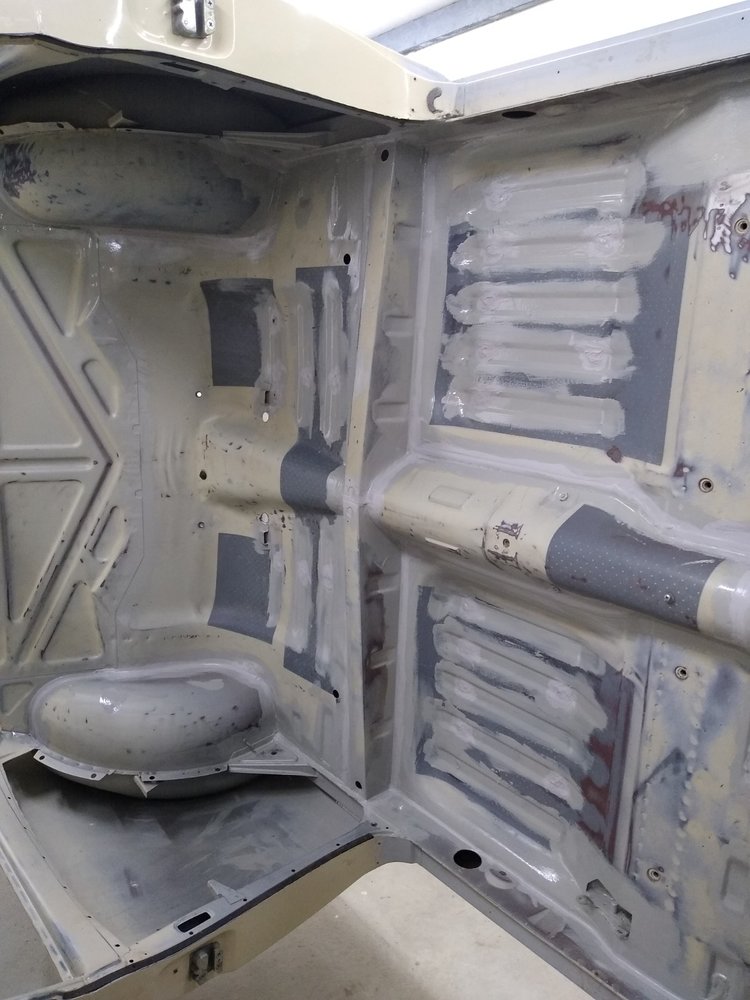

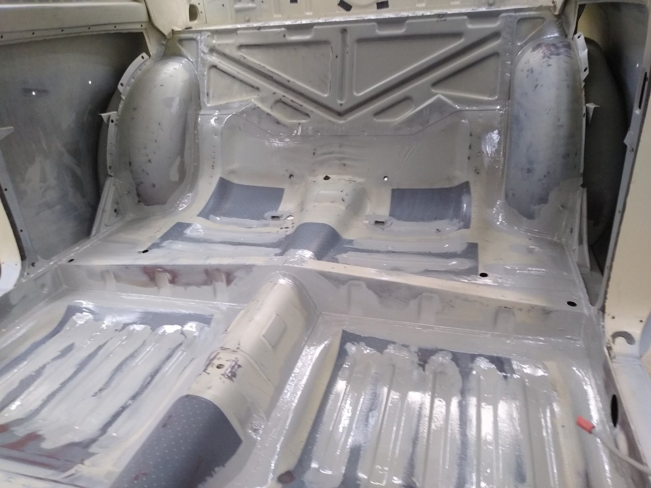

Yeah going to be flatting it and topcoat again after I do the interior. Need to also get a flatter finish from the epoxy so a bit of experimenting as well before I paint the interior.I didn't flat back the engine bay. Now I regret that.
Cheers will give it a try.I find when I put epoxy primer on I lower the air pressure to the gun to about 20psi. Seems to flow nicer and sit better on the panel.
I always flatten primer before paint though.

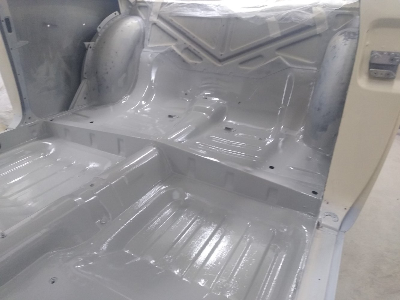

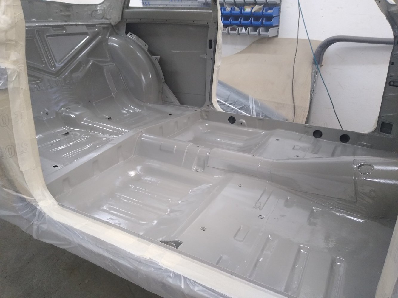

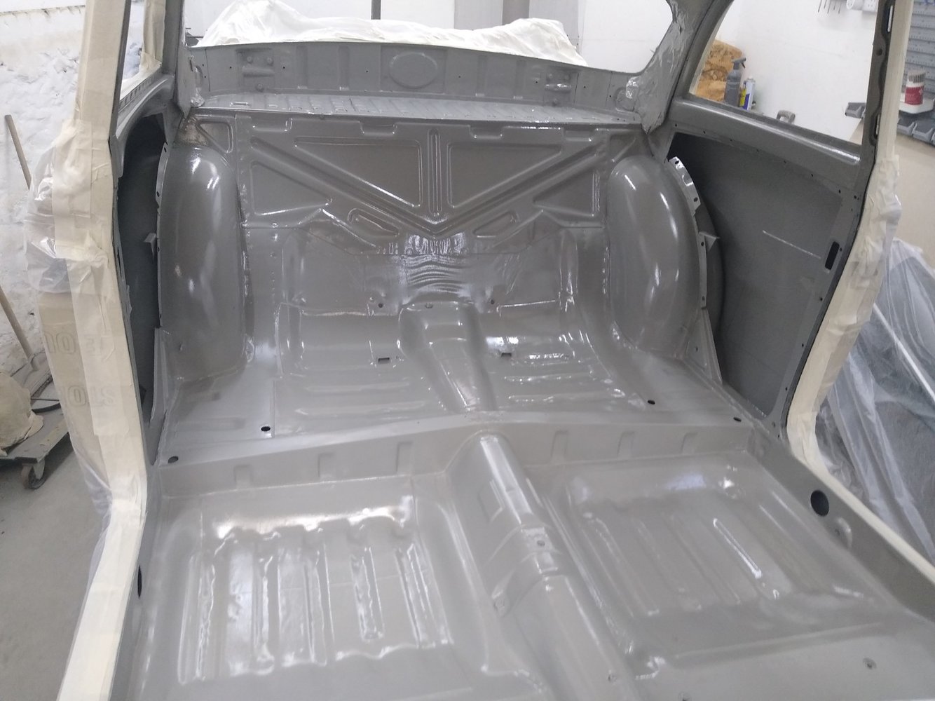

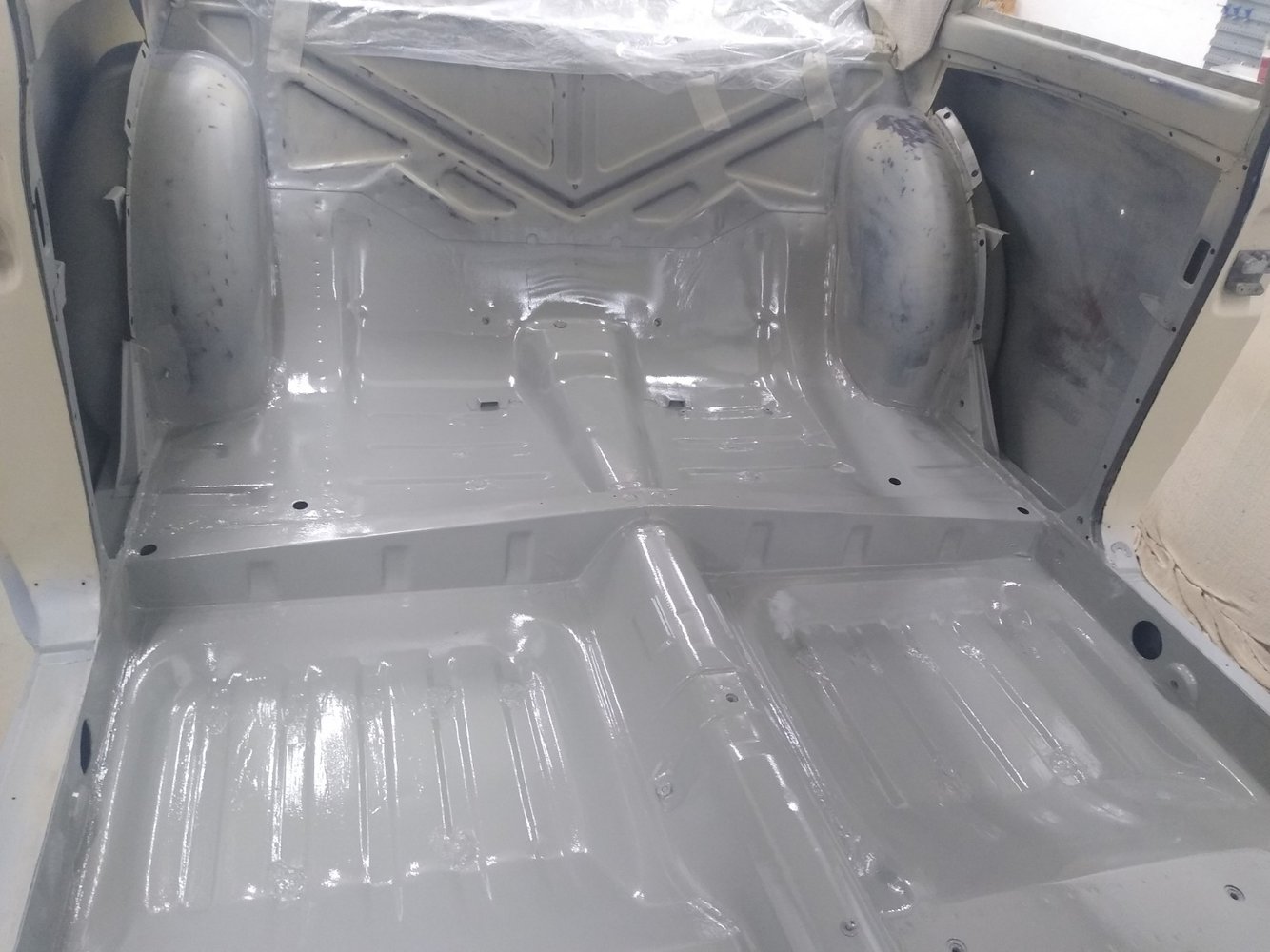

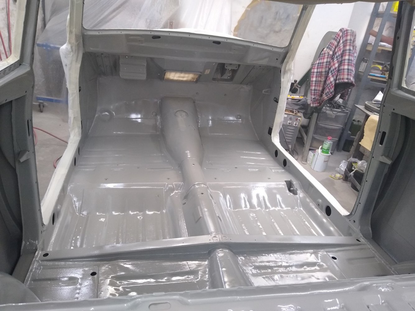

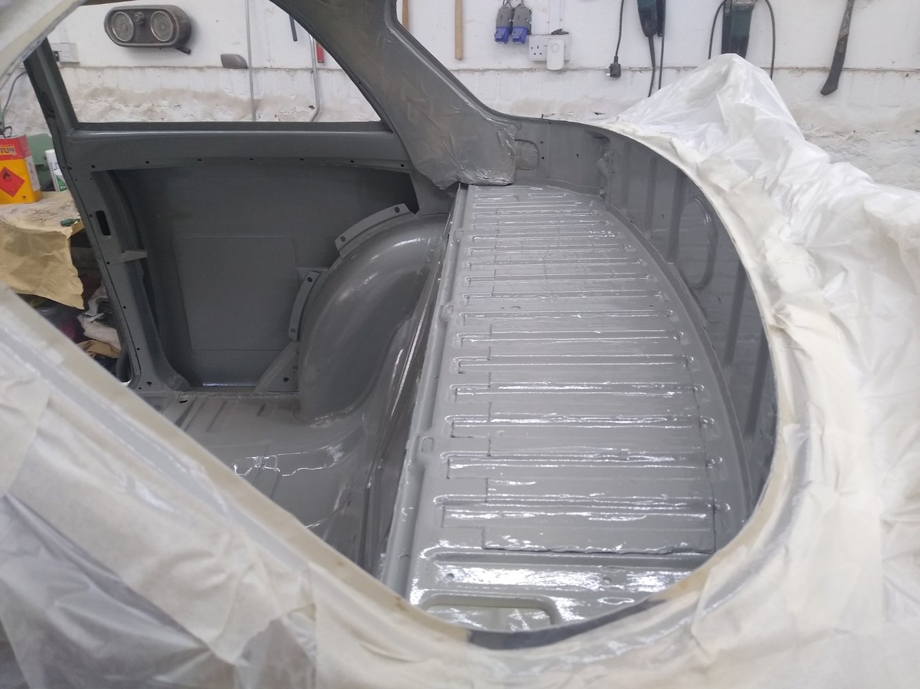

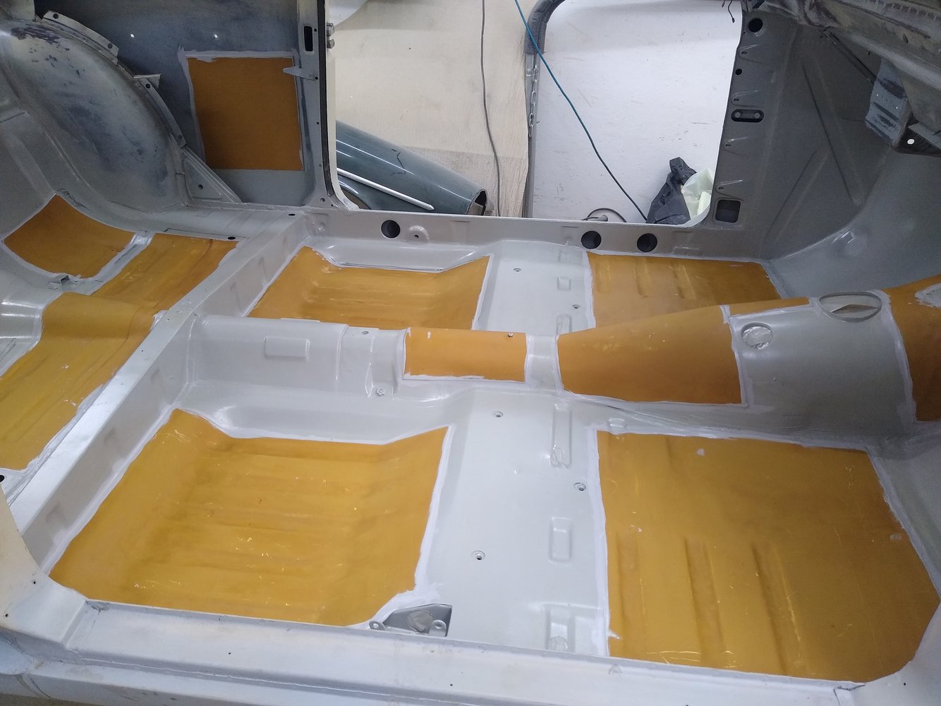

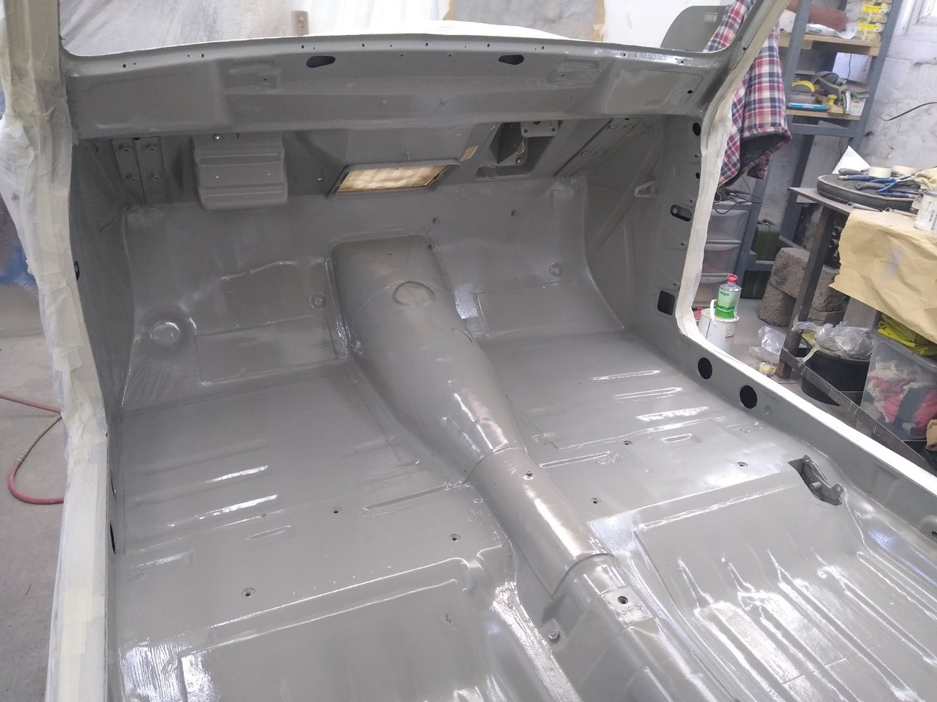

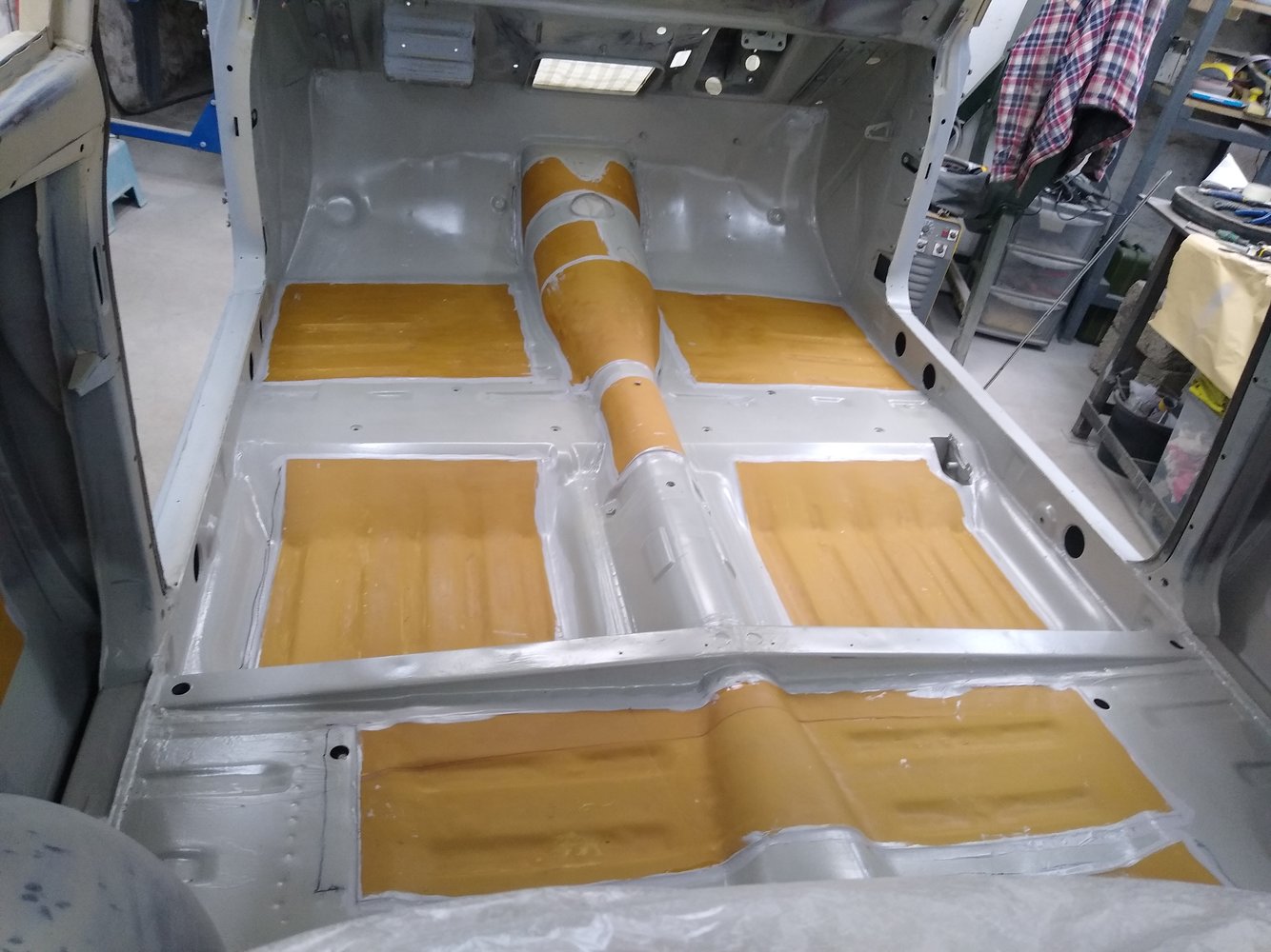

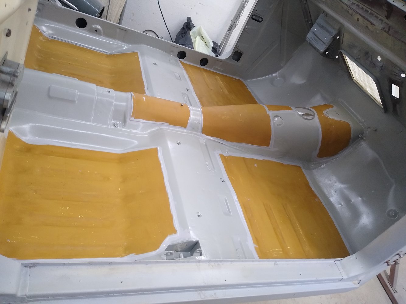

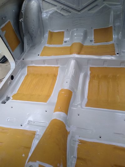

Couple of layers of epoxy down ready to put the heavy layer sections back in next.
View attachment 340620 View attachment 340621 View attachment 340622 View attachment 340623

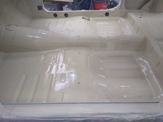

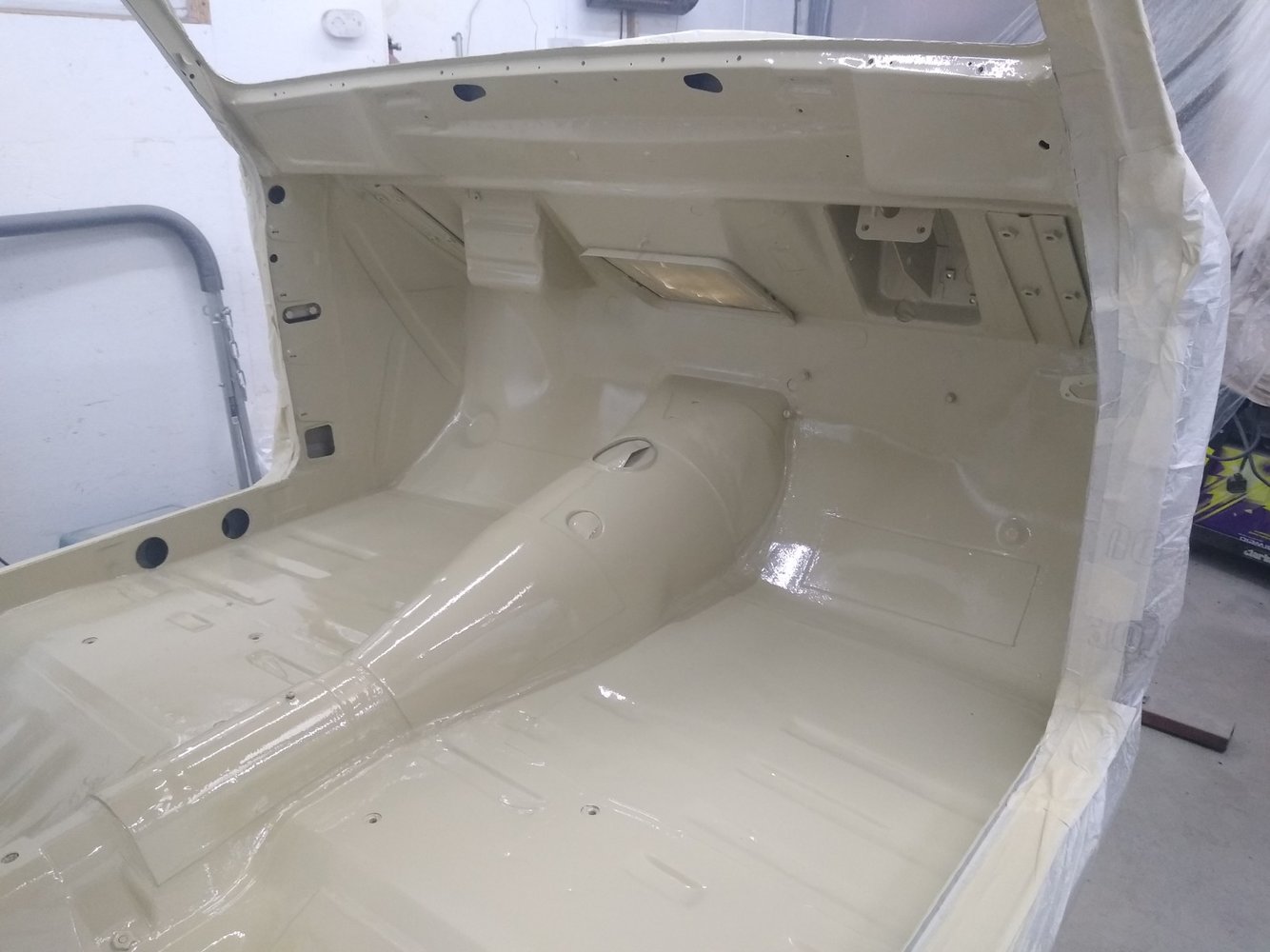

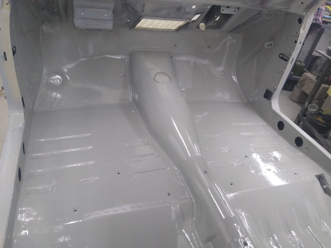

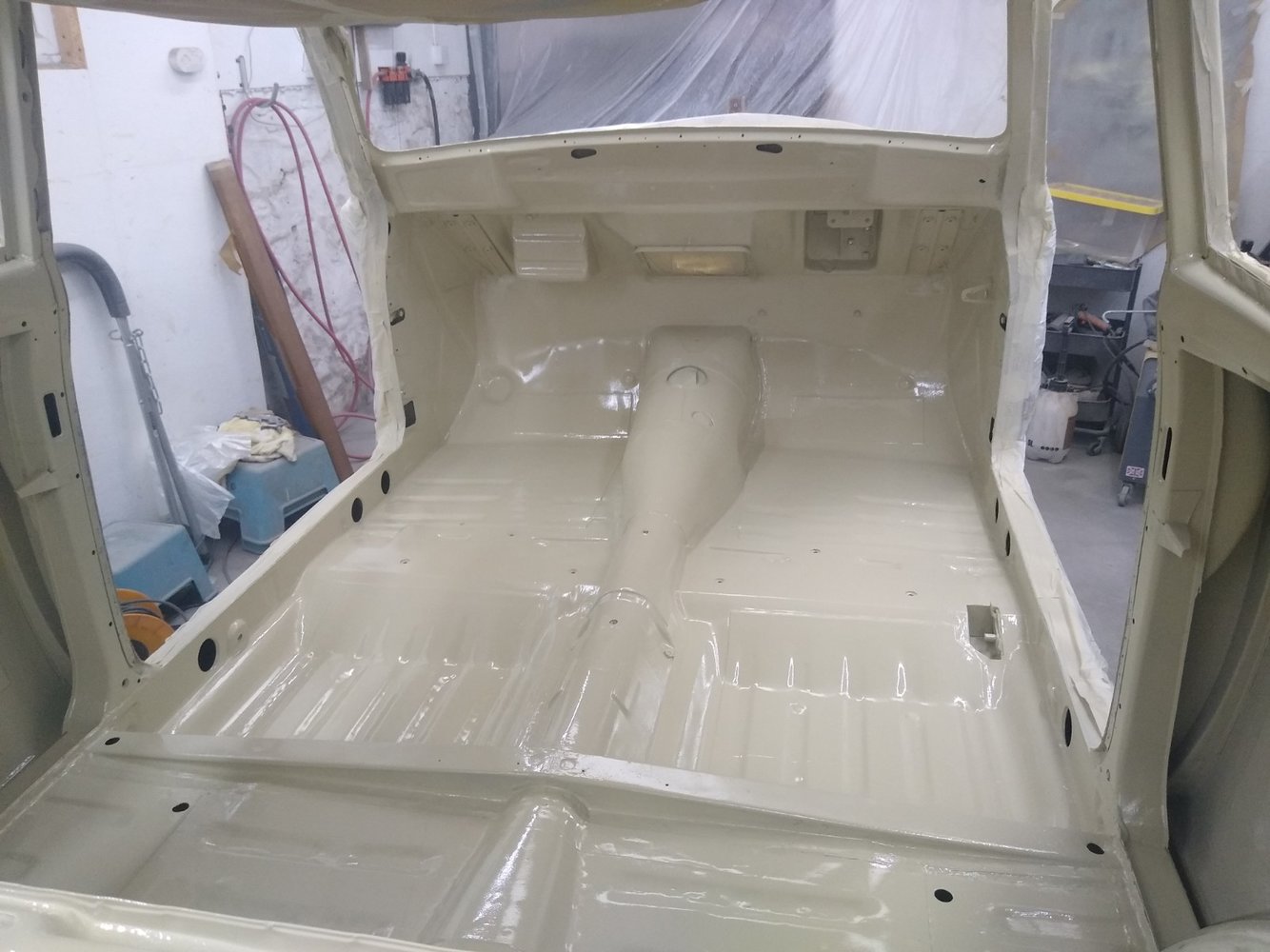

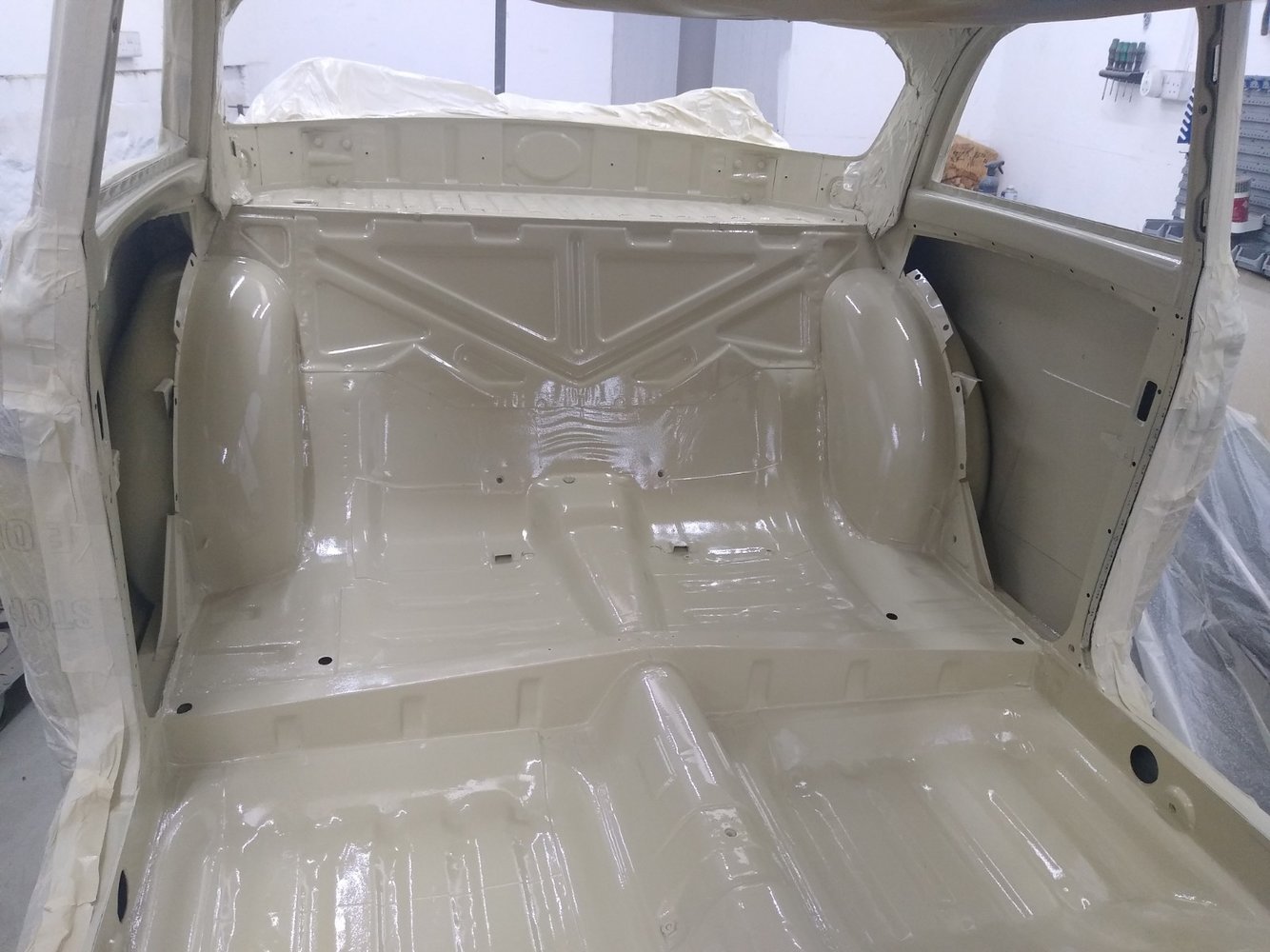

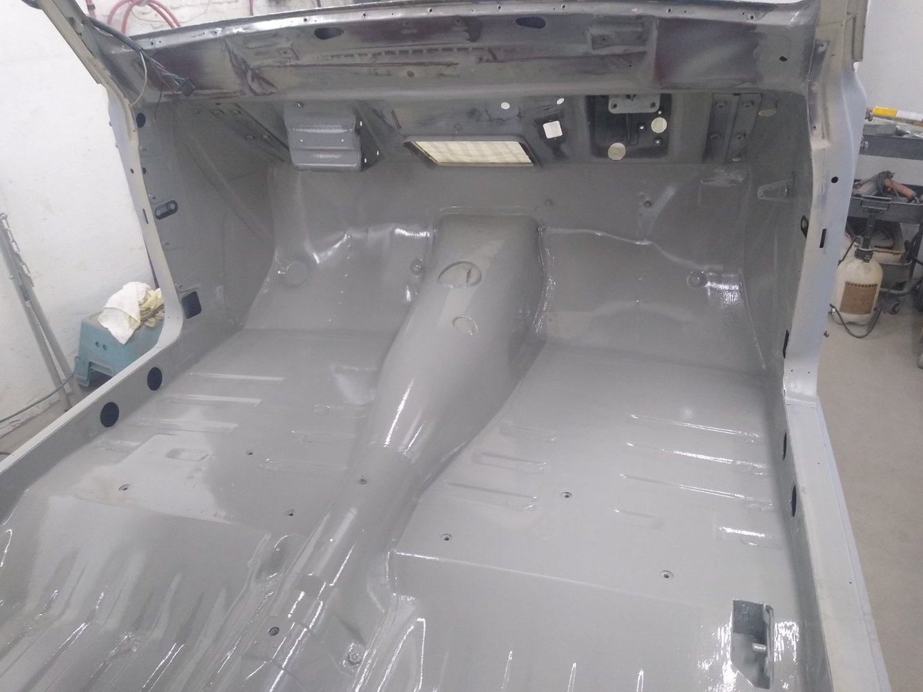

Final coat of epoxy down and topcoat tomorrow.

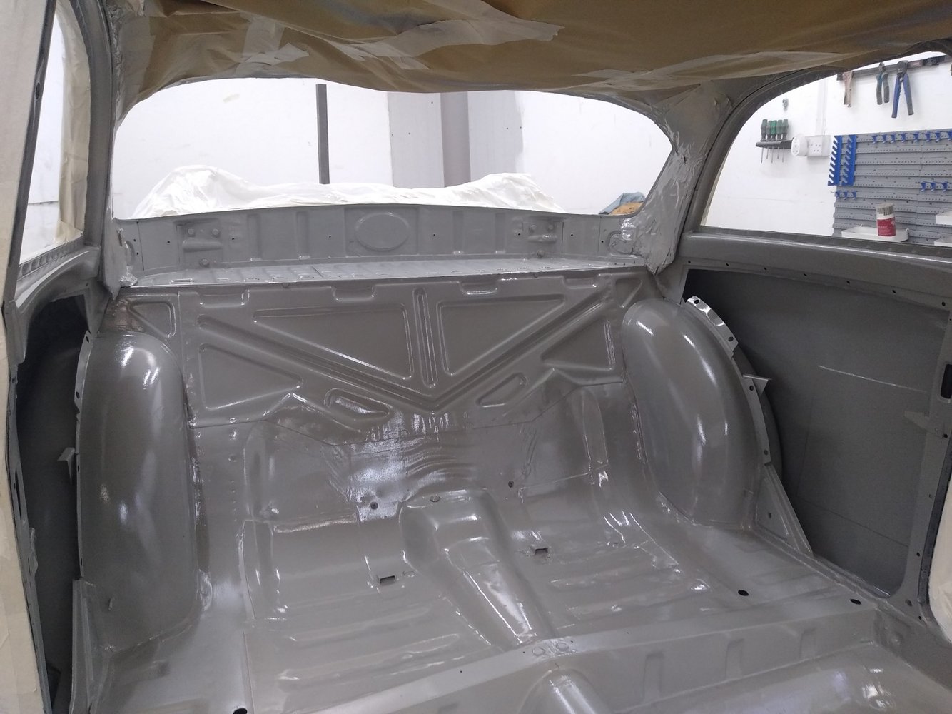

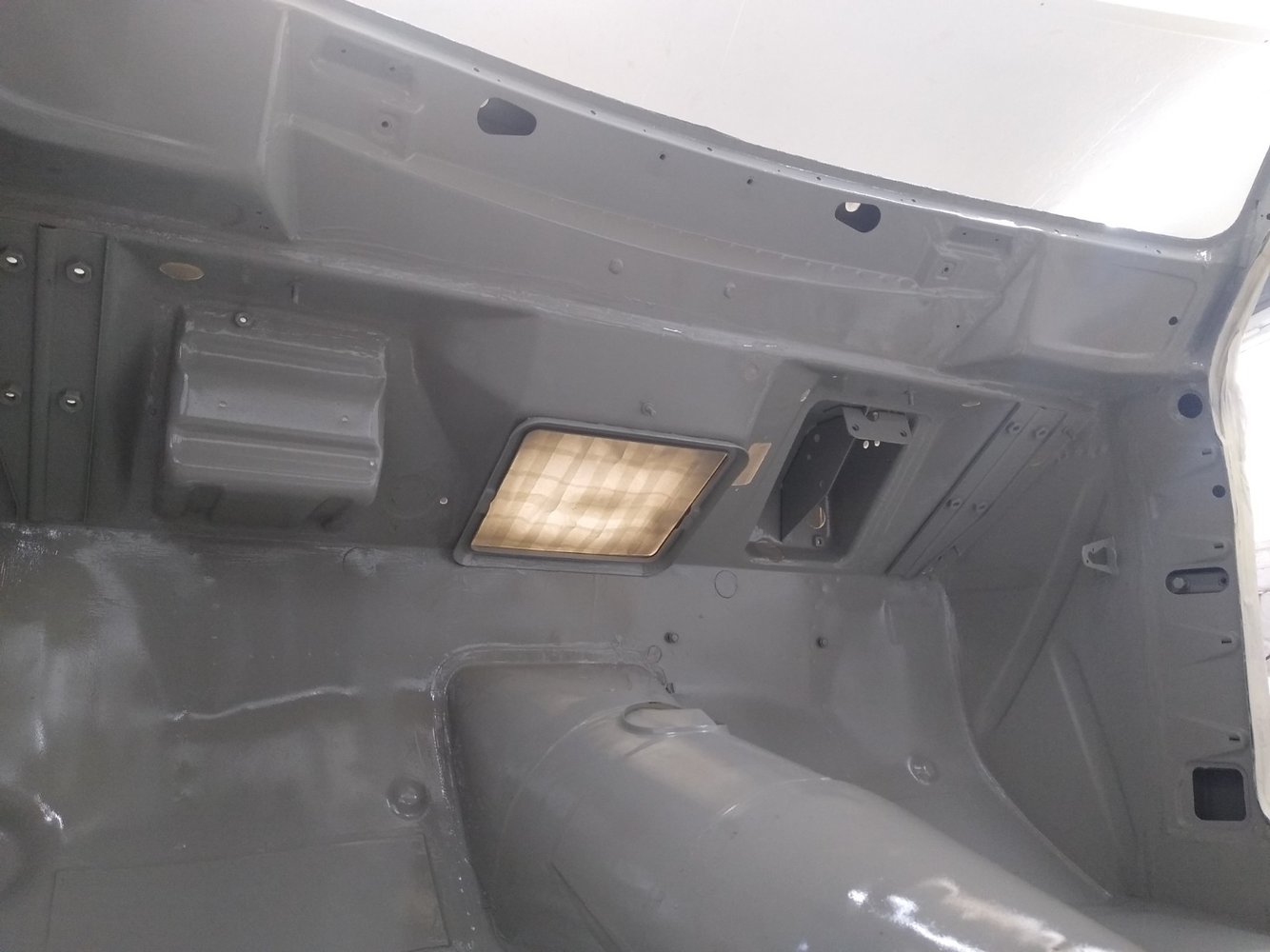

View attachment 343353 View attachment 343354 View attachment 343355 View attachment 343356 View attachment 343357 View attachment 343358 View attachment 343359 View attachment 343360 View attachment 343361
The masking took longer than the painting. I would have top coated it today but I touched one of the only bits you see with the airline so it will need a little rub down before top coating in the morning.Who's been a busy boy, then?
Yeah no bother, I have a heater that I will put on that heats the room pretty quick and it’s forecast for 11c tomorrom.Is it going to be warm enough for top coating it?
