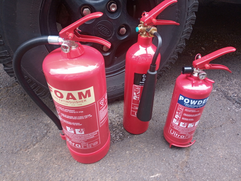

You need officially 43% by volume of co2 in an enclosed space to extinguish a fire, any small leakage areas can be over supplied to make up for leakage. But filling rooms with co2 can be kind of dangerous, hence why fixed systems have so many safety features, to either stop you going in to the room while live, or as in marine systems where you have 3 somtimes 4 actions to fire it. That was the advantage of halon 1301, you only needed 5% by volume and it doesnt kill you quickly due to asphixation.One of the simplest things is a garden sprayer filled with water, set the nozzle for a medium spray and keep it filled and pumped up, deals with many things and costs nothing. Its surprising how a quick dousing can put out a fire and you can adjust the nozzle from fine mist to full spray.
One of the best I saw was several years ago with a confined workshop, they guy stood by the door and set a CO2 off, threw it in and slammed the door shut. Filled his workshop with CO2, extinguished the fire, and he opened the door and stood outside with the garden hose to cool everything down.

So you have a very minor fire, put it out with 'Patent Put-It-Out-And-Make-A-Mess" but ruin £100K worth of machinery in the process when a quick blast from a CO2 extinguisher would have done the job?
Not my philosophy. You don't amputate a hand to remove a wart! Access the situation and act accordingly matching cure to illness !

The nozzle of course, then sue the supplier when your frostbitten hand is amputated.On a CO2, were do you hold on to it?
Twin agent fire fighting is very efficient, but its powder and AFFF, quick knock down, then a sealing blanket.why the worry with the mess and powder... the consequences of a fire are far worse to deal with...powder and co2 for me,
