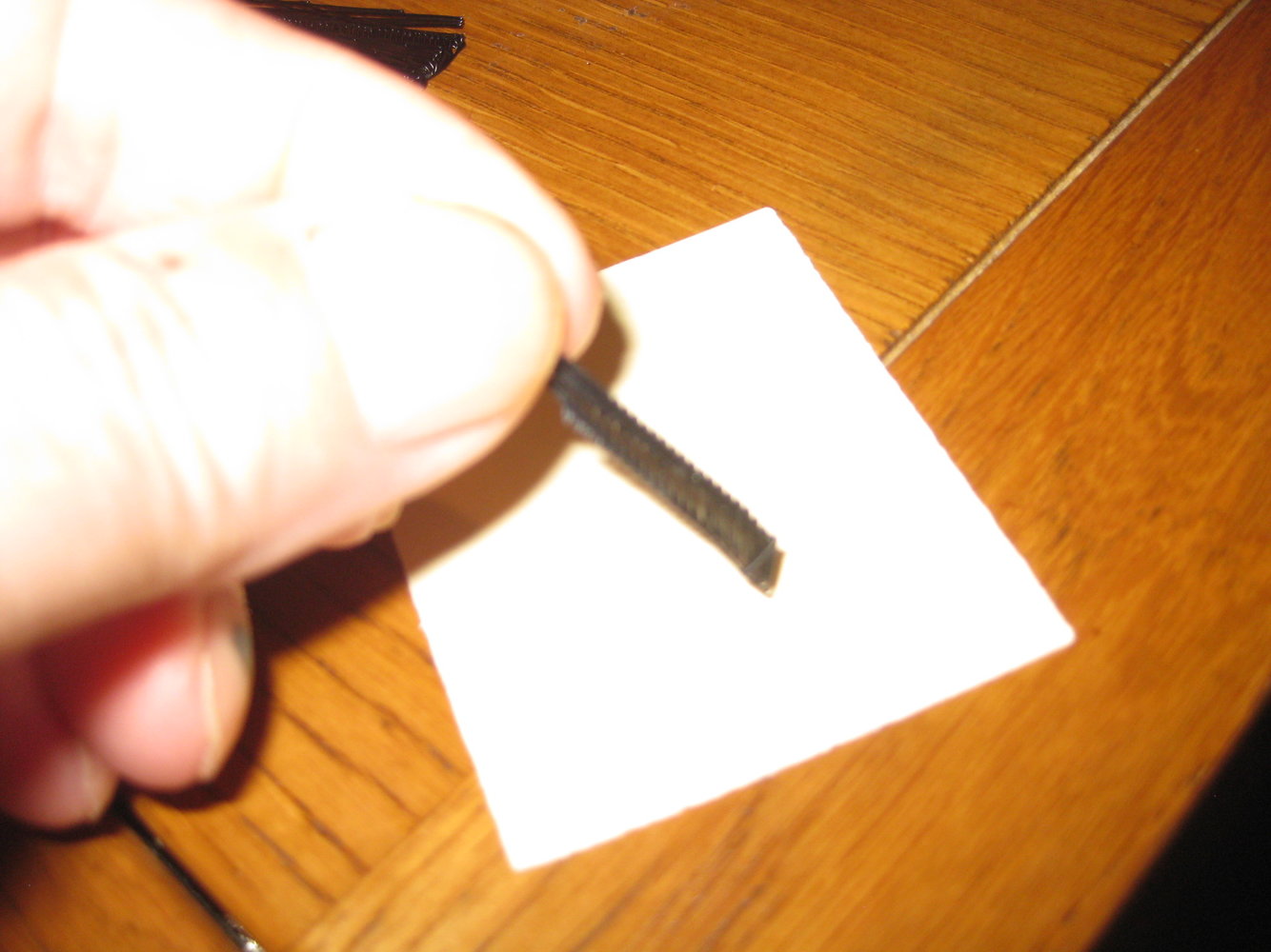

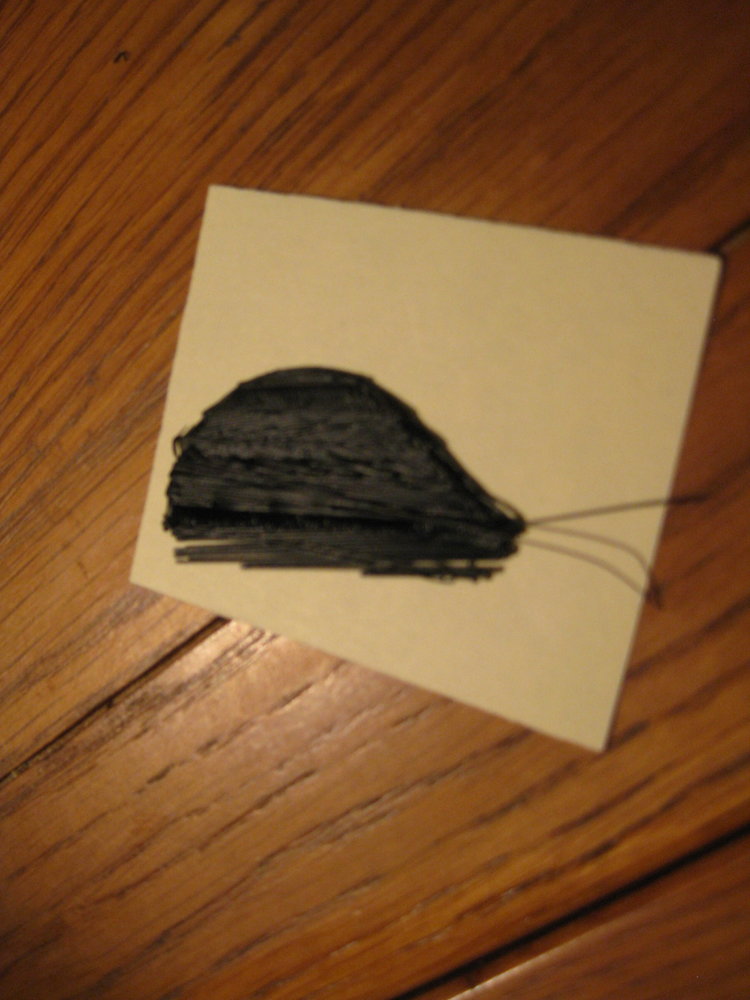

Squish encourages adhesion. But also squashes the 0.4 mm bead coming out of the nozzle.
With no squish you end up with a line of plastic just touching the build plate at the very bottom. (Like a round garden hose)
So the no part is the stepper motor does not compensate to fill in the voids. To confuse things it might do something similar when creating a smoother finishing shell. But NOT at the start.
