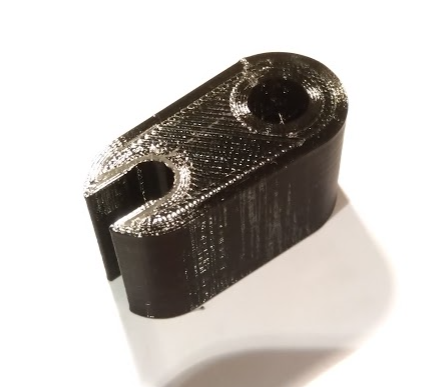

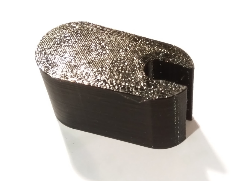

That's precisely what I've designed and exactly what I'm am after. Thanks a heck of a lot ..you are a gentleman & a scholar as far as I'm concerned .

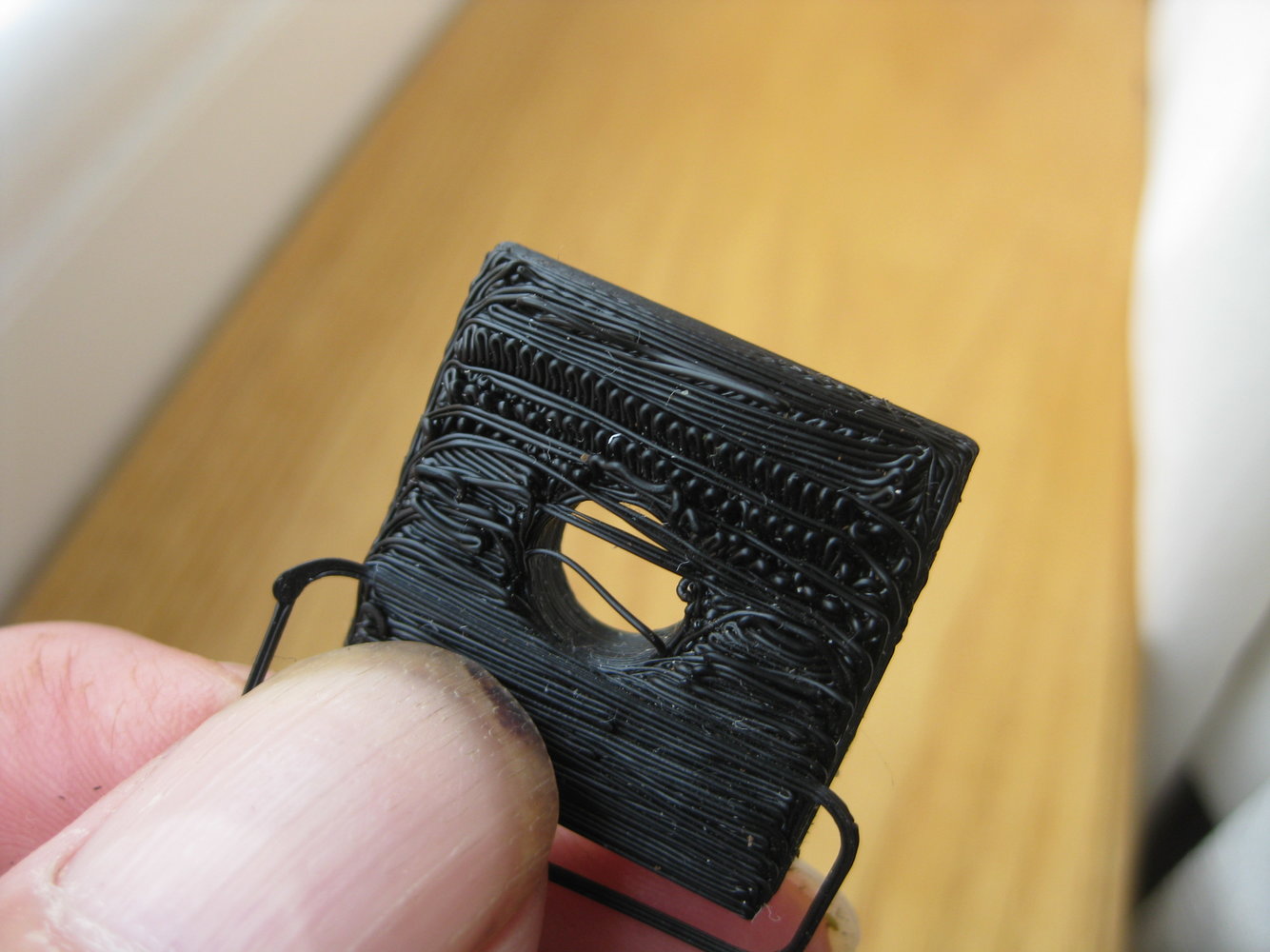

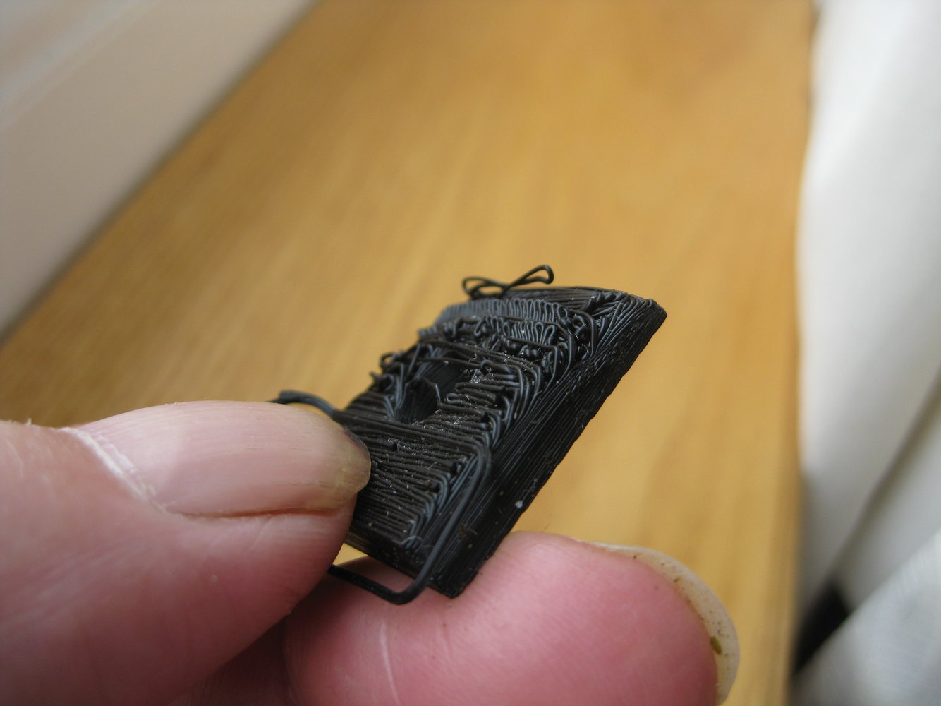

the last two show something quite different

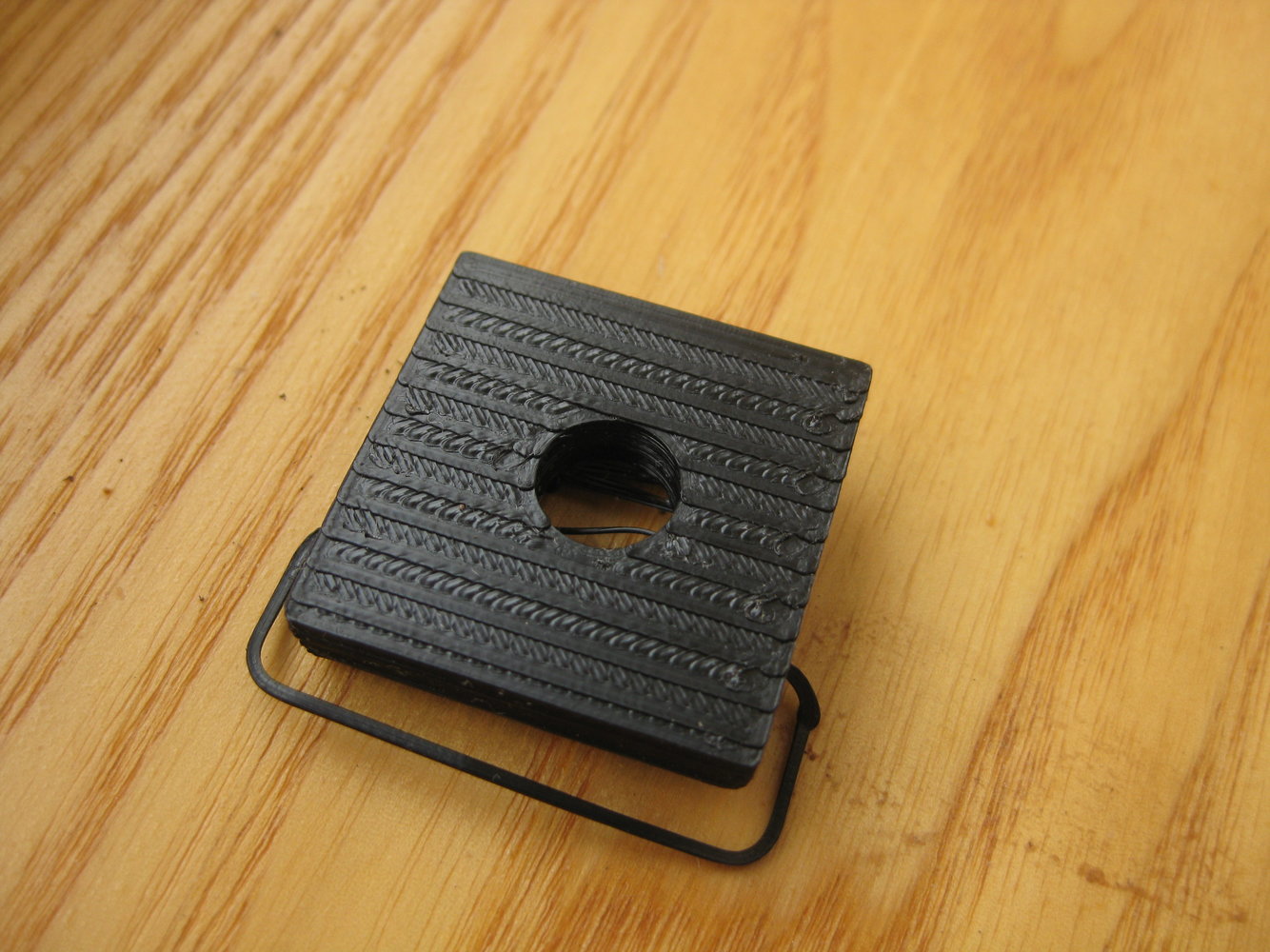

Or is there something wrong with your slicer not putting the part level on the bed?

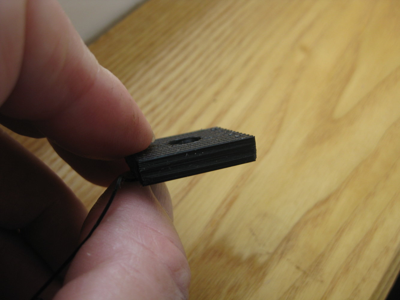

bloody dawn chorus Well , well, well . the top finished surface of the latest test piece looks something like the designed 5 mm thick 19 mm square with an 8 mm hole plonked in it
The second shot looks about 5 mm thick , but O my , o my , o mythe last two show something quite different
\G
The good news is using the home made ABS juice it did stick to the plate after a fashion . I'm making the solution a bit stronger ,having added all the mistakes in ABS to the original pot of mix , to see if it really was all down to one edge curling because of not sticking to the plate enough .
