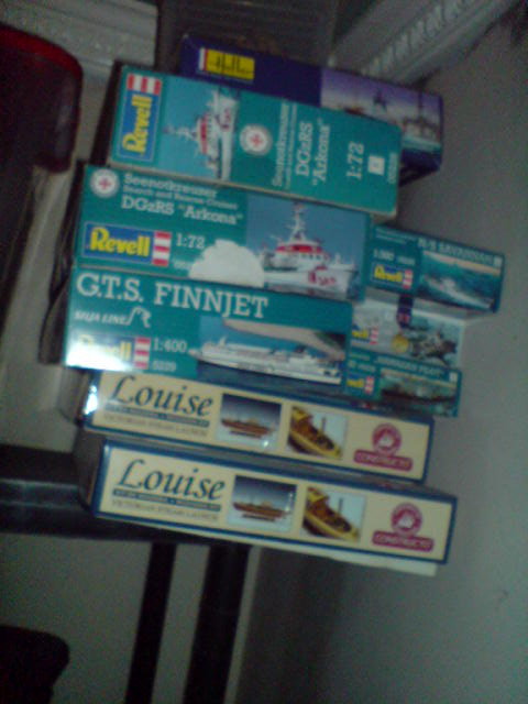

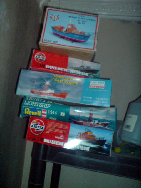

Ive got a few boats kits to convert to radio control once I get round to it, and I try and get 2 of each kit as then you have spare parts to modify.

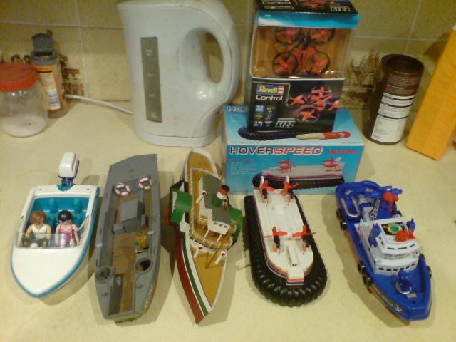

ohh and may as well show some of my smaller radio controlled boats that I play with on a lake
the landing craft )2nd from the left) is from a revell kit, the paddleboat (in the middle) is scratch built from styrene, and was designed as I went along, so no general arrangement drawings for it, just some parts that need to be made accurately. the other 3 are toys that have been converted to radio control

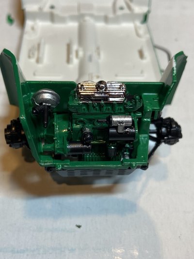

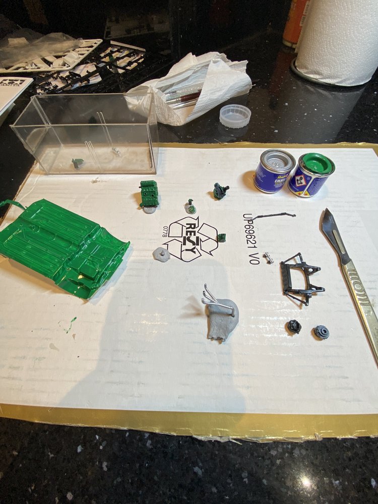

I find that the double acting ones are good for very small areas (like the white piece in the photo below because of its legs) as I find the spray is very dry (even with a larger 0.5mm needle and nozzle), so if spraying large area, the air will dry the sprayed finish, so its hard to get a wet finish, unless you go over the same area several times and it ends up being a thicker coat of paint
for larger areas I use single action airbrushes (like the grey part in the photo) as the needle and nozzle is about 0.8mm, so it allows more paint to be used and you can get a wet finish, it also helps that the single action airbrush has a wider spray cone so its easier to get a more consistent finish. Also show are the primers that I use that are designed for spraying from the bottle (for models) and I spray at 20psi, so its not the consistency of the paint that is the issue, its the design of the airbrush. the ones I use are cheap generic ones (even though my brother in law sells ones for up to £250).
if you're painting by brush rather than airbrush, for larger areas, I'd go for a flat brush thin the paint 1:1 paint:thinners if you're using enamel paint and on the subject of painting, if you need to mask something, dont use household masking tape, use Tamiya masking tape as it gives a very clean line.
