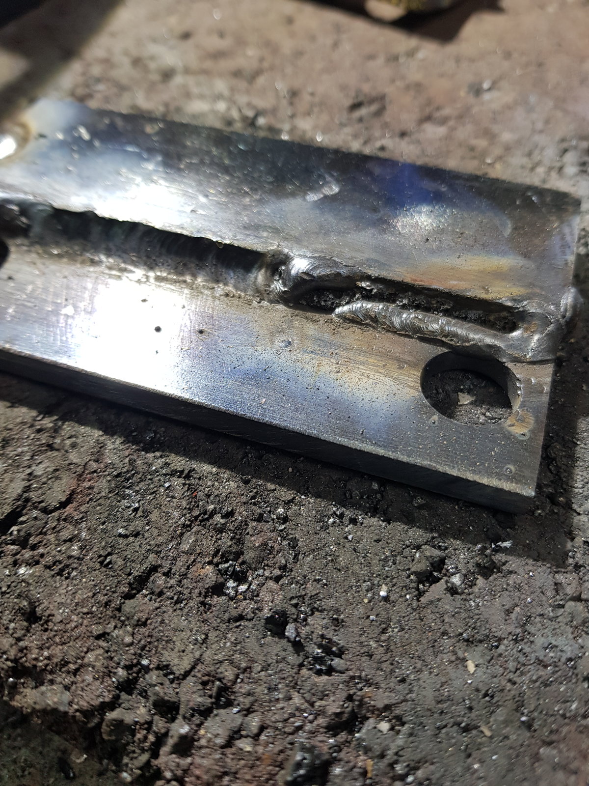

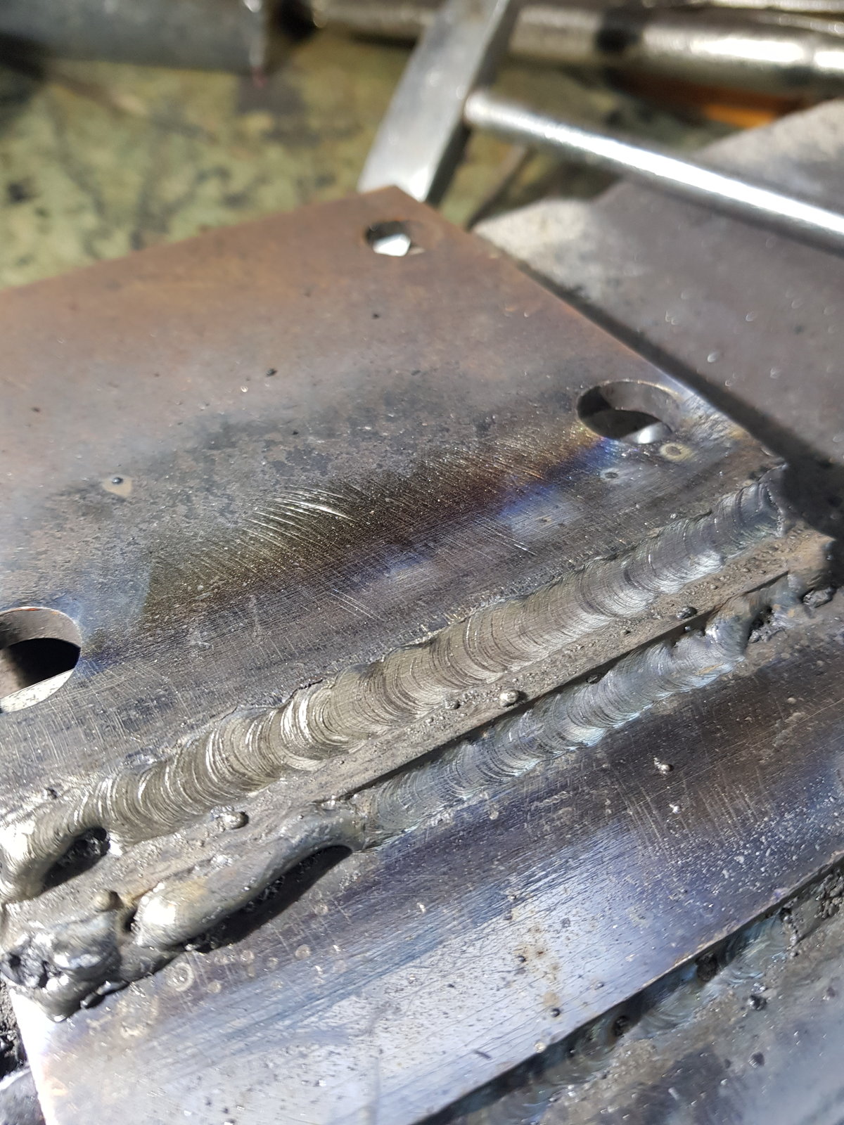

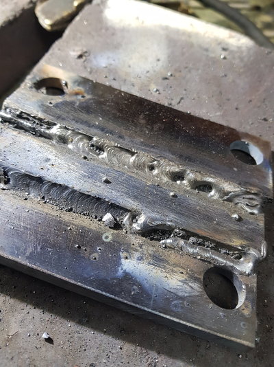

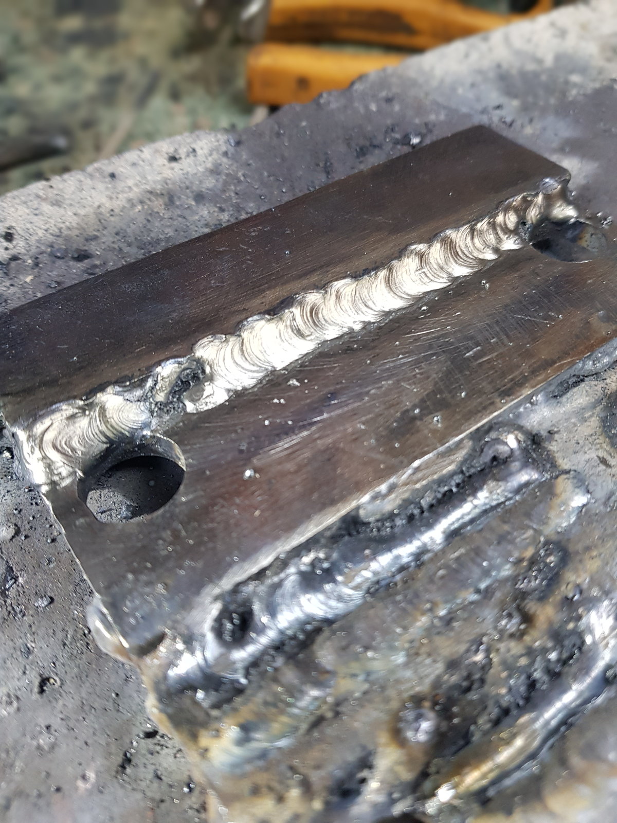

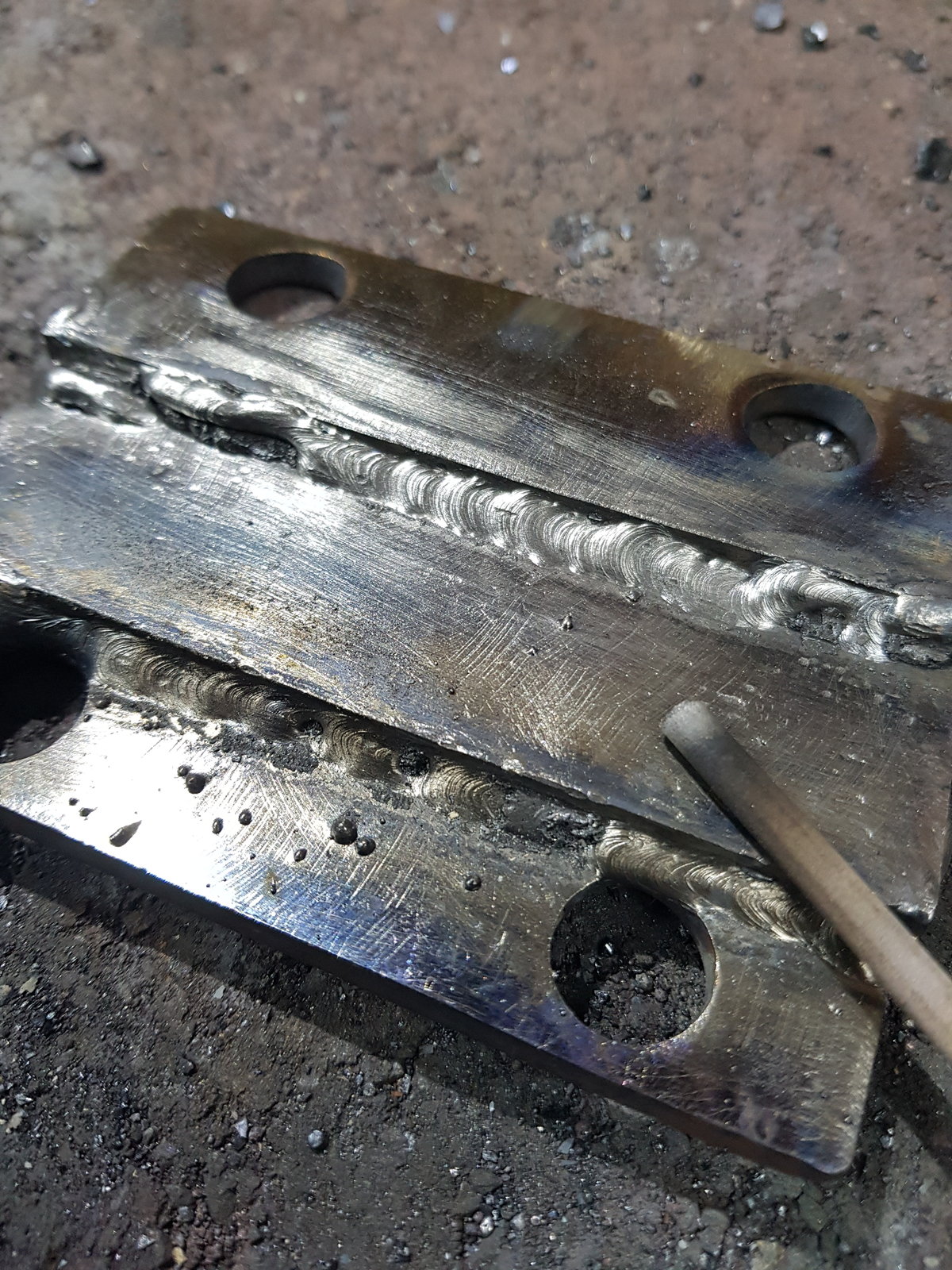

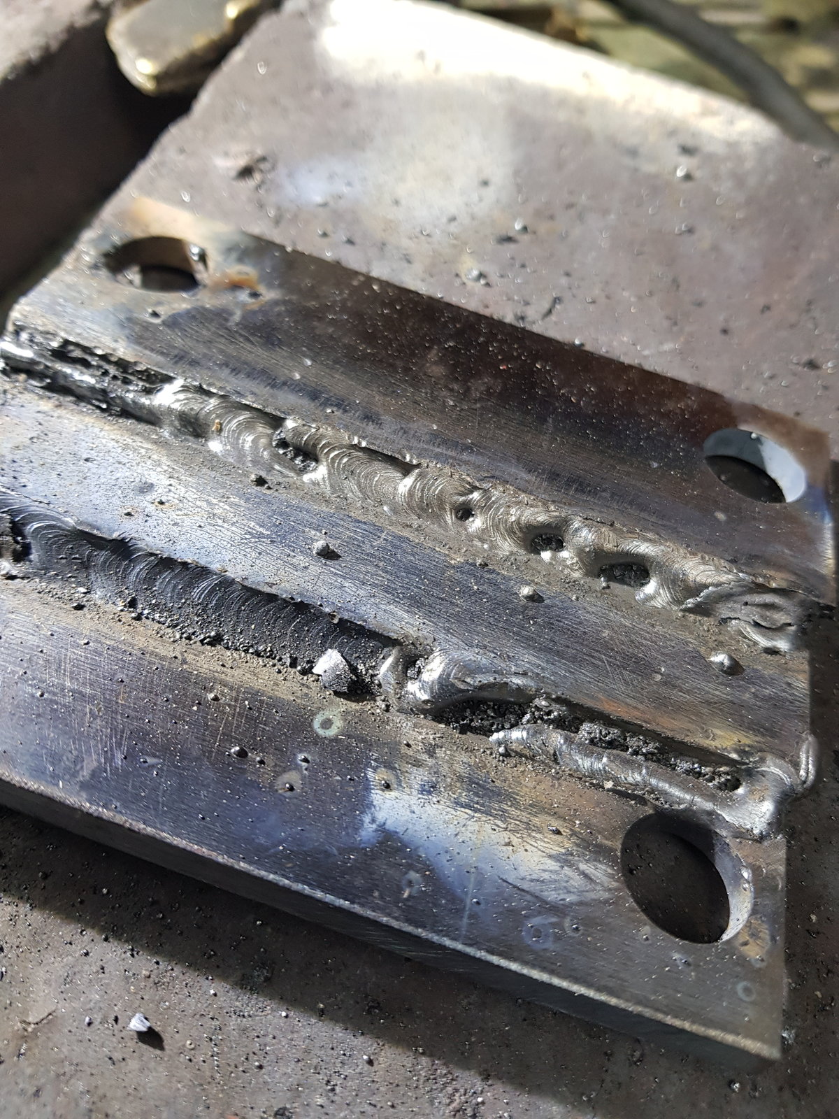

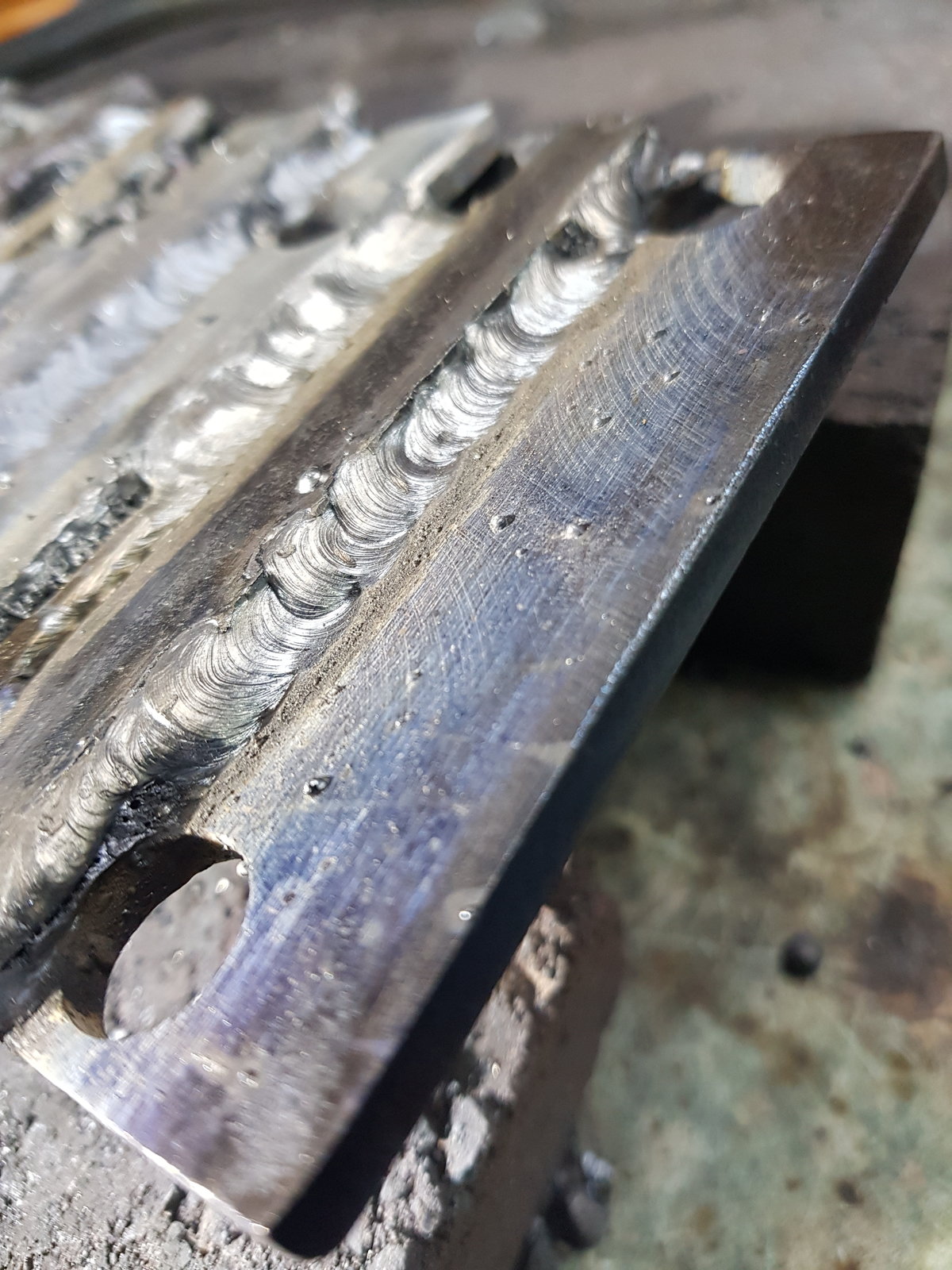

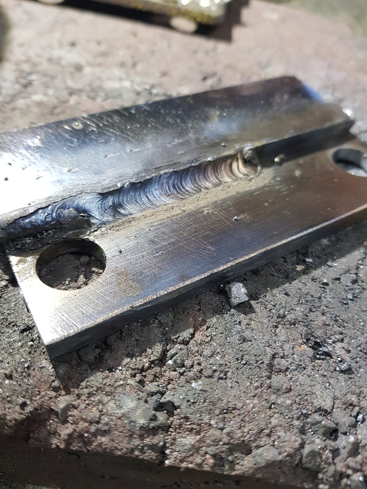

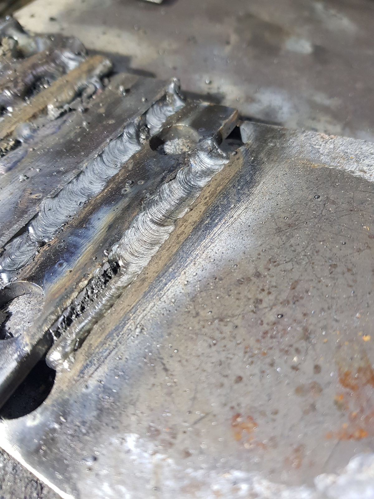

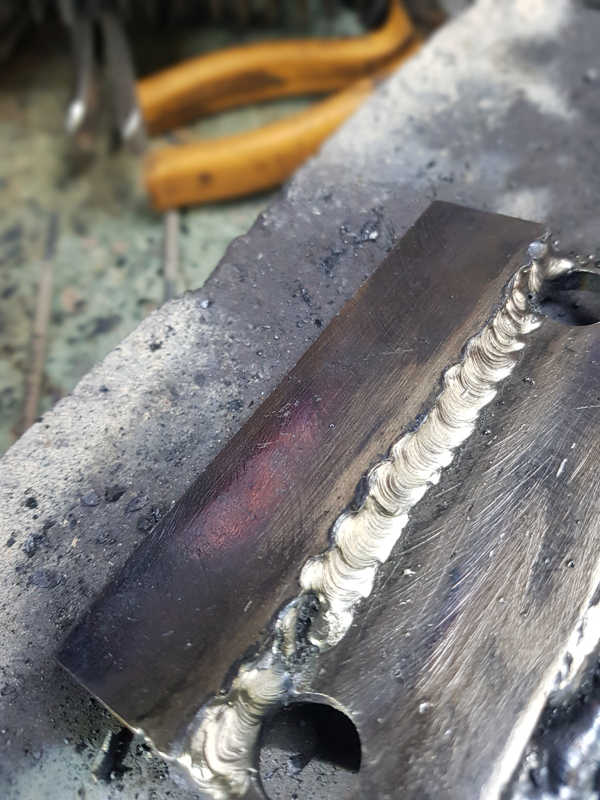

mate to these study thisSome more strait beads, very clean 3mm plate, 2.6 6013,even wiped off with acetone.
No change from yesterday's settings.
Beads ok,penetration ok and no porosity.
Thickness is 1mm under double thickness of material.
I cant see anything too much to worry about for a novice hobby welder on those.
and compare amps..
