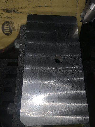

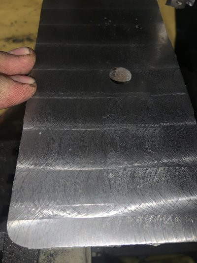

The main reason why wet coolant is avoided on cast iron is the nasty paste it can produce rusting into a solid and driving the fine dust into places where wear can be caused
Turn your speed down and use a vacuum cleaner to keep dust down
