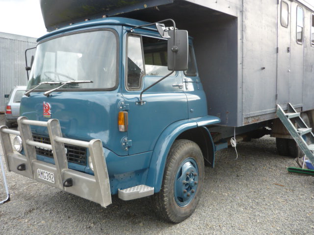

Had a minor setback which resulted in losing all the rear brake fluid over the brake linings - it turned out that the truck has been fitted with the wrong wheel cylinders as some point in its life, so the ones I bought were wrong also. The guys up at Amberley Truck and Auto got a part made up to solve the problem and we got the rear brakes relined at the same time.
Hopefully it should go for its COF (Certificate of Fitness) tomorrow.

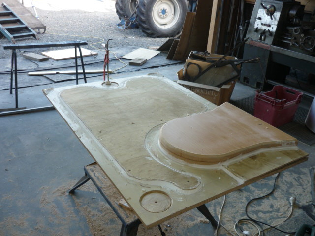

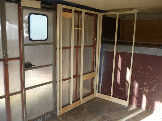

Meanwhile, not sure if anyone's interested in this stuff, I started making a shower/toilet cubicle
and a shower tray made from scrap timber which will be covered in fibreglass

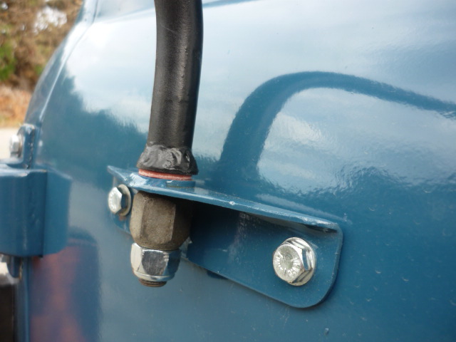

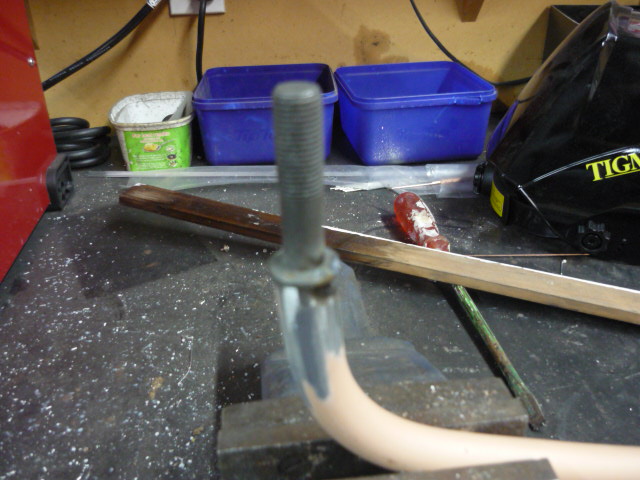

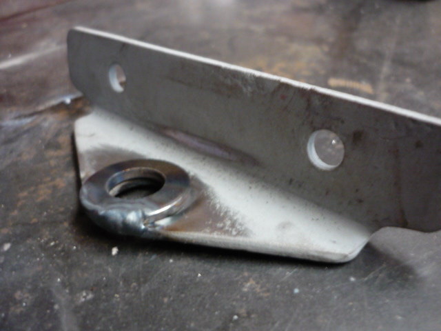

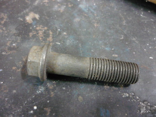

and a pair of Vauxhall Magnum con-rod bolts played their part too

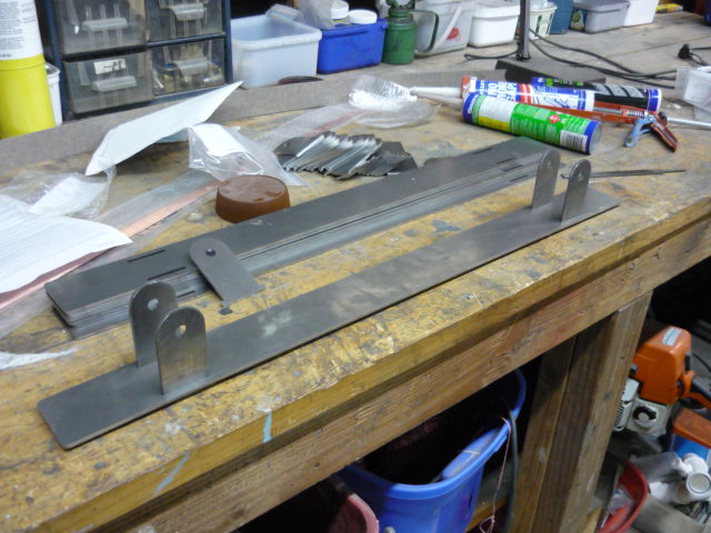

This together with some fibre washers makes a new friction hinge

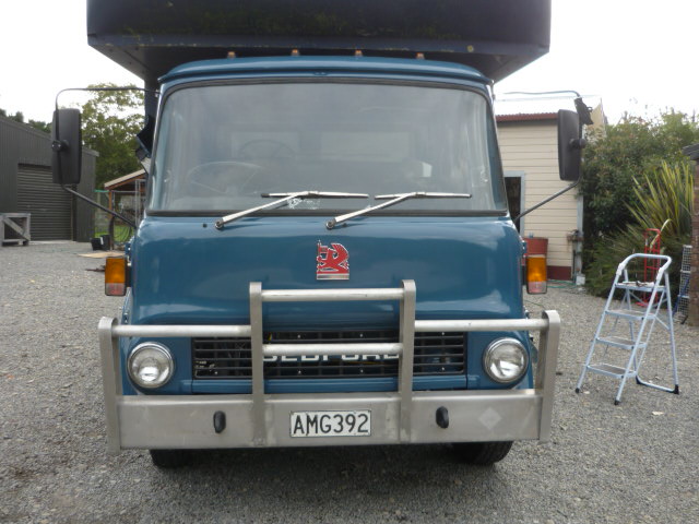

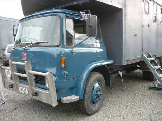

The idea is that the mirror will collapse if you hit something rather than damaging the cab.

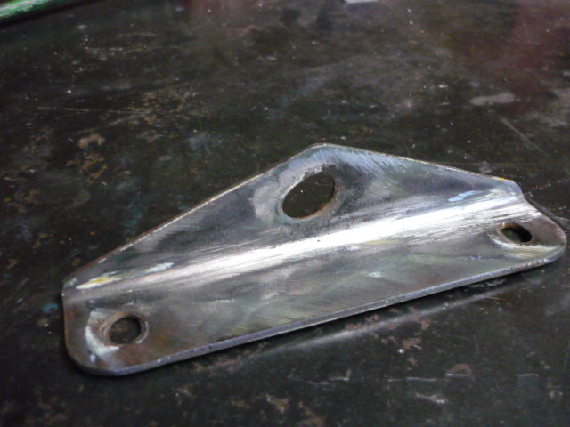

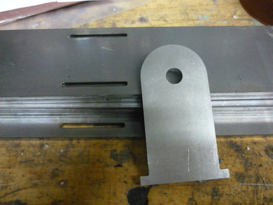

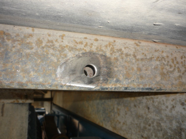

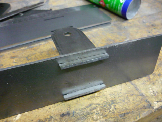

New mirrors look nice and the extra spotter mirror for the nearside is great but they are still much too wobbly to be useful. The brackets are wide, to see past the body and the brackets are very thin by modern truck standards.
Finally has its COF! The only thing I had forgotten was the driver's sun visor but luckily it was in the cab and the guys from AT&T fitted for me while the inspectors did the rest of the test.

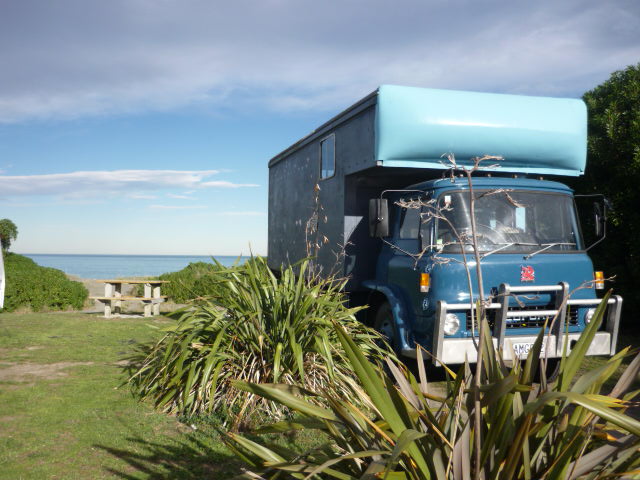

Went camping! Took the truck about two hours north to a campsite near Kaikoura - nice warm weather and a beachfront view. Some mountains to cross (The Hunderlees) but the truck went better on the hills than I remembered; perhaps all the weight we removed and not having horses in the back has something to do with it. A few minor things to sort out but a successful maiden voyage.
