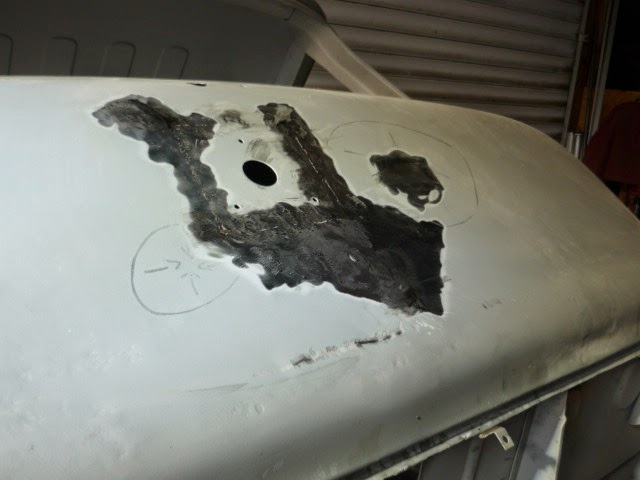

...lead! - where the original panel joint had been filled. It really doesn't weld very well but after a bit of heating and wiping and welding...

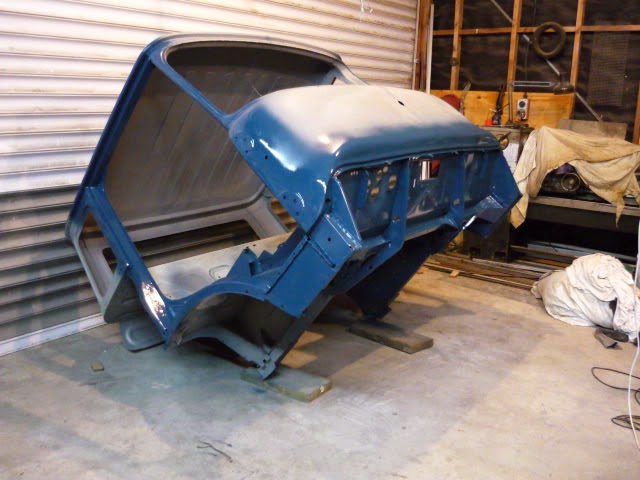

And finally it looks like this
