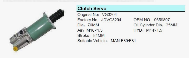

I bought a clutch servo on eBay
Brand new and only paid five quid so a bit of a bargain. The truck has power steering and air assisted brakes so it is quite light to drive except for the clutch which is very heavy. I am not sure why but I think that when the truck was converted to diesel the linkage was changed in some way. There should be (I think) a clutch relay linkage that gives some extra leverage to the pedal but that has been bypassed completely on my truck. An air clutch definitely makes a truck nicer to drive so I will have a go at fitting it once the cab is off.

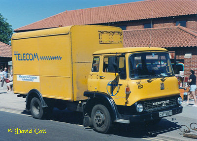

If I remember right Ford beat them to the tilt cab by a long way therefore picking up all the new customers, the D series was nicer to drive too.
The TL came later but if you ever drive a TL the steering lock was poor
