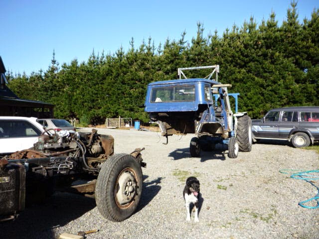

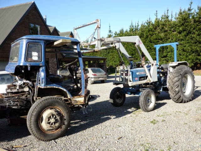

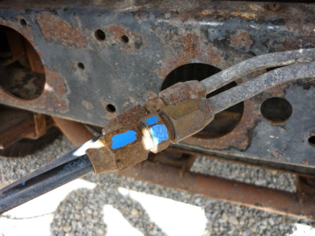

After being a bit slack for the last month or two (actually putting some extra lights and sockets into my workshop) I finally got the chassis parked up where it won't be too much in the way and took the old cab off. Summer is coming in this part of the world so it does not matter too much if it is all parked out for a few months.
It was a much quicker job than I expected, bring out the imperial spanners -
Remove pedals (2)
Unplug wiring loom
Disconnect steering column
Disconnect earth strap
Disconnect engine stop cable
Disconnect throttle linkage
Disconnect radiator filler hose
Disconnect air filter and breathers (2)
Remove gear lever
Disconnect handbrake pipes (2)
Disconnect emergency brake valve pipes (2)
Disconnect speedo cable
Disconnect pipes to brake pressure gauges (2)
Remove alternator regulator
Remove cab bolts (4)
With no windscreen fitted all you need is some forks on the front-end loader and a plank...

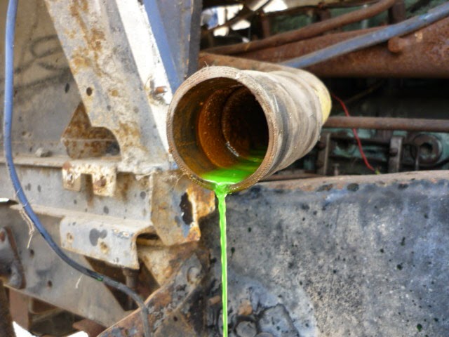

The coolant came out clean as a whistle which is encouraging considering how many years it's been in there!
I marked some pipes with paint and took plenty of photos.

I took to using a bit of angle iron and scribed alignment marks for some six inches back and across the unions on the pipes at junctions & unions as it's not much fun having removed 10 or so pipes to get at things and finding that pipes 9 & 10 on the refit will never ever align , even if everything is hanging slack in nuts , unions & mounting brackets / clips .
Thanks Dapph I'll do that. Can you explain your marking scheme with the angle iron a bit further please; I'm a devil for taking things apart thinking that I will remember how they went and then later when it comes to reassembly...

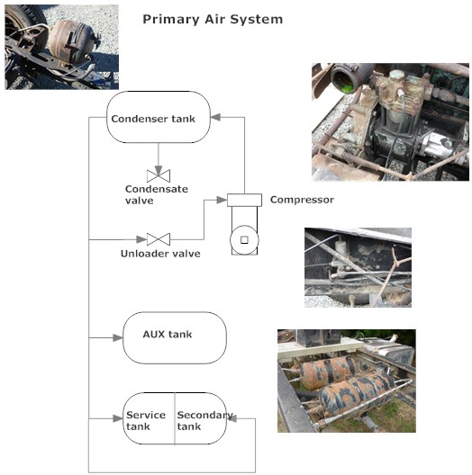

I have tried several times to draw a diagram for the air system but even on a simple old truck it is bloody complicated! Down the side of the engine along the chassis is just a mass of oily pipes and valves. It's almost impossible to track them through.

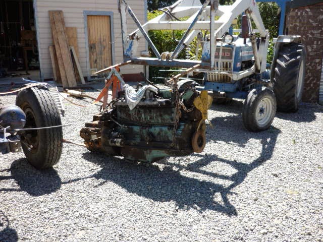

The front area of the chassis is a bit rustier than I though so I'm thinking of lifting the engine out and blasting/painting the chassis
Cut a three inch lump out the middle of a 9 inch length of 1" or so angle on both sides of the angle leaving a 1/4 thick web down the middle to make a bridge over the union /joint so the angle iron will lay on the pipe on at least one side . Lay the angle along the pipes , hold it tight to the pipework and scribe the alignment lines along the edge that is in full contact.
With the engine & gear box out everything is a doddle to do .
Putting cable ties on pipes say red blues whites & yellows in singles twos etc and combinations , perhaps even attaching bits of white plastic with the joint number deeply scratched in also helps then making photos from above will also be useful .

Had no idea that it would be so heavy. It is right on the limit of what the front end loader will lift. I will certainly need some help getting it back in again but there is a local chap with a hiab on a small truck so I may ask for his help.
The only casualties were the small unloader plastic hose to the compressor and the two front engine mounts that just fell apart.
Got straight to it and pressure washed all the chassis and pipework that was inaccessible with the engine in place. It is much improved just with a cold water blast but I may try and hire a steam cleaner, as Dapph suggests above, to give it a final clean once it is stripped.
Putting it back , set the forks high to reduce the leverage force them. Prop the forks at just infront of the rams with strapped / roped up timber and use a chain hoist hung via astrong chain from the back bar of the tines not the tines . It is a lot safer than a HIAB that may or may not creep plus you have a lot more control over things .
When it's high enough to clear things roll the chassis forward to insertion point and wedge chock all the wheels then lower the chain hoist .

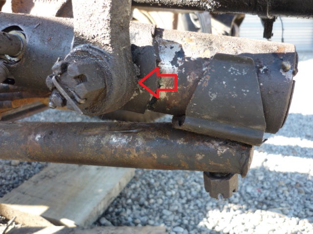

Taking the solid steel bar track rod off a 1953/4 Bedford RL GS cargo truck ..
For the vast majority of my military life I worked out side and usually alone in some isolated place .
One day I laid under the truck with my feet out the front . Undid the split pins, took them out , slackened of each ball joint nut 1/2 a turn and used a cut down 7 pound sledgehammer to belt the end of the steering arm eye so the shock went up the arm & shook the ball joint free. Clunk the right side came free , rolled to my left wallop ...Clunk! ,that came free too.
Put the sledge to my right out the way ,laid on my back and started to lift the track rod out.
Bugger it , it had stuck in the right side eye , the left side was free and it smacked me on the nose then swung up over my head , because I was laid on cobbles in a strong denim coverall the seam of the left shoulder acted like a fulcrum point . Crunch ! like someone cutting a big hard dutch cabbage with a big knife .
Nine years as a mechanic had made my hands curled , I couldn't straighten my fingers to let the sodding bar go nor bend my wrist enough for it to fall free.
Result ... it tore my left shoulder joint apart, my arm & shoulder blade ended up under my cervical spine, I was still passed out several hours later when someone found me.
It crippled me for the rest of my life I was only 27.
After the military health & safety inquiry, all units in our theatre of war got issued with a real dandy hydraulic ball joint splitter set and a set of four split forked ball joint splitting chisels .
Do take care on undoing any ball joint , if at all possible.... if you have to use the hammer method try and ensure that you are stood up or vertical when doing it . Remove the road wheels if necessary , sometimes even think of slipping a 3 tonne trolly jack close in on the track rod by the ball joint to put a little pressure on a ball joint o the shock loose method has the best chance of working.

I've been tracing all the pipework and attempting to understand how it all works so by way of a first instalment, here is my understanding of the primary air system
